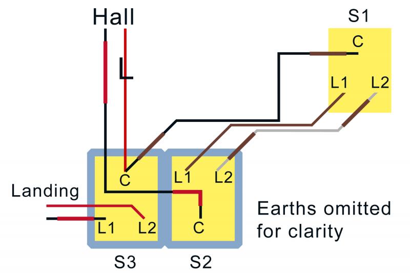

Added a new two way switch for hall by front door (S1). S2/S3 is existing two gang switch in hall by lounge.
A comment was made by my sparky oppo along the lines of "not sure if you got that right or not".
So I've spent a few days while the builders are in trying to figure out any other way to do it. My head now hurts!! :eek:
So I thought I'd do a purdy piccy and throw it out to you lot!!

It looks like you have assumed the conductor in the C is a permanent live.
Is it really?
Also, where is the neutral coming from for both the landing and the hall lights?
Is it really?
Yes, on the downstairs lighting ring.
Naughty peeps borrowed the neutral for the landing from the upstairs ring, although I know that was a common(ish) method a few years back.

Your wiring diagram will work fine and won't make things any more hazardous than they already are.
Just make sure you turn off both lighting circuits before doing any work on either of them until that borrowed neutral is fixed.

have you connected it up then ?
can't see it doing what you want.
maybe a diagram of how it is before you started would help.
There would have been a link between the switches, which you have missed
Yes, works as expected.
can't see it doing what you want.....
.....There would have been a link between the switches, which you have missed
There was a bridge (link) between the C-S2 & C-S3. That has been removed or "extended", if you like, to C-S1.
I'll badger the gaffer to separate the borrowed Rn and when he's not looking hope to sneak some 3c+e from the downstairs up the conduit.
