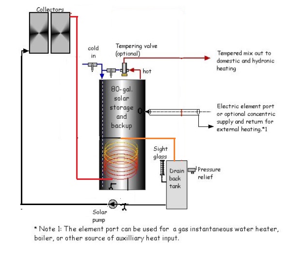

Just one thing I fail to understand: In a drainback system, when the pump is off (so there is no fluid in the collector), how does the temperature sensor at the collector measure that the collector temperature is high enough above the tank temperature if the collector is empty of fluid? Surely it could only measure the temperature of an empty pipe / collector housing and not the water that would be heated by it?
Looking at http://www.solarconsultants.com/library/DrainbackRheemGL-30Man.pdf

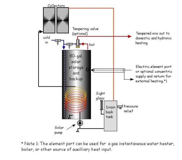

It seems strange to put the hot water from the panel into the drain back tank before it gets to heat the water in the storage cylinder.
This method of putting the solar heated fluid directly to heat the cylinder and then into the drain back tank would seem more efficient.
Or is the drain back tank more than just a tank.
