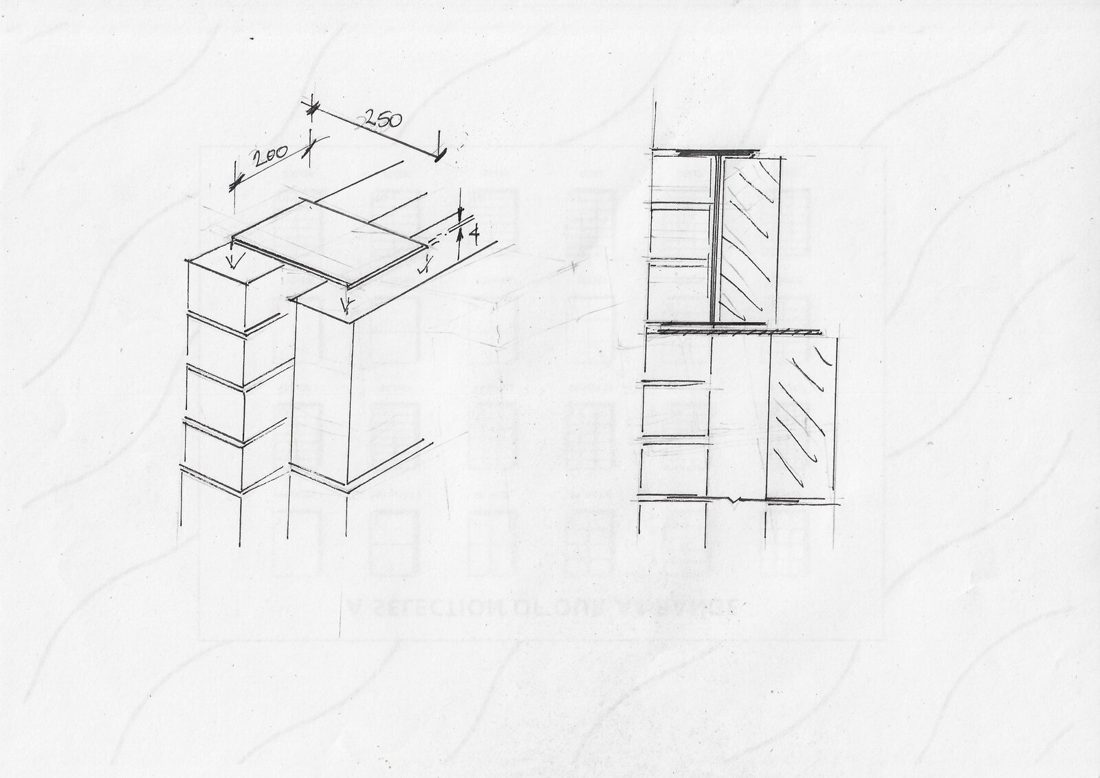

Bridge the cavity with a piece of steel plate 200 x 250 wide x 4mm thick.

The scheme your SE has put forward cannot be faulted insofar as it is a 'correct', text-book case of how to solve the problem; will it work? - yes, most certainly, but at what cost?
The metal plate suggestion would work in principle, subject to a suitable thickness, but you could bet the farm that the inspector will not accept it without justification. The problem is therefore one of proof, which would be very difficult.
The issue is the potential slight upward bend in the plate where it passes over the corner of the inner skin, which is difficult to evaluate, and which will put increased localized stress on the corner of the block. There are equations for evaluating the curvature in cases like this, but they are complex and most SEs would have better things to do with their time!

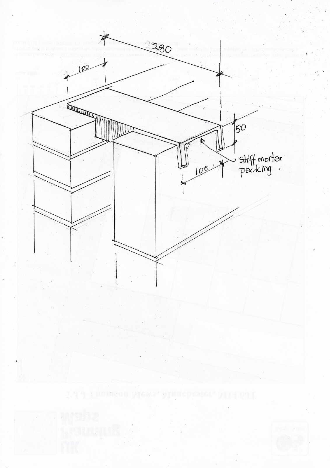

Stop press: thinking around this problem, a short length of steel channel (100mm x 50mm cross-section) might be better. Cut away the two flanges at one end to leave just the web bearing on the outer skin, and with a disc cutter saw two slots in the top of the inner skin block, 50mm deep x 8-10mm wide.
Set the channel down on some stiff mortar; this can then act as a steel padstone. There will be some cold bridging which will have to be addressed, and your SE would need to calculate the bearing stress on the inner skin, taking into account the contact area (he will know the loading at the end of the beam so it's a simple computation). If the figures work, it will satisfy building control's checking engineer (the inspector won't check it himself - he'll pass it over to their SE to check).
Worth considering?

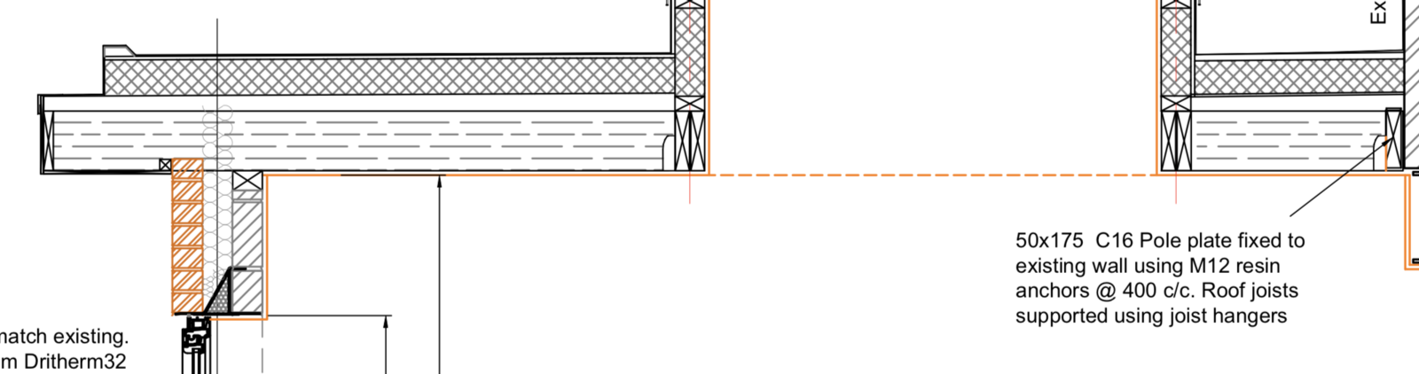

Attached in the original drawing with the cavity lintel, i believe a K90.... NB there is only 4 courses of face brick above the lintel in the final drawing as there was a height issues (eves had to be 3.0m for PD, but it was done to the lower eve height, not the roof face) I really can't see how either wouldn't be ok.. a 4mm 316 stainless plate bridging the cavity is such a neat solution, the other, also a great solution, and that wouldn't budge..... ... I now need to find an engineer to do me a calc so I can wave it at BCO.... I could stand the Eiffel tower on top of this extension even with a solid wall catnic lintel!

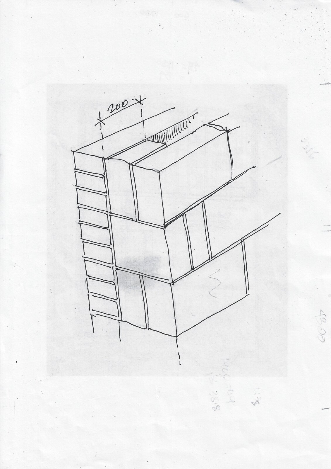

In your particular case of supporting the beam across the cavity, I would think that the easiest and cheapest way would be to build a solid return up to the inner face of the outer skin.
Obviously, this would fall below the required U-value for walls - but - you are allowed to trade off areas of walls or roofs which are slightly below standard, by incorporating additional insulation elsewhere in the extension (it's known as the 'area-weighted U-value method' and is described in Part L).
