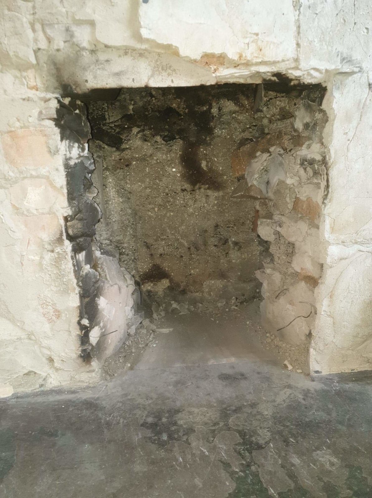

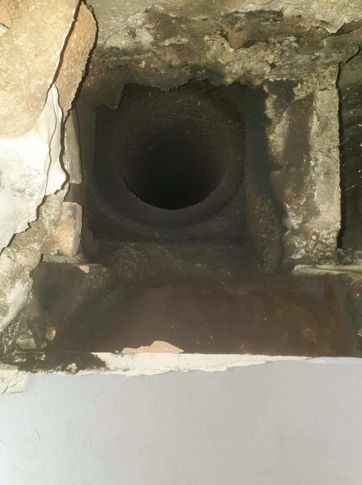

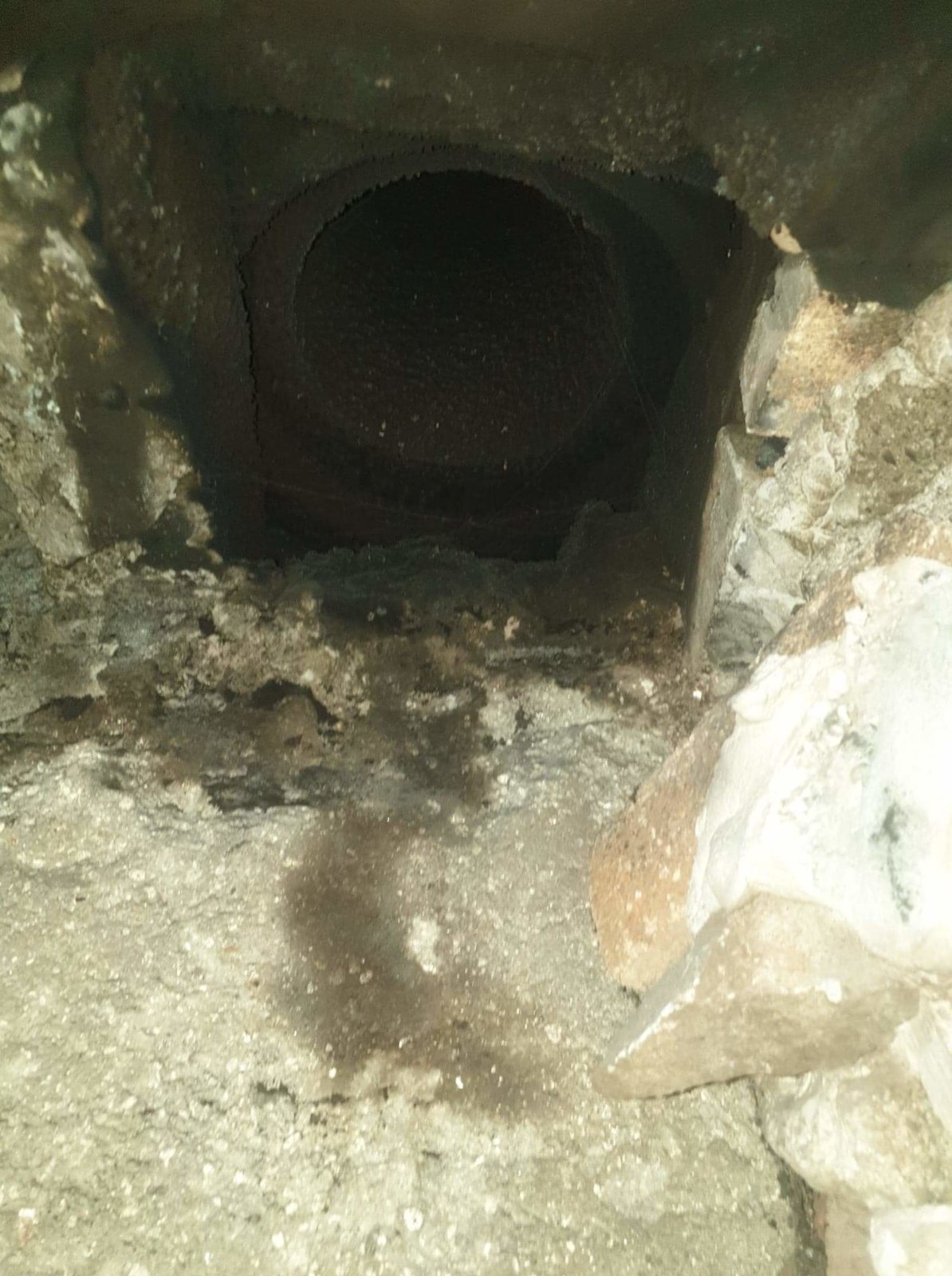

Hi, we're currently trying to open up our fire place to fit a log burner, we have picked it back to the blocks. The chimney has a pot lining which is very low, with also a very low lintel. We understand that a lintel will have to be installed higher up but how do we open this up without the the lining falling? I have attached photos to try and help. Thanks

Then go to the height installation dimension and allowing for a lintel go 2 or 3 courses above the install height.
Then open up to insert an Acrow Strong Boy centred over the opening.
Assuming the flue lining stays in place then remove the lower bricks and slice the flue liner with an angle grinder.
(you could prop the liner with a few lengths of say 2 x 2 or 4 x 2)
then install the lintel.
Where exactly you slice the liner will depend on where and how you connect from your appliance to the pot flue liner.
Its typical to drop a flex SS liner down the flue?
A Register Plate will often have to be used.
Sorry for long delay in reply! Still not carried on with any work, been in contact with local builders to do it but the one's who have got back seem to have extremely high prices! (around £1000 to open) So looking at doing it ourselves again! Would the clay liner need to be supported with steel rods before inserting a new lintel and removing blocks? Or should it be self-supporting?
bobasd (aka Vinn and ree) has gone. Most clay llners are self supporting being surrounded with mortar. Careful with that central block- that might come loose when doing the lintel.
