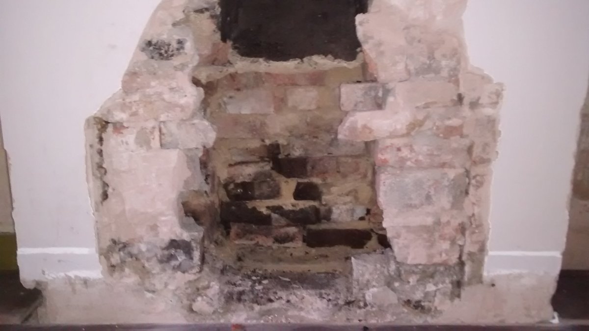

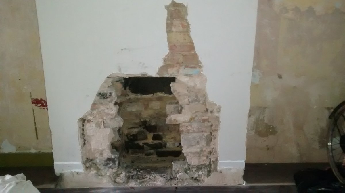

Hi all. I need some advice on guidance on opening up a chimney breast. I want to end with a builders opening and plaster it up to either use for a wood burner or to store logs.
I have started chipping aware at the plaster and removed some bricks. I am worried about how far to the sides the irregular bricks go, and about the lack of an arch or full lintel. There is a small steel lintel spanning the few centre bricks, but the opening it covers seems to be too small to be the builder opening, and it sits on irregular bricks.
What I want to know is:
1) Am I safe to remove bricks all the way to the last 20cm where I am expecting to see regular bricks.
2) Is a 100mm x 65mm concrete lintel sufficient?
3) Do I need two of these (i.e. does the front need to be two courses deep) or is one sufficient?
4) Is half a brick on each side (100mm) sufficient for the lintel to rest on (I am going to pack under with steel or slate and nhl3.5 lime mortar?
5) Do I need to support this sort of width opening with acros or am I good to just knock the bricks out and insert the lintel?
6) Am I likely to find any asbestos or similar thing that I need to be worried about (would they have used it in any of the cement)?
I have attached some photos in case that helps.
Thanks in advance.

Gently hack off the plaster to give a clear view of the original opening and the, is it a steel lintel(?) and post another photo.

Regarding the current lintel, it is a thin steel one. You can sort of see it directly above the sooty bit in the zoomed out photo. It starts half way from under that blue brick on the right and goes the same distance to the left, so it looks like it is sitting on infill rather than original brick work.
I'll have a go at removing more plaster, but it is extremely hard work, and almost impossible without damaging the bricks. They seem to have been cement rendered. I have tried both chisel and hammer and an sds. Any ideas what is the best method?
How far up and to the sides should I go? You can see the line of what I think is the original brickwork in the photos. Is it safe for me to open up to that point?

You would have no structural problems removing the infill to the original opening, and taking out the lintel - but you would be guessing the dimensions.

Your lintels seem fit for purpose.
How high do you intend to go?
I still haven't decided what is best visually. Any thoughts? I am leaning towards keeping it square. So I guess that would mean removing 2-3 courses of brick above the current steel lintel. This would mean 80-85 cms high and wide I believe (need to find the tape measure).
You say my "lintels" are fit for purpose. Do you mean that I should use two lintels, one in front of the other, in order to supported two thicknesses of brick in the front? Or is the single lintel sufficient?
Thanks.
Two lintels for two skins of brick or one lintel thats wide enough to carry both skins.
