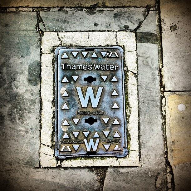

In connection with the requirement to replace some supply side plumbing, it will be necessary to shut off main stopcock (outside).
Thames Water indicate that it is the property owners responsibility to open/close the stopcock.
Stupid question perhaps but does the sort of cover as in the image lock on, or does it simply lift using a couple of prybars?
Asking because there are two key holes, had a quick go with one prybar and nothing moved although that may also be because the covers fit rather well in the frame/surround, and any gap fills up with dirt.
Thanks as usual.
No they dont lock its just stuck with dirt, give it a good whack around all the edges with a hammer then use the keys to lift it, if you have a pressure washer try that around the edges to get rid of the dirt that is causing it to stick

Usually the thin edge of a spade gets them free.....there will be a combination of rust and crap holding the thing down.

With that grouting, don't be surprised if the whole lid comes up :p
See the slots top and bottom....can you get a lever in those?

That's a stock photo, not "mine" although the cover is identical. "Mine" only sees a selection of beer lorries, delivery trucks, and every size and weight of HGV driving over it from around 6 a.m. till the late p.m. ... :cry:
Have tried a crowbar there but it's a bit thick so does not really grip the underside of the cover very well, the slots are deep. Anyway - will keep at it till I get run over!
Are you sure this is the right cover?
Is it the same as the one I need to open? Yes, 100%. Here in the West End they seem to all be like that, either saying "Meter" or just "Thames Water" I presume where there is no meter, just rates, as with "mine".
Single house stop cocks normally have smaller, flip up type lids.
There isn't a square yellow sign with a black H on it nearby is there?
That looks like a storm drain cover to me. What size is it ? As said (though i'm not familiar with the west end) stopcock cover is usually only 6"x4" ish with a hinged lid.
