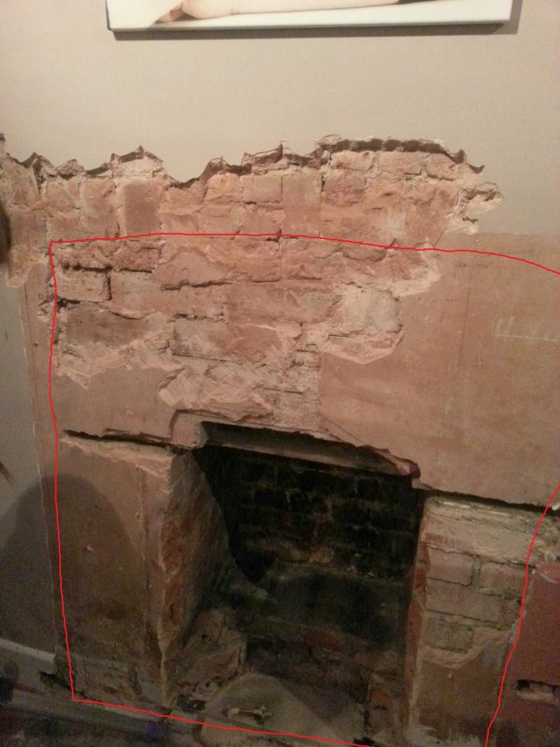

Hi Guys,
I think I can open up my fireplace to fit a log burning stove, I just don't want to knock out bricks and then find out I was wrong. I have done some exploration under the plaster and found a brick arch. Am I right in thinking i can remove the section below the arch as shown in this picture?

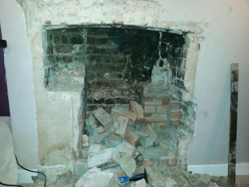

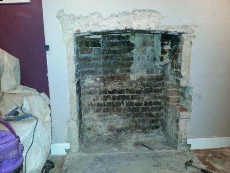

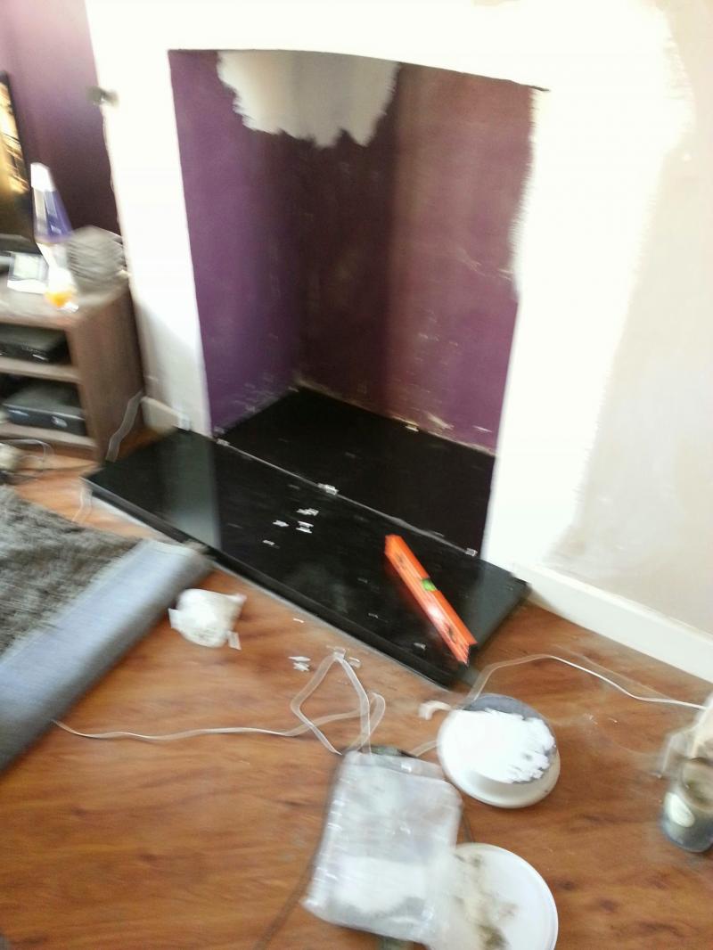

We have now opened up our fireplace and my original though was correct. we managed to open it up as per my last image.

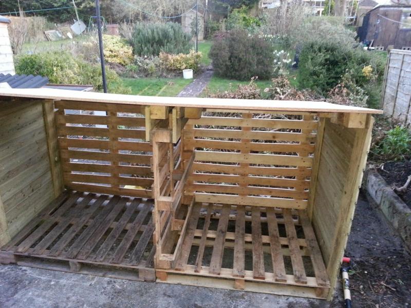

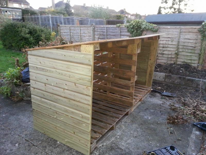

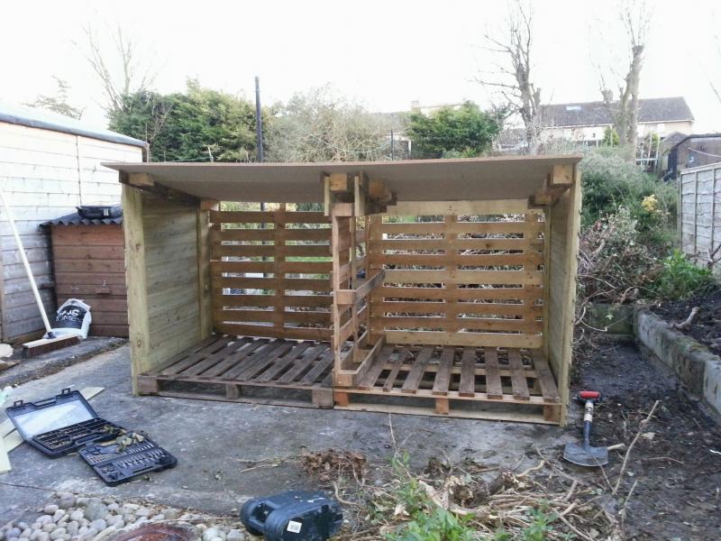

Also about 80% of the way there on making a home made log store.
This is costing a fraction of the price of the shop brought ones. Used some free pallets and a few bits of timber for a local supplier.

Looks like you are doing a lovely job of the opening. You are lucky to have a large void, it is more efficient as you get good air flow.
The opening you have made is brilliant.
How did you know it was safe to remove all the brickwork? I am thinking of doing something similar but can't afford to have the chimney breast collapse.
