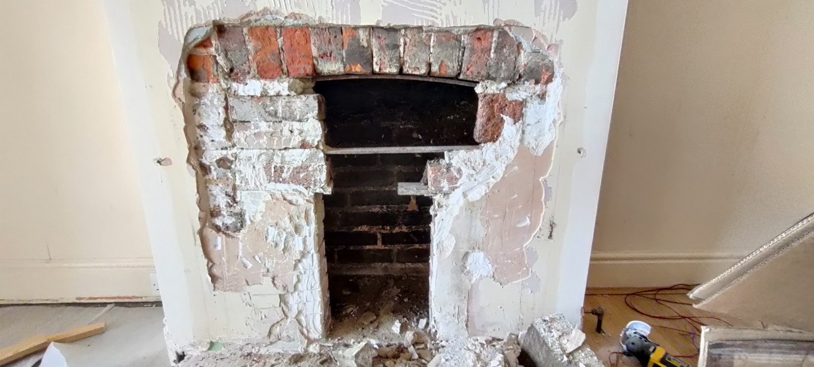

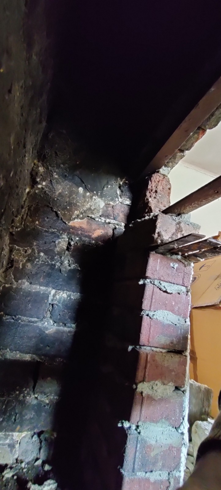

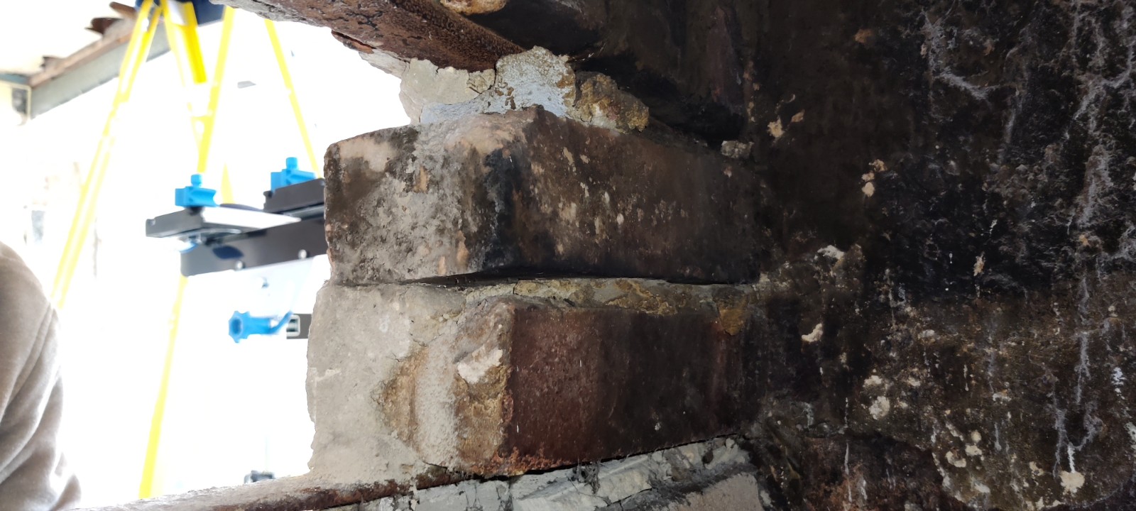

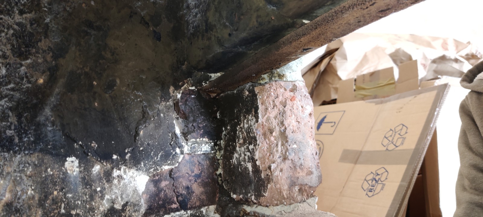

Hi all,
I am in process of opening up a fireplace and have already had 2 quotes from wood burner installers. I also asked their advice regarding the construction and after inspection both said it shouldn't be an issue, so I have proceeded so far and just seeking a bit more advice.
The images attached show the exposed soldier brick arch and the supporting curved top lintel, with a few smaller lower steel lintels exposed. There are some shots from inside the fireplace as well.
I have been slowly exposing the plaster to reveal the bricks beneath and the breeze block I removed just below the arch was actually quite loose.
My main concern now is the main lintel directly below the soldier brick arch, it is very firmly fixed and I have been careful when loosening anything around it. However, I am concerned that when I remove the outer bricks which have been fitted to fill the gap I may loosen the lintel.
How best to proceed in removing these bricks?
Thanks,
Ant
