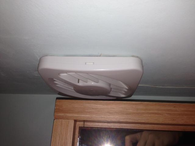

I have a question regarding the extractor fan in my bathroom. We are in a ground-floor flat, and the bathroom has an extractor fan situated on the external wall that activates when you turn the lightswitch on. There is a window in the bathroom. I've attached a number of photos to illustrate what I'm referring to.
When we have showers, the bathroom steams up immensely, causing mould spots to appear on the wall every few weeks (requiring a clean with bleach). The fan is always on when we have showers, and the top (smaller) window is open. When a shower is finished, and the bathroom is vacated, the main window is opened to allow the steam to escape faster.
The previous occupants had fitted a rather tall wall unit right infront of the extractor fan, which, to my untrained eye, seems rather silly, and, I assume, prevents proper extraction of the air from the room. The build-up of steam from a shower seems to confirm this for me. But, I have recently seen extractor fans that have a 'plate' mounted in front of the opening to the fan, which is basically much like the scenario with the wall unit being mounted a few centimetres in front of the extractor fan (eg http://www.extractorfanworld.co.uk/airflow-quiet-air-qt100b-129-p.asp ). This would suggest to me that a fan can perform fine even with something mounted closely in front of it. Is this true, and thus is the cabinet's position perfectly fine?
What are your thoughts? Is the unit too close to the extractor, and thus hindering it (hence the build-up of steam)? If not, why is there a build-up of steam? What more can we do to prevent this?

First consideration is air flow. The unit does appear to be obstructing the flow. If you are opening the window and the fan is operating then the air will flow window to fan. It won't flush the room and will cool the room causing more condensation. Is there sufficient gap/grill in the door to allow the fan to work properly? Test roughly by shutting door with fan running wait a few minutes then open door if fan note changes then it needs more air into room.
As for the fan itself; you could increase the size/capacity but, as above, it may not help. Useful in these circumstances is often an input fan although this may be difficult in a flat.

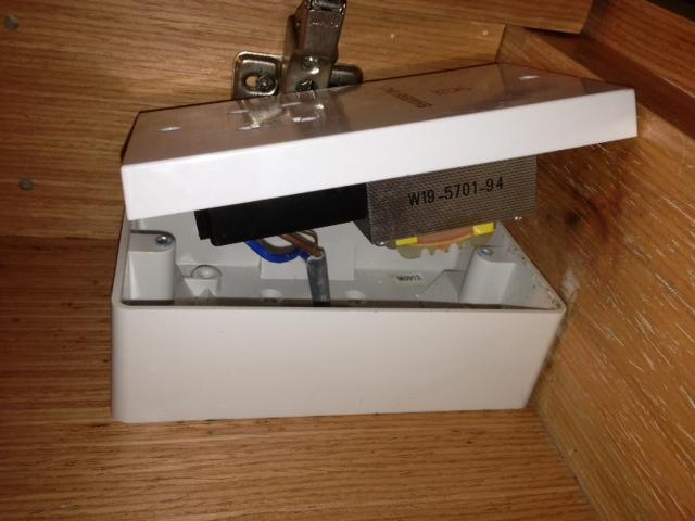

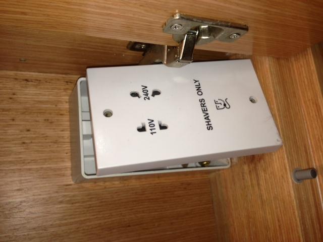

1) To gain access to the fan, I will need to remove the wall cabinet (and I might as well replace it with a smaller unit whilst I'm at it). But there is a wired shaving socket inside the unit - see pictures. What can I do about this? Is there some way of safely terminating the wire and tucking it back into the hole in the wall it is coming out of, so that I can mount a new cabinet over it? If so, are there instructions on how to do this somewhere on the net?

1) To gain access to the fan, I will need to remove the wall cabinet (and I might as well replace it with a smaller unit whilst I'm at it). But there is a wired shaving socket inside the unit - see pictures above. What can I do about this? Is there some way of safely terminating the wire and tucking it back into the hole in the wall it is coming out of, so that I can mount a new cabinet over it? If so, are there instructions on how to do this somewhere on the net?

1) The correct way to decommission wiring would be to disconnect it from source and remove it. This depends upon how it was wired in the first place. But the shaver supply may well be from the lighting circuit, if so, and if it has a permanent live connection, it could make an ideal supply for your new fan.

You could terminate the shaver socket wiring by taking the cable through the back of the new cabinet and either fitting a blanked box or just refitting the socket.

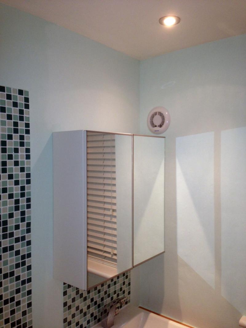

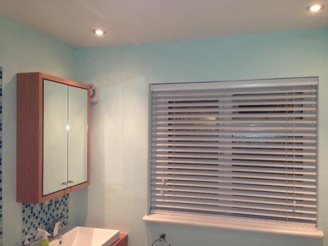

Many thanks for the informed replies, and apologies for my delay in replying (Christmas and the new year got in the way!).
To summarise, I did the following:
• Removed the wall cabinet
• Terminated the wire that previously went to the cabinet shaver socket
• Removed the Wickes pullcord extractor fan
• Filled in the fan mounting holes and tidied up the wall
• Stripped away any loose paint and then re-painted the wall with a 'stain protective' primer, followed by the colour coat (having added a mould-proof additive to the colour paint)
• Added a new circular Vent Axia 'Eclipse' extractor fan, with timer
• Added a new mirrored wall cabinet
The new shorter wall cabinet was purchased to specifically prevent the fan opening from being blocked, as it was with the height of the previous unit (see previous photos).
I had to revert to using the new extractor fan as purely an on/off fan controlled with the light-switch (I had been misinformed that there would likely be an additional live wire leading to my previous fan, which there wasn't). Adding an extra loop of wire when I connected everything up fixed that. Not ideal, but it works.
The new fan seems to extract a lot more efficiently than the previous. We now leave the door slightly ajar when showering to allow a throughput of air, which seems to work better. We still get moisture on the walls, but I believe it is less than previously (presumably due to a) the fan opening no longer being partially obscured, b) a more powerful fan, and c) having a throughput of air) and there is noticeably little steam when showering now. Additionally, I've not felt that any moist air is leaving the bathroom whilst the door is slightly ajar, which I was concerned about.
Finally, as I've unfortunately been unable to make the run-on timer in the new fan work, we have resorted to opening the window when leaving the bathroom after a shower, to help clear the air. I don't want to leave the bathroom lights on (and thus the fan) just to do this, so this is my solution. It's a bit nippy afterwards though, with this weather!
Thanks for all the advice and tips - I've put them to use!
