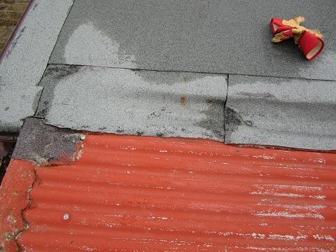

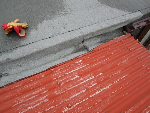

This edge is a bit tricky - the roof goes down to a wooden side panel (now covered with felt and then joins an adjacent corrugated roof (actually an old coal shed). They've just laid the felt over as you can see. Looks a bit rough.

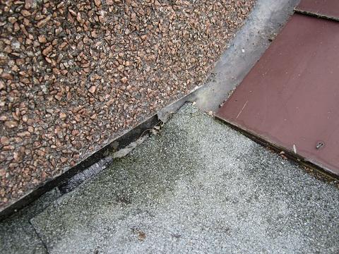

Here the felt's been laid over lead flashing where it meets the end wall and pitched roof.

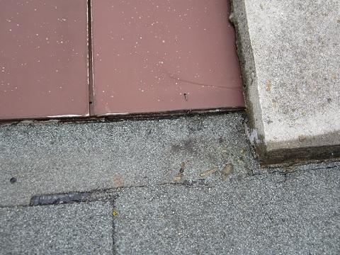

This show where the flat roof meets the pitched tile roof. They only laid the felt up to the edge of the tiles. Would it be more usual to rip out the bottom row of tiles and lay it under them?

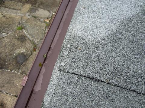

Finally they've used clouts to secure parts of the capping sheet. Is this right? I should add that this is extreme north Scotland so the weather is rather extreme. Even allowing for this, I thought the capping sheet was always just stuck down.

Others will comment on things they are more expert than me but the new felt should extend under the roof slates to give a minimum equivalent 150mm high upstand
Hmmm, seems shody. What would it have taken just to get a straight edge as-well. Takes an extra 5 mins if that. The main concern is the felt over the lead. It should definitely be under.
It needs ripping out and doing properly, no need for any clout nails, use torch on felt, and remove a couple of rows of tiles so the new felt goes under them.
