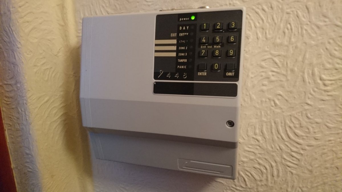

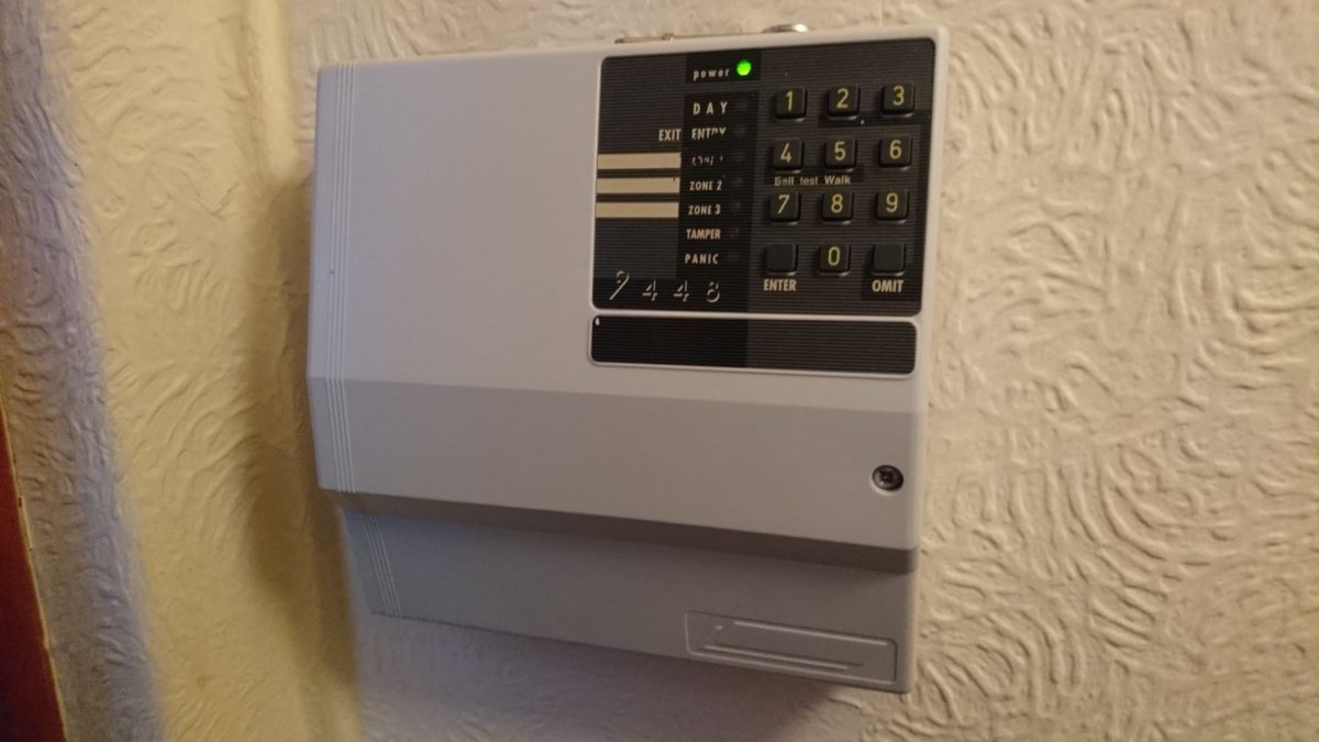

Having just moved into a property, and internet research discovered it is a 9448 Optima installed in the proeprty, no manual left and no code - how do i start using this- i have now downloaded the amnual and it asks for the 4 digits. I have no idea where the "zones" are. In fact i know nothing about it other than its a large box on the wall with a green light? any ideas ? or would i be better trying to find someone to come out?
It's either a Scantronic 9448 OR an optima ...they are two different alarm panels...try 1234 or 0123 ( default codes for both alarms )
Post picture of panel for further help
Does this help at all
Thank you x
That's a 9448
If you do not have the user code it will need to be factory defaulted
Is there a manual on how to do that or is it a specialist we need?
The manual I got downloaded just tells how to input new code etc .but need to know the original code 1st...which we obviously don't know
Thank you
You need a scantronic 9448 installation manual
It will tell you how to default panel back to1234
You will then need to reprogram panel
It is simple t reprogram
Your panel is a 9448 and NOT a 9448+
Open panel
Down power mains and battery
Short RSTpins with small screwdriver
While short in place power back up battery first,code now 1234
Now reprogram as required
