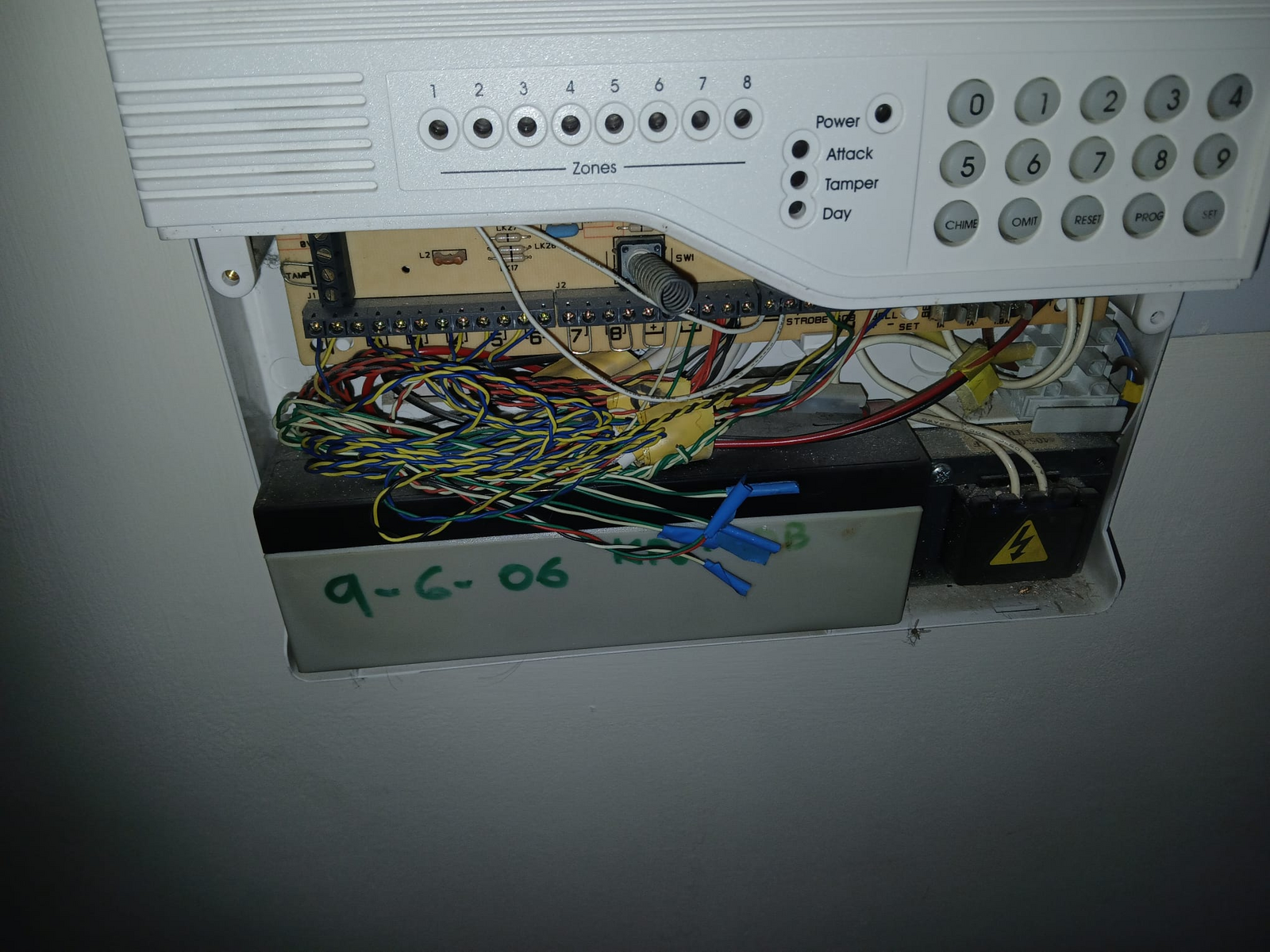

Hi All,
The transformer has reached its end of life in the panel for the security alarm system, It was put in 2006, when the estate was built. The electrician said its the transformer, i am struggling to find one as they are no longer made, is there any other transformers i can use?
Just match it up, eBay usually have a few have you tested the transformer yourself
What makes you think it’s the transformer ?
More than likely it’s due to the 18 year old battery fitted !
What state is the battery charging resistor located under the plastic keypad mount ?
I'm Honestly not sure what's wrong with it, its hard to remember but its had the power light off on the panel and alarms etc (although there is a live current going to the circuit that part is all okay) If i remember right their was a red light on the tamper light before it just fully turned all lights off i think that could be a service reminder? My electrician, who fitted it when we built the house said its the transformer but that he doesn't do alarms anymore (so it may not be) but if it was the battery, surely the panel would be working fine until the power was isolated? Do you think it is the battery?
I read something saying the battery could be so low its draining the mains power before it can go to the pannel?
What are the chances? Mainly the battery or do you think its the tranformer?
It’s not a guessing game …. Step by step …. Check ….mains input 240v AC …yes/no ….transformer output ….20v AC ….yes no ….ect ….
Again if the battery charging resistor is burnt out , what’s the point in fitting a replacement transformer as the panel is no good anyway !

"The transformer has gone no voltage on the output side." Is what my electrician has now said, Unfortunatly, im struggling to find the exact transformer do you know if any other will work (i dont want to replace the pannel if i dont need to- i would also change the batteries)
