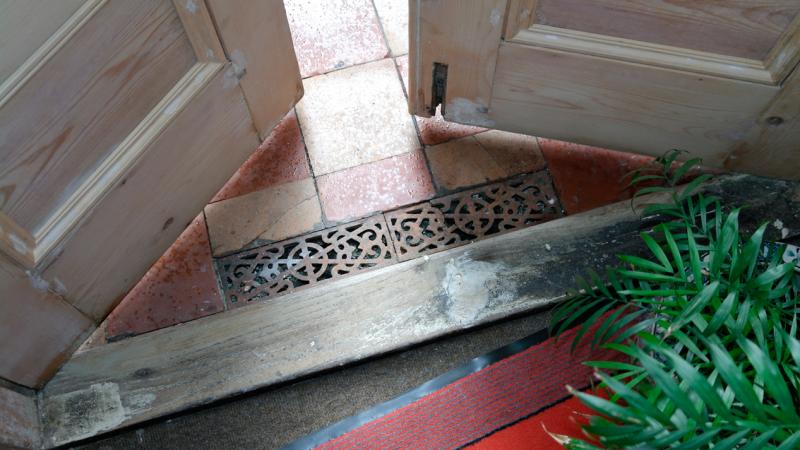

I have a pair of French Doors that I am in the process of refurbishing. Previously a lean-to existed over them thus partially protecting them.
I have removed the lean-to and now the doors are exposed to the elements, while we have no issues with drafts today because of the rain it seems it is starting to seep in a the bottom of the doors across the sill.
I was thinking of adding a water bar routed into the sill but the problem is that the doors open outwards.
I do not like the option of adding a weather bar across the front of them, so I am looking for suggestions/alternatives to the problem.

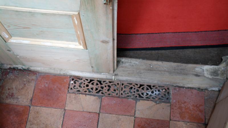

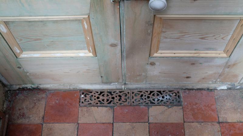

Took me a little time - here are the pictures as you requested.
I have ordered up some flush bolts which should in theory be arriving shortly to install in the top and bottom of the doors.
However the problem is still how to prevent the water ingress from the bottom.
Good photos. I would fit a timber upstand onto the cill bedded on mastic to form a rebate for the doors to close onto. This wont stop water coming under the doors but will stop it progressing to inside.

The upstand would basically be a length of 2x1 screwed down flat onto the existing cill so the doors shut against it thus creating a rebate and an 'upstand'.
Thanks, was thinking about that too but you just confirmed my theory. The only thing is that the water seems to run up to the bottom of the door and then seep into the bottom area.
So I can understand what you are suggesting to do, but how would this prevent the water seeping through.
You probably have, or should I say well have, water running down the door face and travelling under the bottom edge of the door. Its called surface tension. You need a weather bar fitted to the doors bottom rail which throws the water away from the front edge and causes it to drip off. Alternatively a drip groove machined in the enderside of the doors bottom rails will break the surface tension so the water drips of the wood, thus stopping it travel all the way to the inside edge of door.
Will try post scketches if I get time later.
Steve.
I would definitely fix an upstand on the inside of the door. Then ideally add a weather bar to the outside but if you do not want the weather bar put a drip groove under the bottom edge of the door.
