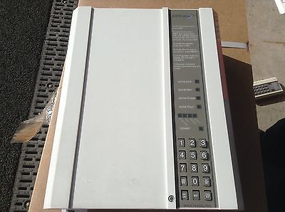

hi we have an old optima 2 plus alarm system which is I'm guessing 20 years old. It's wired with 5 P.i.r's and garage door contact, 2 panic button pushes and 1 extra keypad in the garage. its never been right since we moved in. Zones not working right internal battery dead, can't be set etc.

Forget repairing , if it's not been looked after the battery charging resistor is probably burnt out , cheapest option would probably be a Texecom veritas if you need an extra keypad , is it a onboard optima plus 2 or plain box ?
I'm not sure, it's the same as this one. (Google image) I think it's generally not happy as the siren and strobe don't work either (tried via the panic switch by the door.)

So it's an onboard , re using the existing wiring is your best and cheapest option ,panel wise it's up to you the prices go up depending on what panel you want , basic, midrange ,hybrid , all singing
