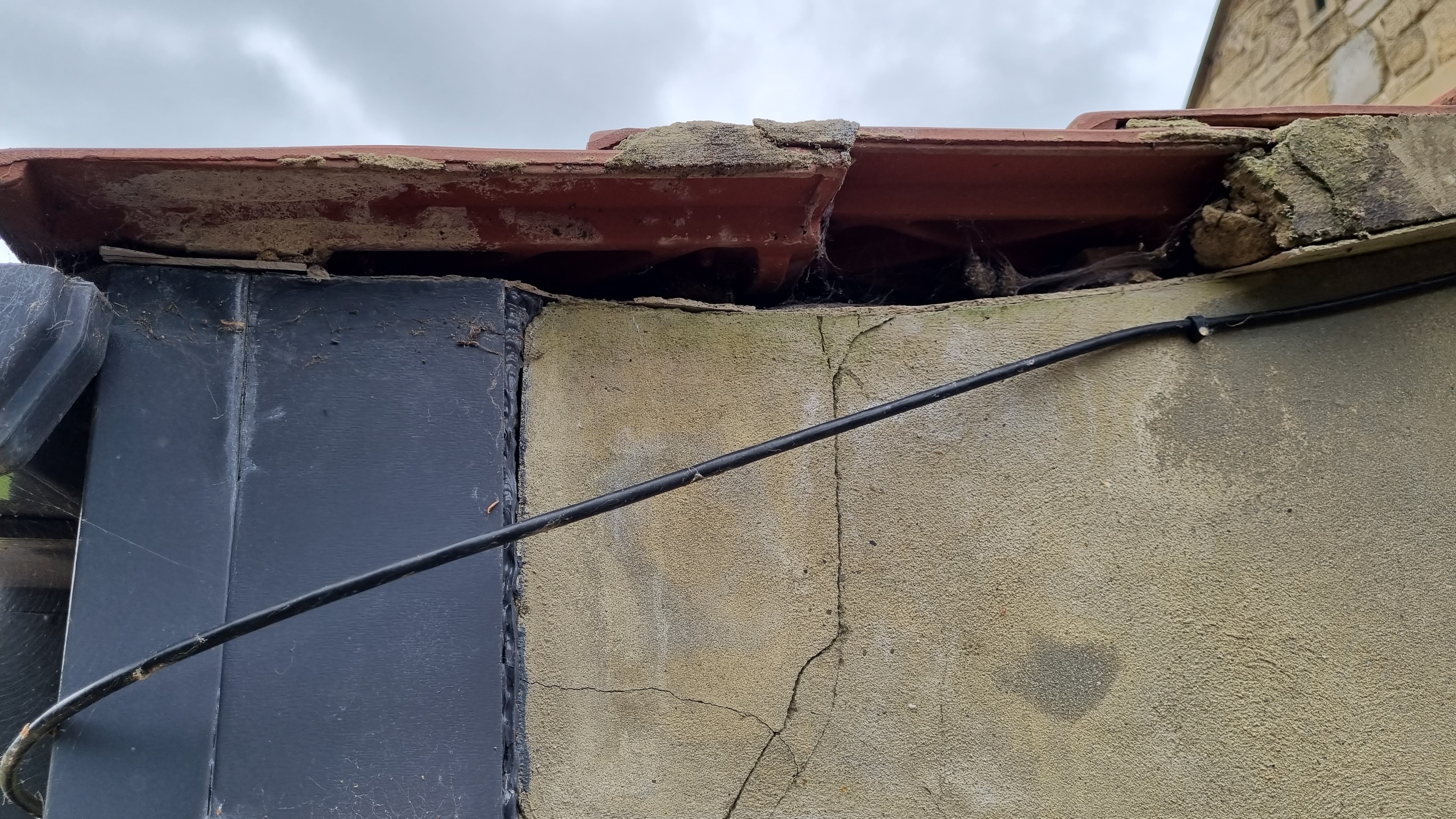

I found a chunk of mortar had dropped out of part of our extension roof verge, which was built about 9 years ago, so doesn't seem to have lasted very long! On inspection, some of the mortar near to the damaged area is also very loose, so will need fixing, but further up the roof the mortar feels solid.

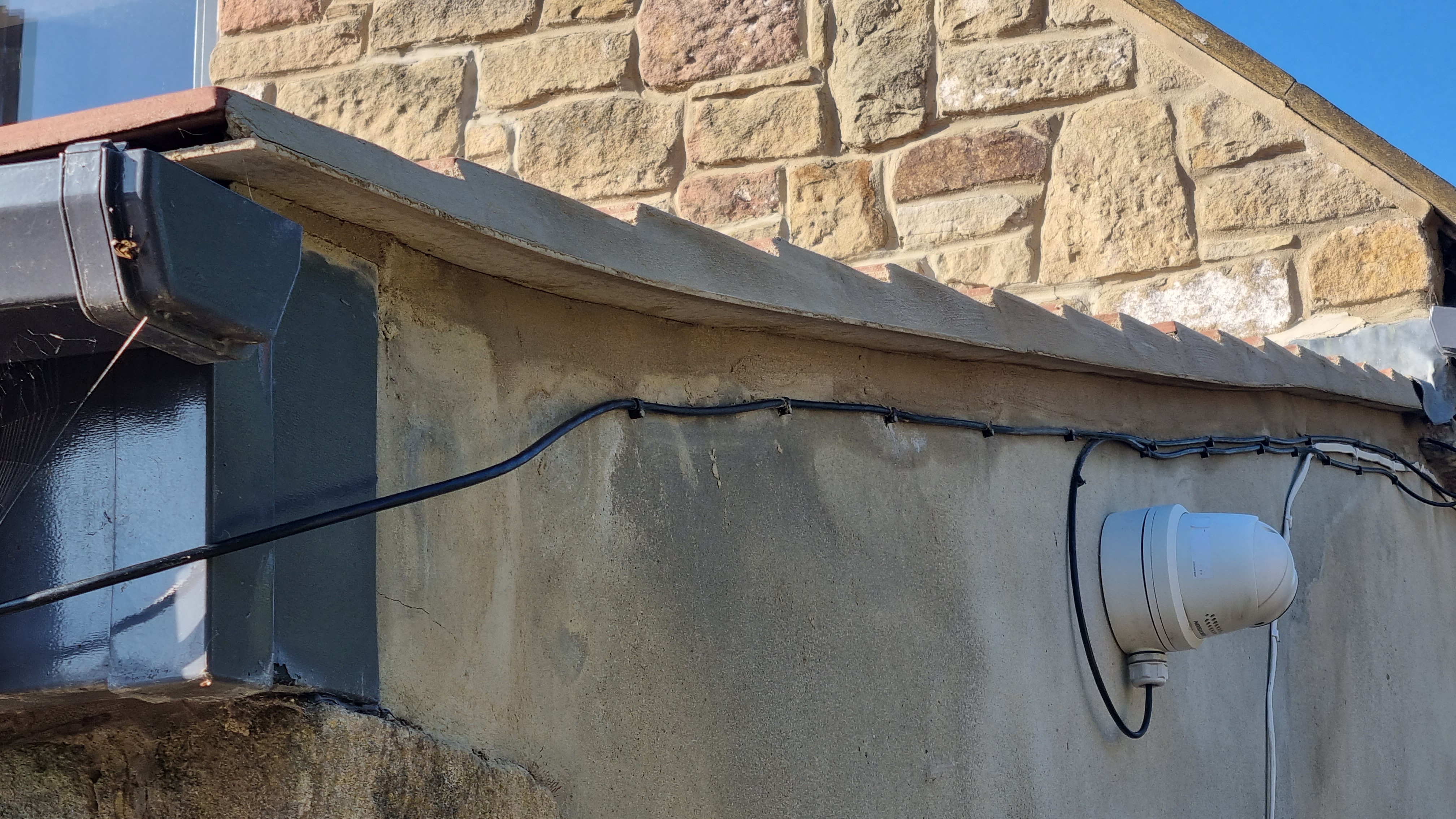

The verge pointing never seemed particularly tidy, so I'm thinking about taking this opportunity to replace the verge on both sides of the extension roof with a dry verge. Here's what each side looks like:

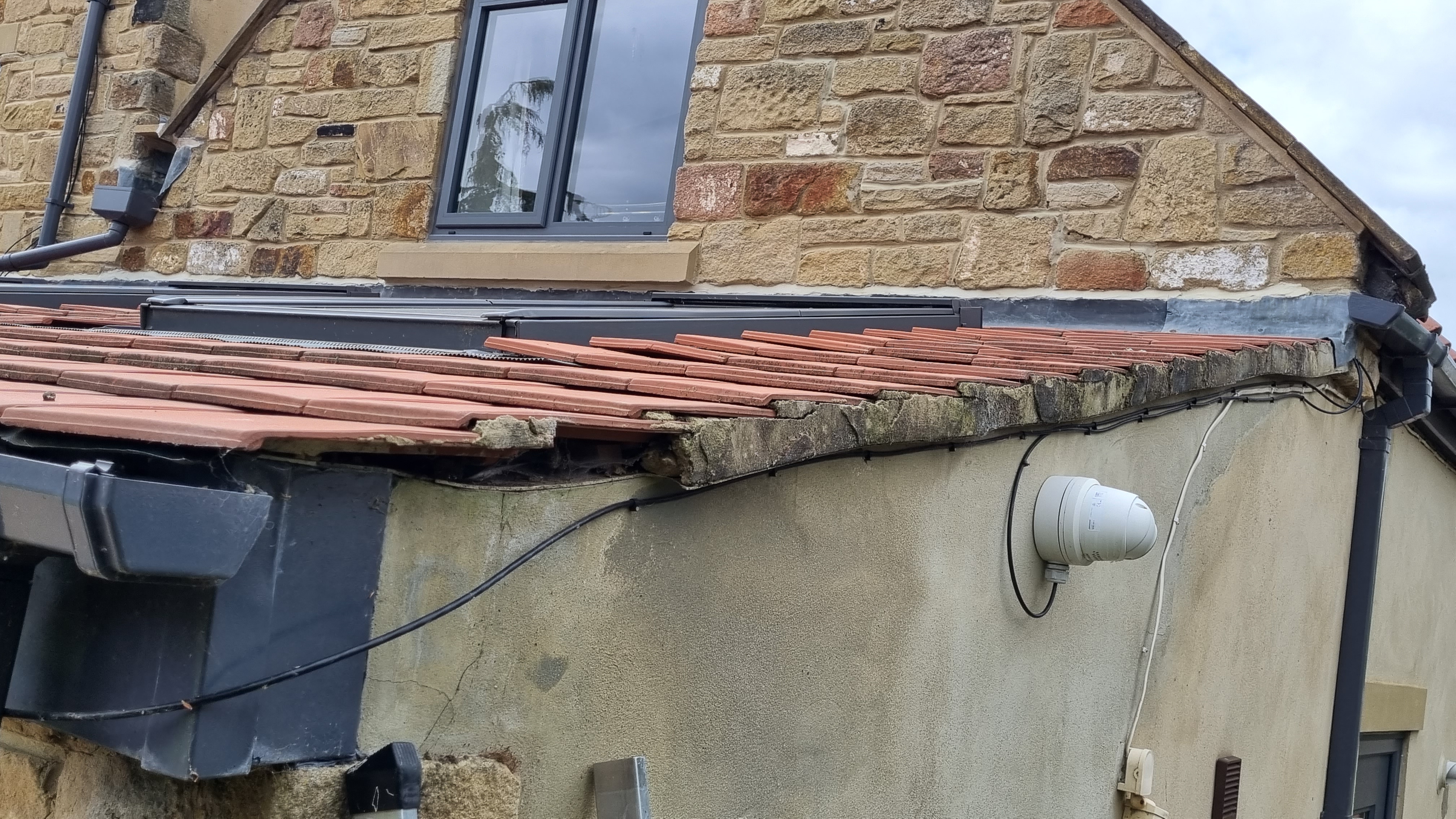

And a closer view of the roof on the side where the verge has failed, just to show the tiles:
The tiles used are 132cm x 22cm:

It was never done properly in the first place, dont use plastic it would look terrible. I would get the verge/undercloak stripped out and done properly with a wet verge.

Thanks Alastair, what is it about the verge that makes you say it wasn't done properly (apart from the mortar failing after only 9 years)? TBH, there is a large housing development on a field next to us and they have been piling for 3 months now. I am wondering if all the vibration caused may have caused the verge to fail, although when the mortar dropped, they weren't actually doing any piling!

Looking at the dry verge systems, our tiles seem to be too small to use them, so a continuous verge may be needed if we were to go down that route. One concern I have about dry verge systems, especially those were the verge and tiles are not from the same manufacturer, is that they may not be as water tight as a wet verge.
Tiles look like sandtoft 20/20 perfect for that pitch
The verge however is and always was a total mess.

The mortar above the flashing was repointed by a roofer last year as we had leaks and he told me it was getting in behind the flashing! Didn't chisel out any of the existing mortar, just plastered more mortar over the top of the existing. The quote he gave me I had assumed was for a day's work, but he was gone after a couple of hours. Despite that we haven't had a leak since, so maybe it was worth it!
