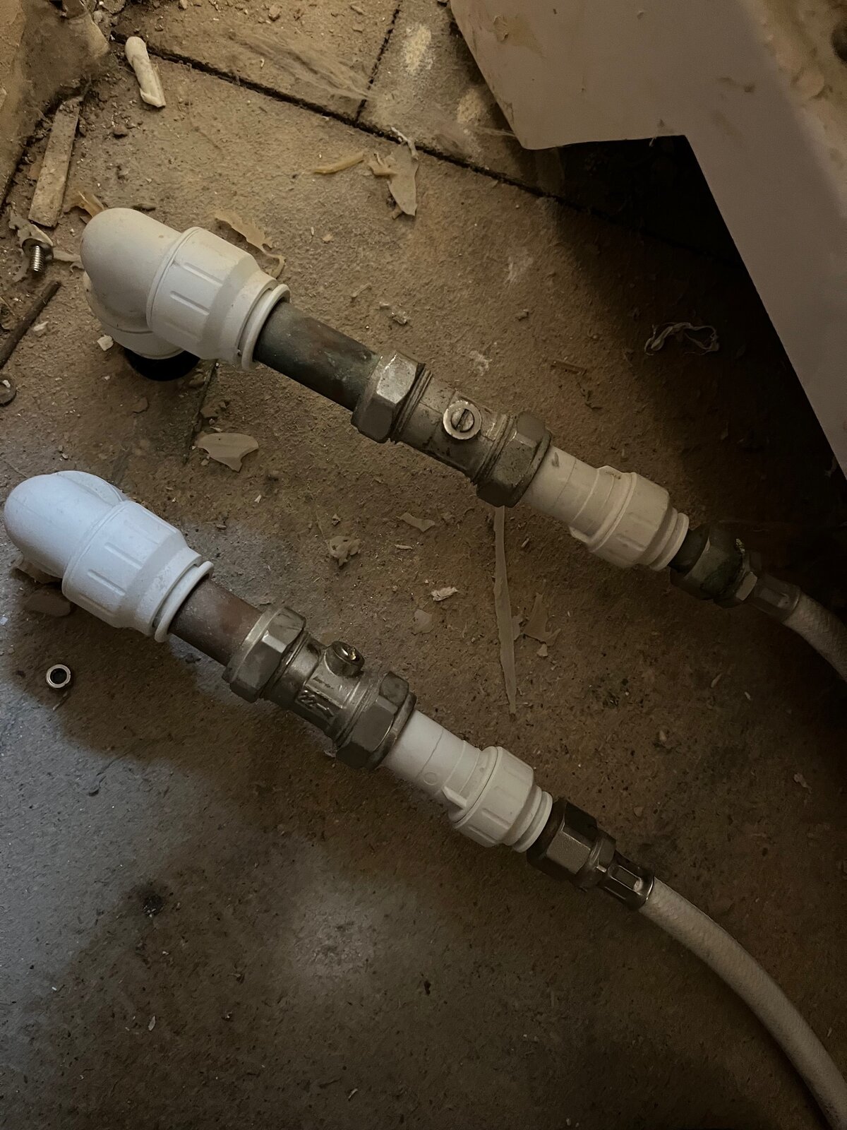

hi, what options do i have to stop water flowing? i am trying to remove a shower, and this is the feed to it, the stop valve on the bottom pipe wont turn so need to know what I can do here please
The two slots that look like screw heads
Are in fact the ends on spindles on ball valves.
When the slots are in line with the pipes
It means "open"
Give each of them a quarter turn in either direction
So the slot lies across the pipe
Which means "closed"
Have you got a large screwdriver that is a perfect fit?
If necessary you can turn off the stopcock to then entire house, and drain the cold-water tank if there is one
And fit new valves
If it's a mains pressure fed, turn main stopcock off and replace the 22mm isolation valve whilst you're at it.
