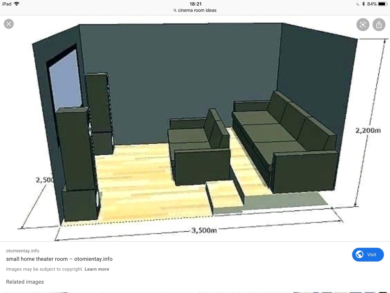

It’s a garage that I’ve converted into a room just for watching films. So far, other than standard walls and floor I’ve made a recessed section of ceiling with a plug socket, ply board and HDMI cable for a projector.
I’ve built a step on the floor at the back and recycled an old corner sofa to make 2 rows of seating.
Apart from that I just have a Blu-Ray player, Wii and an Xbox.
I’m open to second hand but don’t fancy a second hand projector. I was thinking cheap pull down screen, Freeview HD box and some speakers, from a quick google maybe these or similar:

the room looks very much like this but it’s a bit bigger at 2.7 x 4.8.
Thanks for the image. That's helpful.

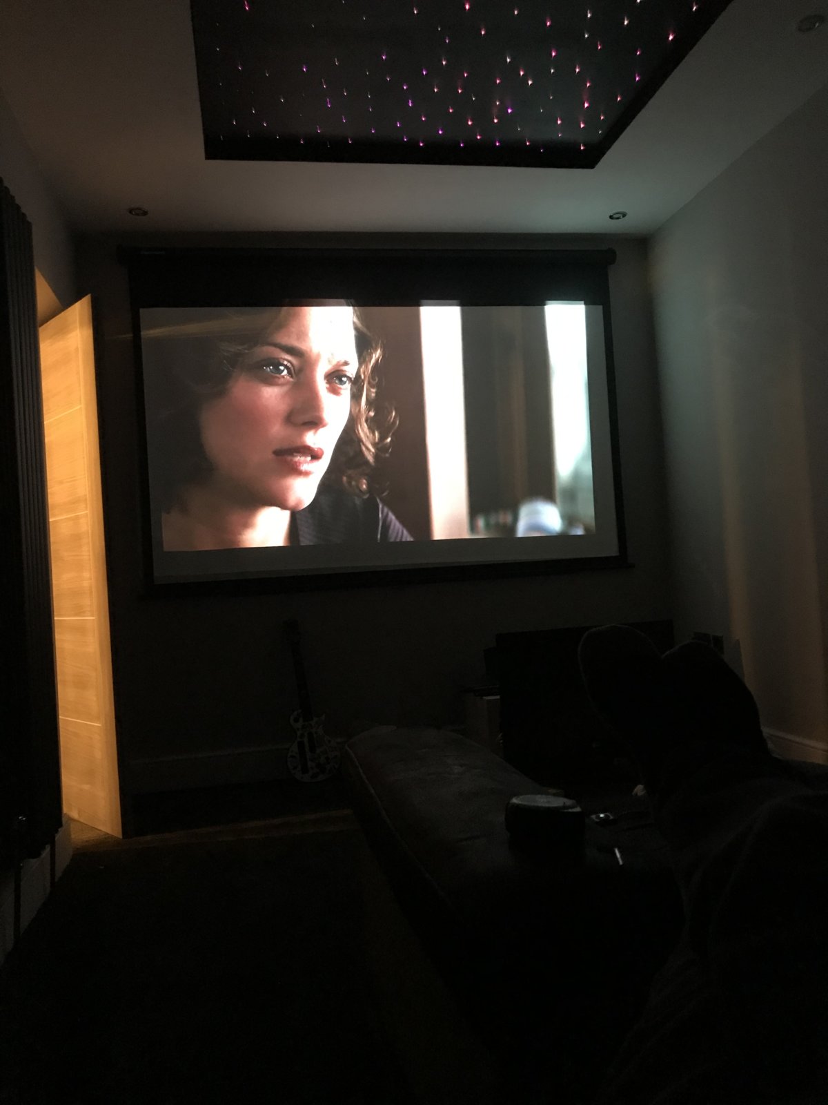

I viewed the Optoma at Richer Sounds in Stockport and liked it so I bought it, it came yesterday.
I had bought a cheap 100” screen before starting this post, it came with a dent so I was going to return it but the seller gave me a full refund and told me to bin it so I fixed it to the wall. I also bought an £8 mount which works buts it’s too flimsy to adjust perfectly.
I haven’t got an AV Receiver or speakers yet, I’m clueless on what to buy. I could risk second had or could go over budget and buy new.
Also with buying blind and not knowing about the zoom I managed to have it sat too close so the picture only goes to 90” at the minute. I think a better quality mount that can hold it back 300mm will fix that.
We watched Avatar and Inception on it last night and all the family seem impressed so far. Hopefully the sound will make a massive difference when I get that sorted.
