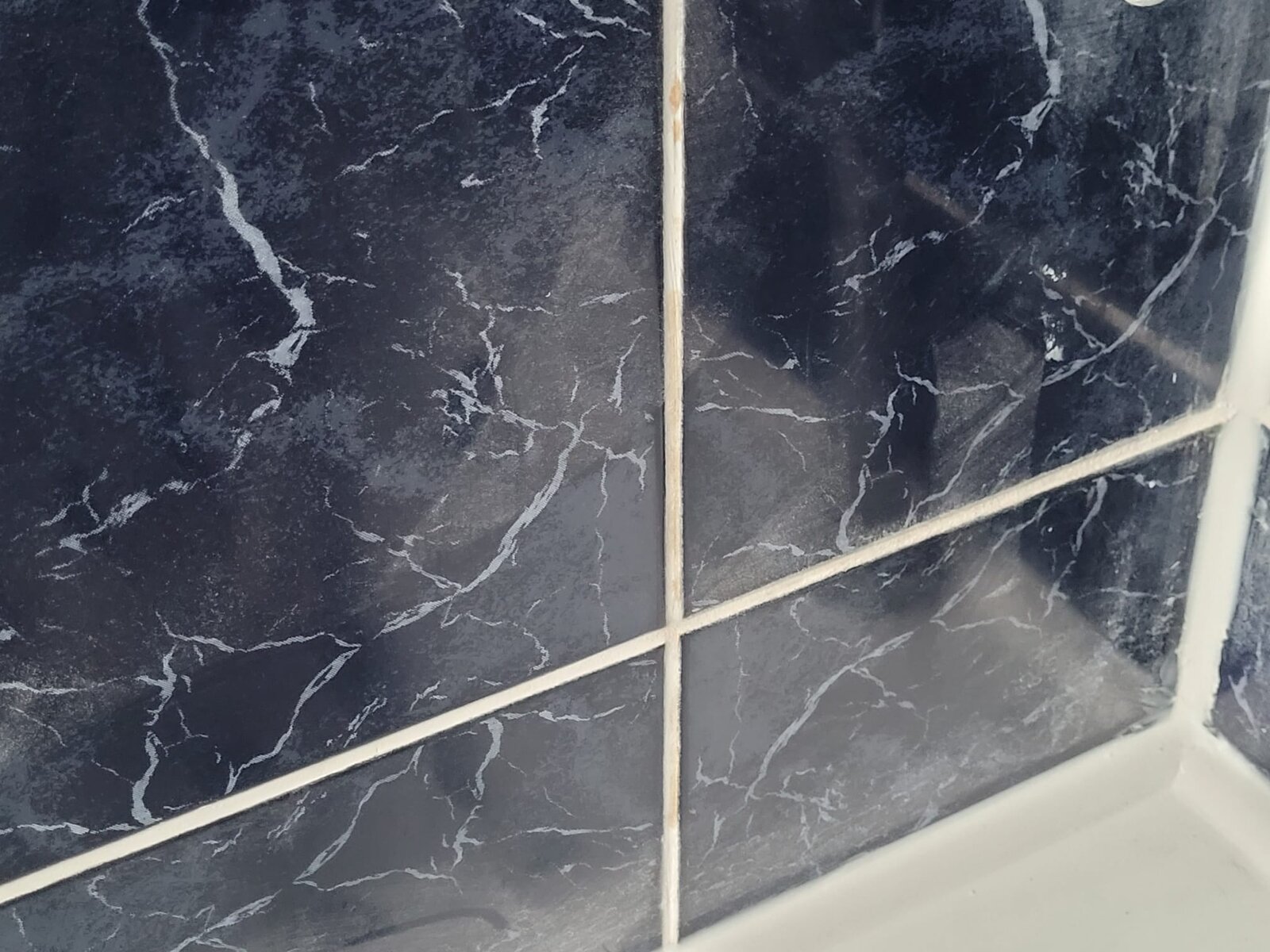

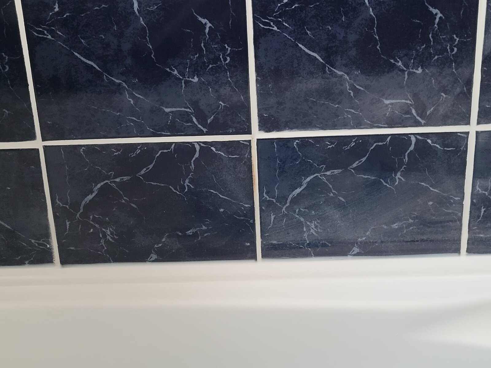

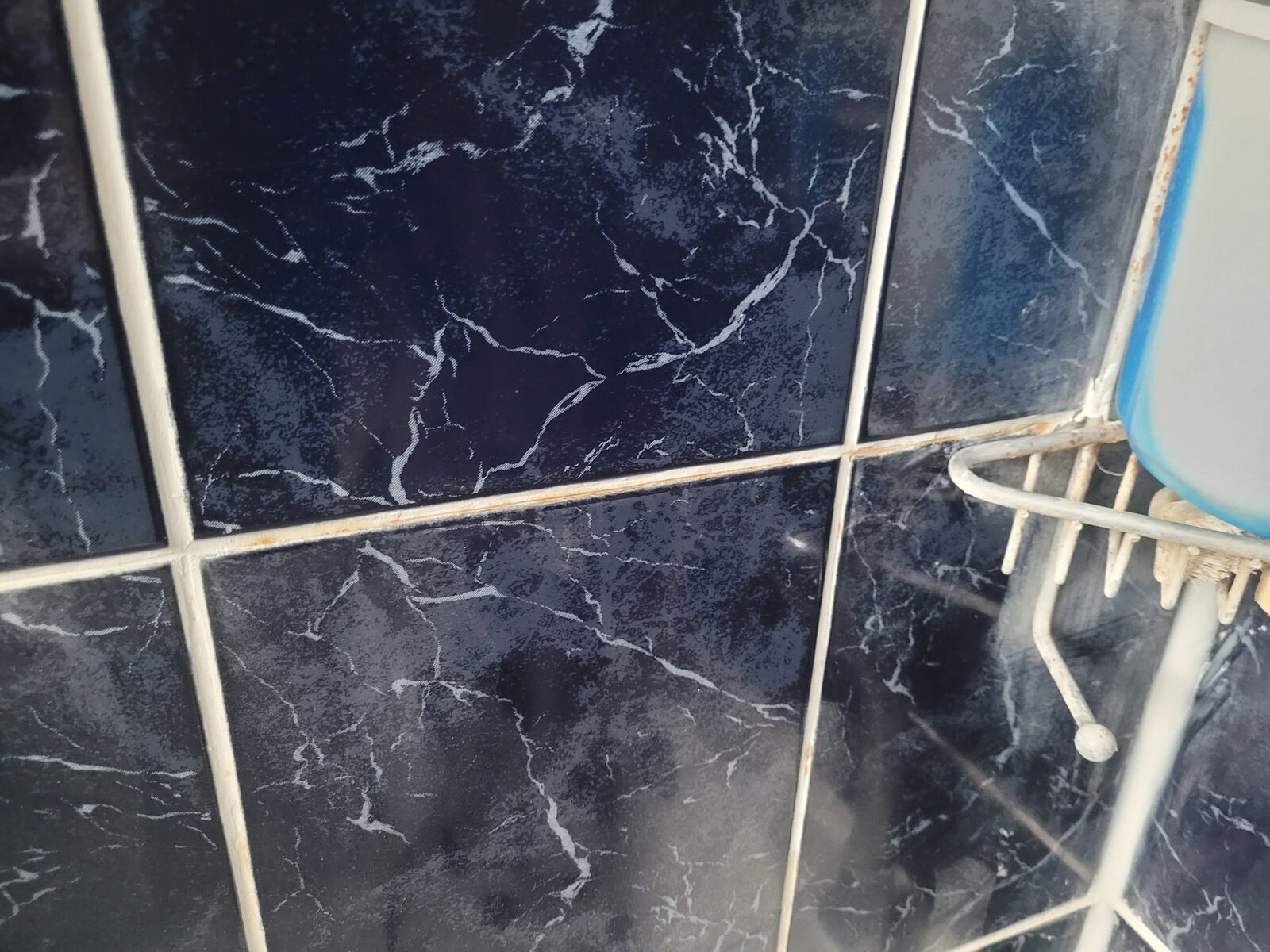

  1. So I finally got around to forking out £300 for a professional regrouting service and did the job yesterday. Although I didn't notice anything immediately at 18:00 yesterday when he finished, I realised a couple of hours ago on further inspection that there are quite a few orange patches.
    I obviously haven't ran a shower this time, and I wasn't planning to until Sunday morning even though the grouter said that 24 hrs was enough. So the grouting can't have been washed away. I was wondering if I didn't see the orange spots yesterday due to the light and that actually it wasn't applied to sufficient quantity with the orange showing through from the back as it also seems as if there is volume at those spots.
    However, the grouter says that dampness behind the tiles causes them to stain and that everything should be "sealed" and I can use the shower.
    I'll wait till Sunday anyway but monitor if it continues to leak.

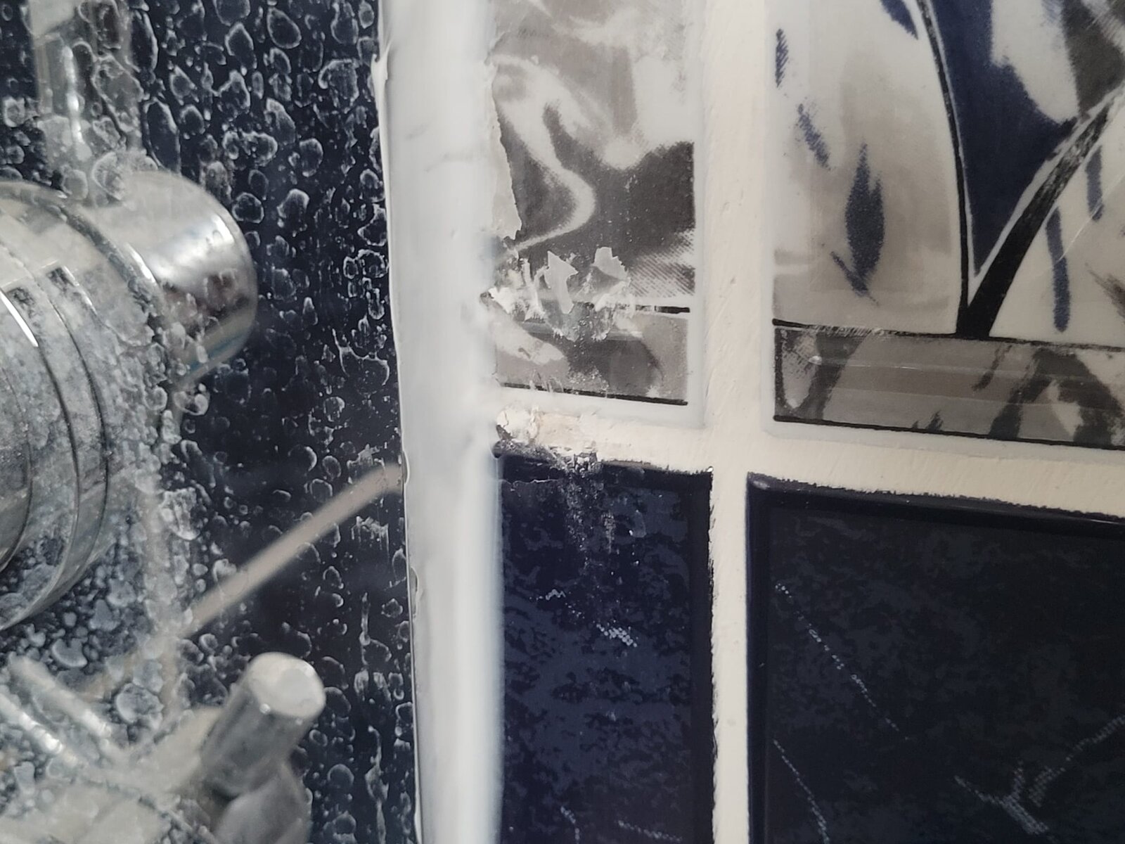

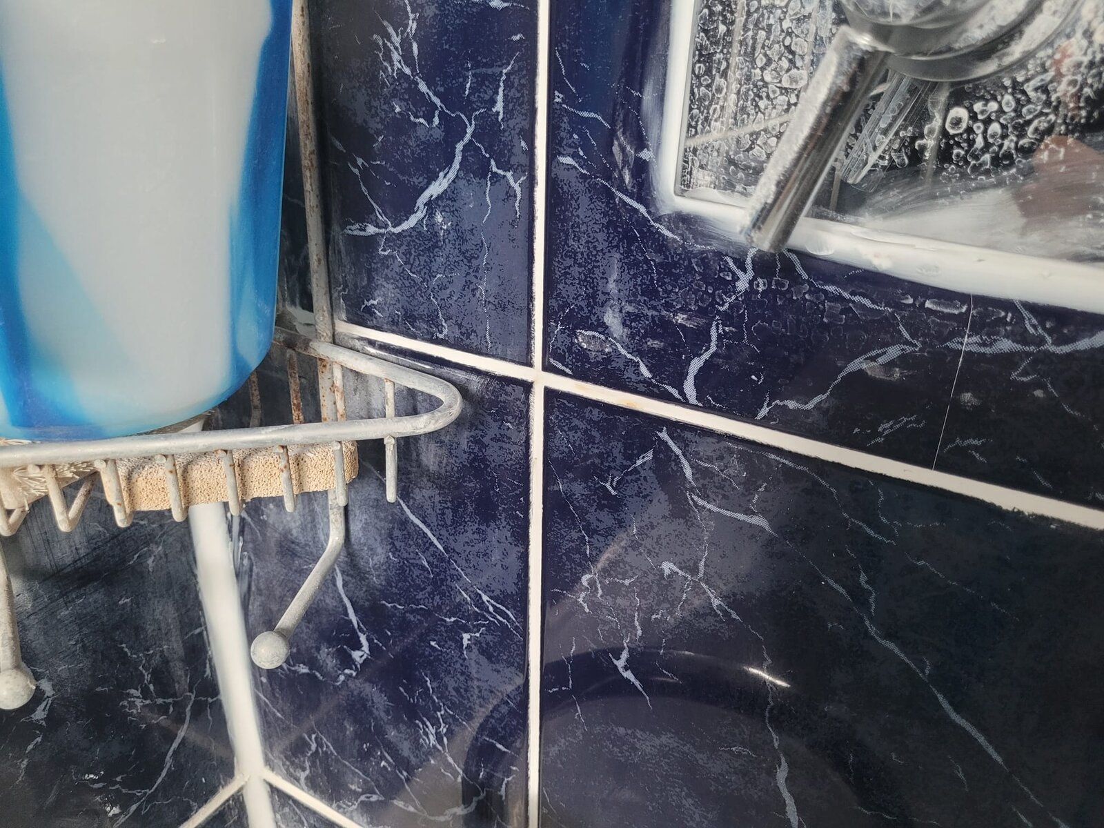

  3. Also spotted a couple of spots last night where the grouting is seemingly crumbled. (final two pics)
    If I touch new grouting anywhere it leaves a bit of powdery residue on my finger.
    (This happens to be the case on the lid of the toilet cistern weirdly from 11 months prior).
    I read that grout shouldn't be powdery/crumbly, but I wasn't sure how powdery was too powdery iynwim.

Orange bits:

Crumbly bits:

Somewhere in your shower bar there's some ferrous metal that's getting wet and rusting. Water (either from the leak or from normal showering) is carrying the rust into the grout (which is porous).
Fix the leak.
Find and replace the ferrous (most likely whoever mounted the shower has used steel screws instead of stainless. Don't ask how I am aware of this problem :) ).
Regrout.
