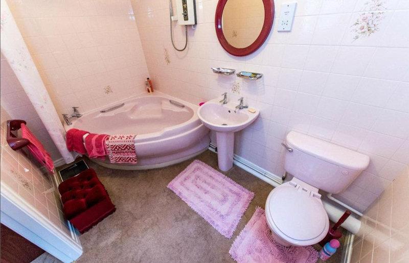

I'll be starting a refurbishment of a property soon and am just trying to get my head around order of work. Bare in mind we can have the work done with the house being empty.
It needs new bathrooms, kitchen, New central heating, replacement double glazing, New door, ceilings and maybe walls need replastering, full decoration,etc.
So I'm thinking, start with striping the wallpaper, check which walls will need plastering. Get the double glazing replaced and new central heating, plaster where necessary, probably have new skirting boards / door frames / doors fitted. Fit bathrooms and kitchen. Redecorate.
Does that sound the right order?
There is tonnes of insulation in the loft, would it be necessary to move all this if I'm having ceilings replaced/down-lights fitted? Or can this be worked around?
Would it be best to get a local builder to do all the work or get individual tradesmen?

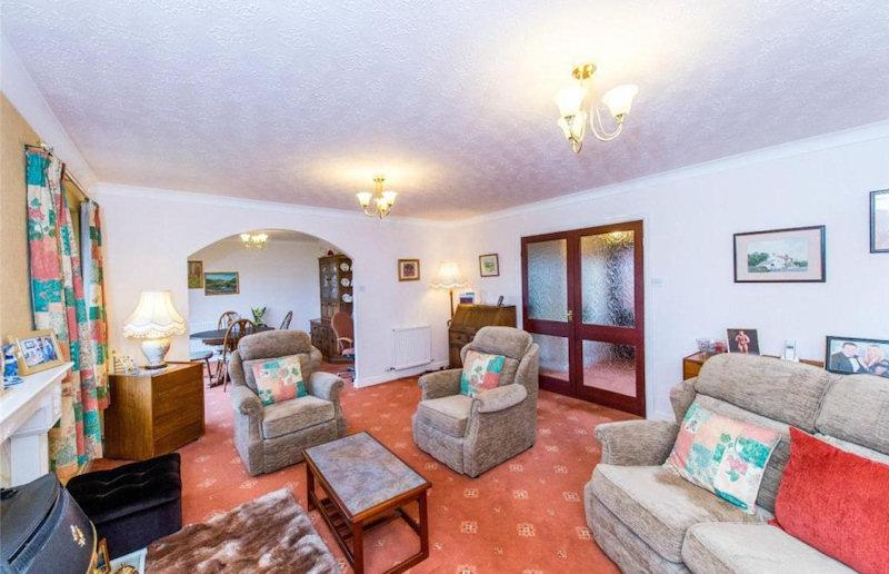

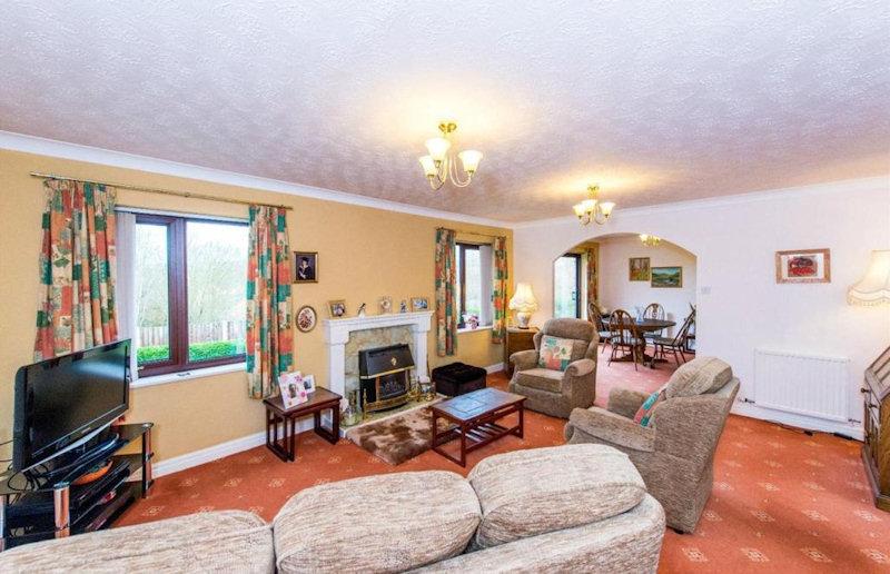

Update archway/opening between lounge and dining room

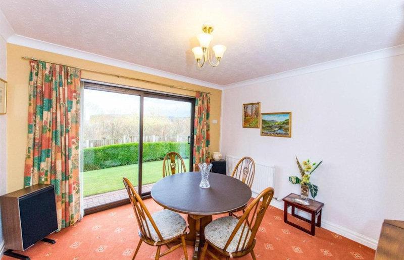

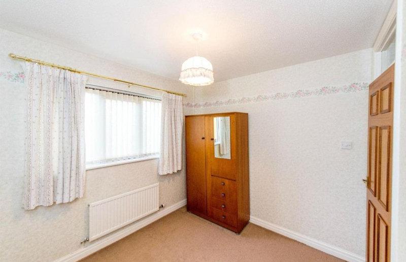

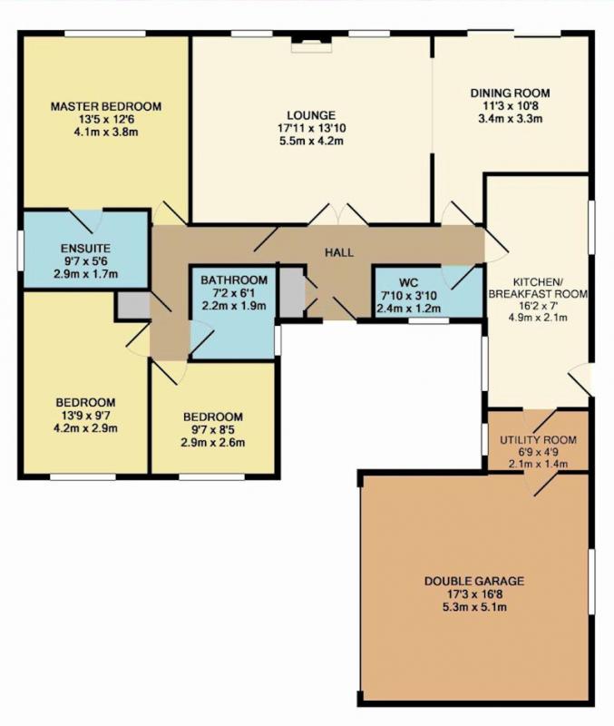

Why not keep this site posted on all before, during and after work with pics? Show the elevations and interiors - viewers can often see more than yourself, they are stood back and neutral. It will be an historical record for you.
