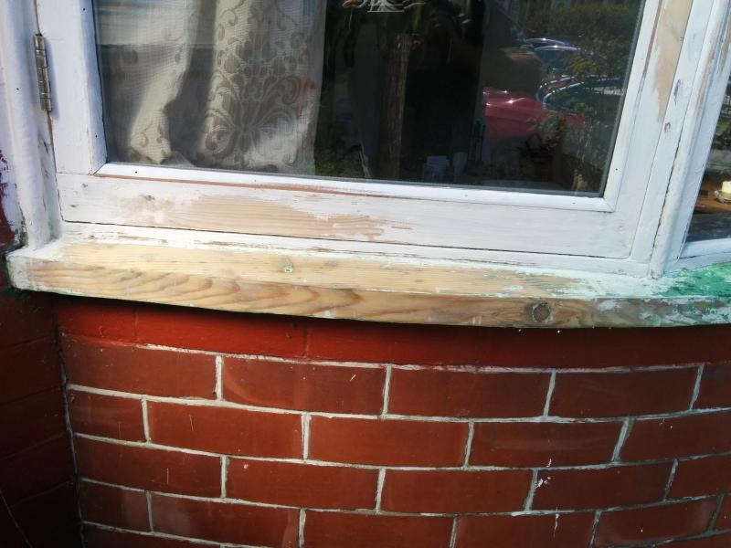

I started off sanding the windows to paint, however the wood looks nice, so thinking of painting the frames (as they're a pain to sand) but doing something with the window sill.
I'm sanding them back, removing all the old filler and rotten wood.
Looking for advice on how to fill the cracks then what to treat the wood to preserve it and keep it looking good.
Please bear in mind, today being a Sunday I'm limited to the metal sheds for places to buy.
Any and all advice is welcome, from sanding filling to finish and colour

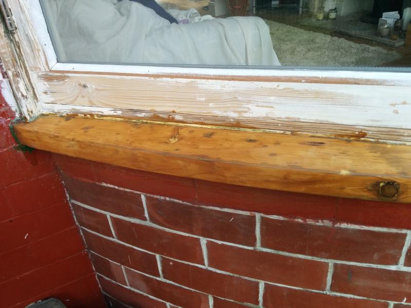

Here's where I got to, u sanded, filled using ronseal, then applied some ronseal natural oak.
In the centre you can see a small spot of filler, it's not blending in, however not exactly sticking out like a sore thumb.

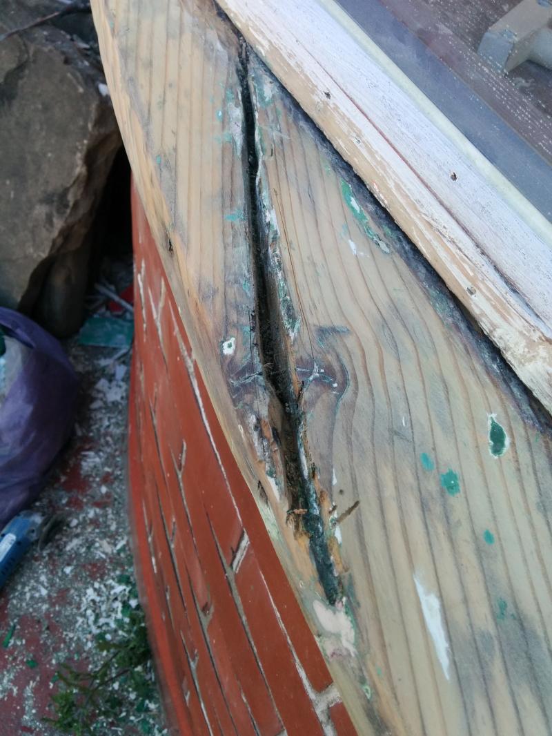

Here you can see the large amount of filler

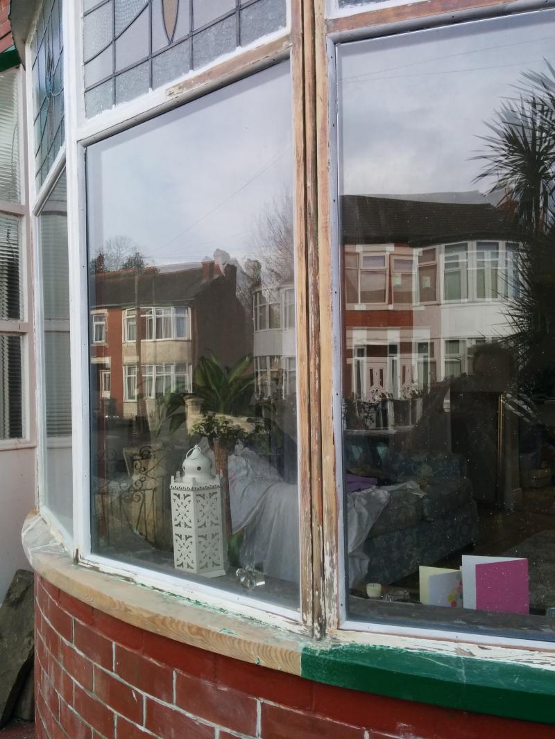

And where I've got to
I'm still 50 50.
I like the idea of seeing the wood and the grain, however there is still a lot of sanding and filling.
And it won't look exactly like a new window.
There's a temptation to finish the sill, and paint the uprights etc white.
I suppose worst case I sand and stain it all, don't like it, then more sanding and painting...
It would have been simpler to do what the old lady before did, no sanding, just put another layer on :)

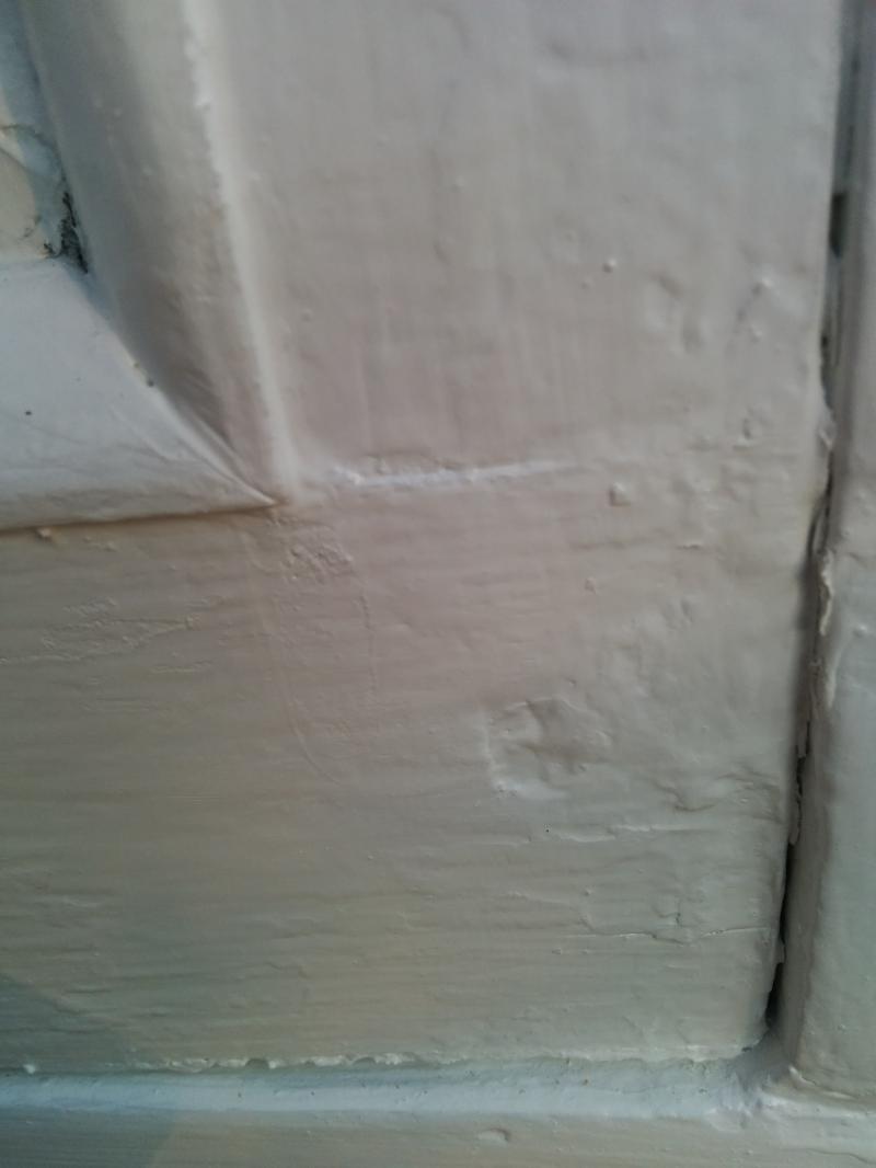

Ok another wood and paint question.
How do you get a smooth finish when the wood is pitted and old.
In the house I would use fine filler.
The Ronseal Exterior filler seems like it is too thick for these small mm indentations.
Or do I just keep sanding those areas until completely smooth even if they end up being lower than the surrounding surface?

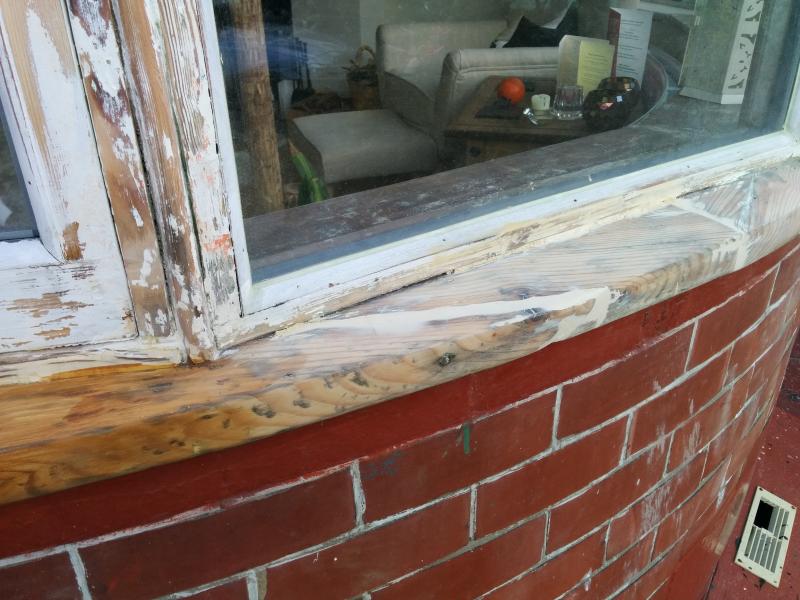

Can't answer your filler question, but to add to previous points.
No to oil/varnish, completely unsuitable for those type of windows, as they don't offer enough protection and durability.
Needs to be a paint or a stain, any heavily sanded areas should be preservative treated as well. Those type of windows are likely Douglas fir or treated softwood, Doug fir has some natural durability but unless you know it is this timber, re-treat them.
Have you re done some of the beading? I ask because the beading on the bottom looks more 'gappy', this again needs to be sealed and protected and paints traditionally did a better job of this than other finishes.
The problem with traditional solid beading like that is water can be trapped behind it and in the joints if it is not properly sealed. Old windows tend to have so many coats of paint on them (including older lead paints), that they work fairly well.

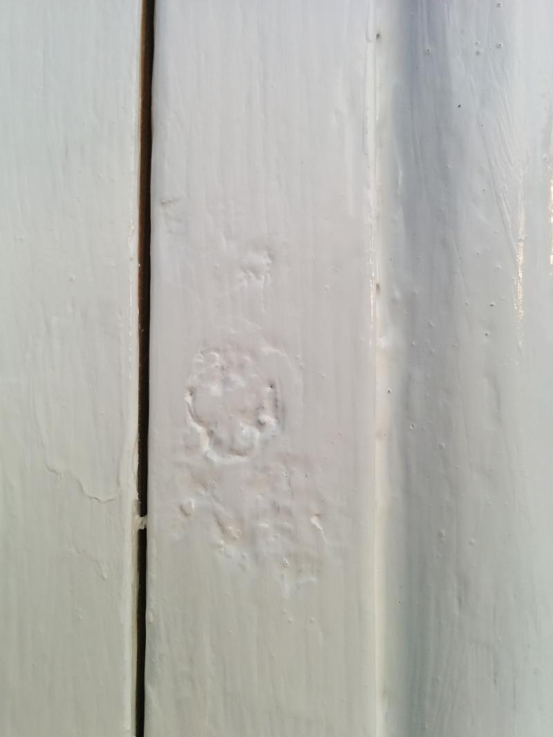

Remove punky wood with a wire brush. Treat with wood hardener. Use a 2-pack filler, or even P45 car body filler. Sand. Prime. Paint. Single pacjk fillers aren't as durable and tend to shrink
And TBH I think your filler looks awful in bare wood and to me that does stand out, but then it's just that when my customers want it to blend in they really mean "disappear"
My two penn'orth:
1. Bare wood - if you like the look of wood grain, you're better off doing this indoors. Exterior softwood is meant to be painted, and looks better for it.
2. The defects under the paint - in my opinion this is what gives old painted wood its character, so I wouldn't worry about getting it absolutely smooth.
how would you make it disappear?
I can grind out the filler I put in, but when I looked on the shelves, that was the nearest colour match I could find
[/quote]
As I may have stated - you wont get a colour match, even clear lacquer will change the colour of the timber and any competent, self respecting tradesman would recommend painted finish. Anything else looks like a DIY bodge job to me
