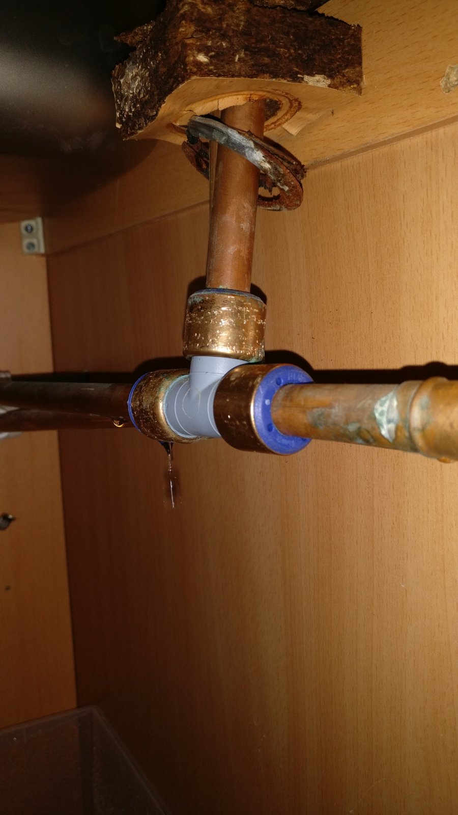

Anyone know how to remove these osma gold pushfit ??? Cannot for the life of me do it

It's not the hep20 one but I did manage to sort it.
Basically unscrew the blue ring then pull away from pipe.
