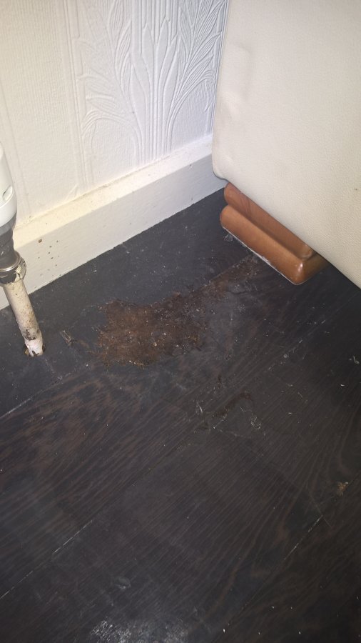

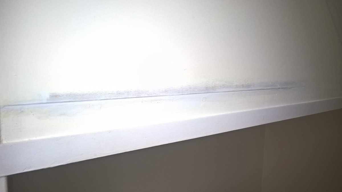

Just signed up here and could really use a hand. Me and my mate just started renting a new place out and it's great! Thing is though, it needs quite a bit of work done as you can see.
We've got a friend that knows a decent amount of DIY but some more help would be good.
We've fixed a few things and we're working on what we can. We just need this place to be more livable each day as we have to stay here.
Any hints and tips would be much appreciated!
More pictures to follow, this isn't even half of them
Thanks for reading

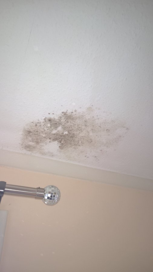

The mould suggest there's been a lack of ventilation in the place (or the heating insufficient) and need cleaning off with a mild bleach solution.

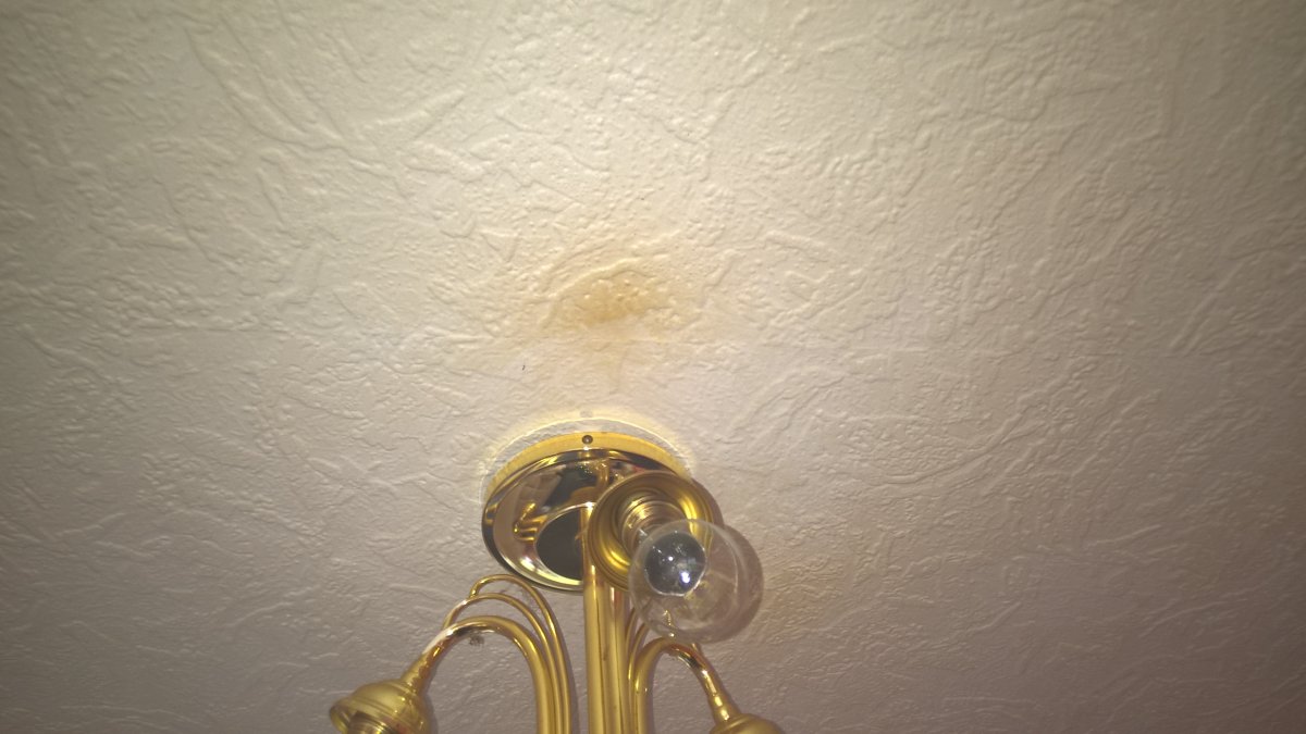

You need to be careful on the ceiling with the wooden door, as this might be chipwood wallpaper on the ceiling, or it might be artex, and if old, might have asbestos particles in it. You'd need to use a wallpaper steamer on this to get it off safely, and then repaint.

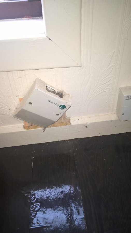

You shouldn't do anything with the cooker point, as this being electrical, is way outside your safety remit.

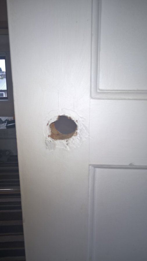

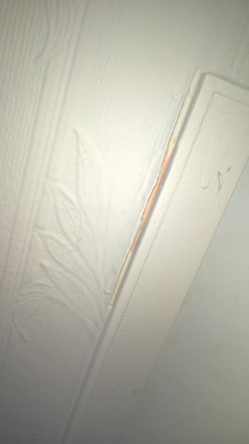

Some bits just require general painting after a stain block has been applied.

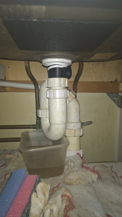

The leaking sink is the landlords responsibility, as it need an experienced plumber.
Have a look in B&Q for a plaster coving (or equivalent) to cover the mess on the ceiling, and screw the ceiling rose cover back on.
I can't really see what the problem on the floor is, but it may just be a case of rubbing down the mark, and then repainting the floor.
