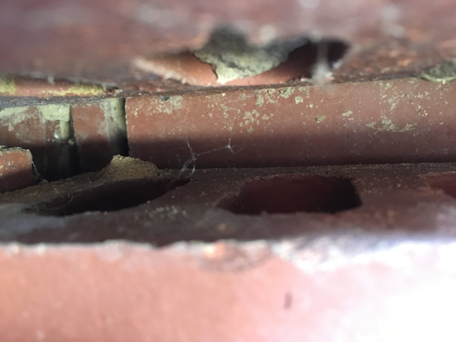

Also of concern to me is that there is a couple of engineering bricks below the DPM without mortar around them. I can't really understand why that would be?! Any ideas on why that would be done? I'm told it's a concrete slab extension, so it's not like they were thinking of adding airbricks etc.

1. You can see the damp proof course on the first close up picture, but not on the second. Looks like the pointing has breached it, or it's non-existent.
2. I'm assuming that's the cavity I'm seeing in the last picture. Should that not be 10cm between the brickwork?
As the DPC is in one picture, you can assume that it's been done all round; so the mortar may have breached it, but as it't the outer leaf, it's not so desperate, just lightly rake it out. And if it had been breached inside, you'd see evidence of damp.

The brickwork does kick around the level of the lintel, so if they have used a lintel designed for a bigger cavity that would make sense -although that is shocking cowboy attitude given that lintels are readily available. It would be surprising if the wall had anything other than a 100mm cavity which I guess is a most common lintel size.
I know it's hard to tell, but the picture within the brickwork, do you think that cavity is 100mm? To me it does not look like it.
