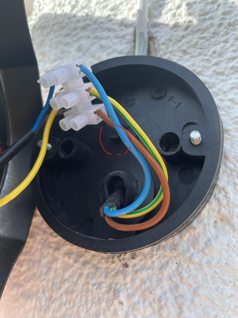

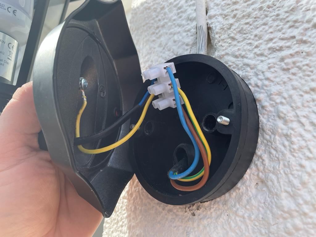

Good afternoon,
I'm replacing three existing PIR lanterns with non-PIR lanterns.
Removing the old units, it's just 3 core wire through the wall, which joins in a terminal strip in the new units.
I haven't installed outdoor lights before, and wonder whether anyone could cast their eye over the install. My thoughts are;
- That the cables just 'rest' inside the wall attachment (I've placed them in the upper half of the wall mount to hopefully avoid water). Is this arrangement fairly normal, or would people take other measures to protect the cables? The light included 3 short strips of heat shrink but I can't think what they'd be for.
- The wall attachment (the bit that screws into the wall and subsequently holds the lantern) has a gasket of sorts, which supposedly mates with the lantern unit. That said, it's made of plastic and deforms a bit when screwed to the wall. I've done my best but I wouldn't imagine the seal is that good. They're supposedly IP33, and at the least are under guttering etc, so shouldn't see much water anyway.
The lamps are;
https://www.toolstation.com/victori...Jv9kAtfj0dgu1H-tA9oaAu-BEALw_wcB&gclsrc=aw.ds
Ultimately I just want to know if you sparks would do anything differently, or whether these lights are just no good etc etc.
Your thoughts are appreciated.
Many thanks.

Looks like the usual cheapo tat.
The terminal strip should fit onto a peg or tab moulded into the top part of the plastic.
There should be a drain hole in the lower edge of the plastic part.
Nothing else needed or can be done.
