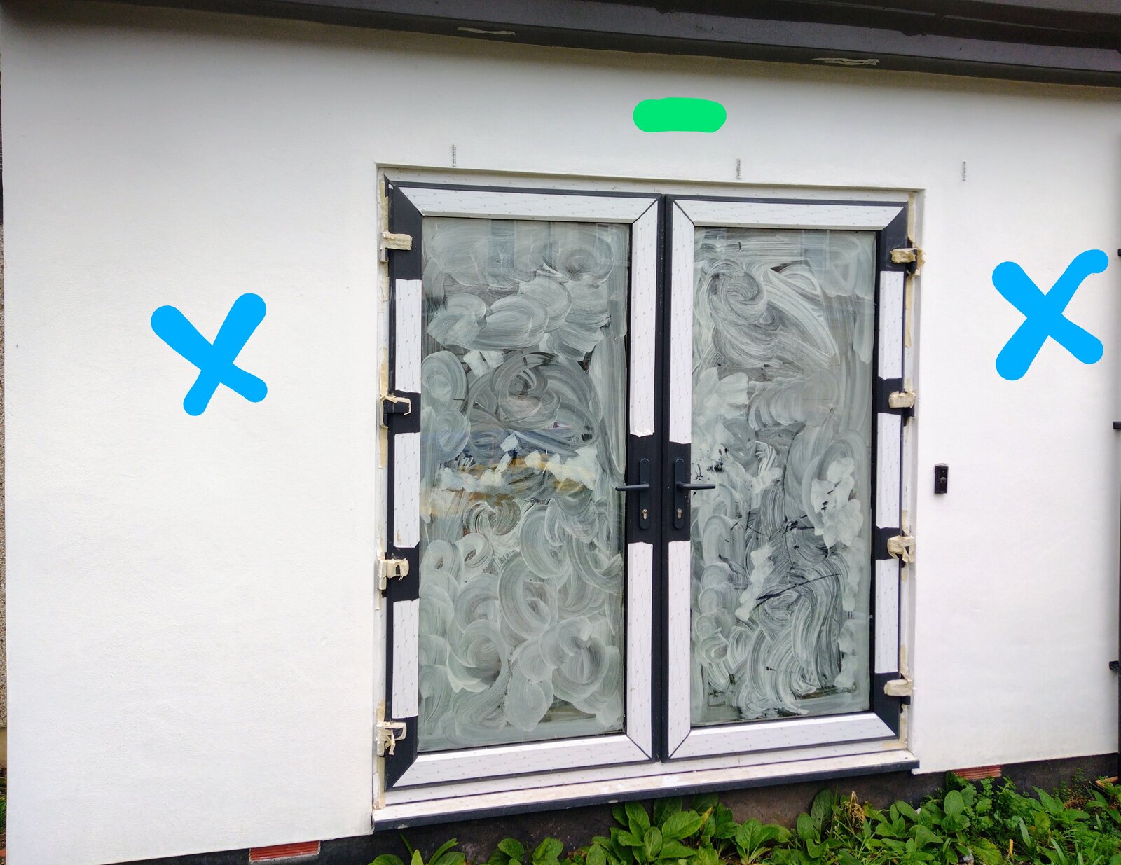

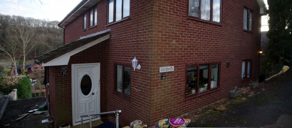

I want to install two outdoor lights in the areas marked blue.
I want the lights to be motion activated, so plan to add a Pir sensor.
Would it be best to place the pir
1. above the doors (marked in green).
2. Recessed In the soffit
Or somewhere else? Perhaps above the light?
Would the soffit pir detect motion in the garden or would it be limited to motion directly underneath it?
PIRs detect motion best when walking across their field of view rather than moving towards them or away from them.
Most of them can't differentiate between a human and a hedgehog or a car. They see a change in heat source and react to it.
Try to place the PIR where it will see the person who requires the light but doesn't see a road , footpath, swaying bushes, light source or a heating vent in the background. Whatever the position it is likely to be activated by passing animals and strong winds.
Each PIR has a specific angle of view horizontally and vertically and also a range (distance from the sensor, which might be adjustable). These parameters affect the optimum position of the sensor.
Better quality sensors using two different detection methods (dual tech) are available at extra cost. These are better at differentiating between people and animals but are still not infallible.

That's awesome. Many thanks for the advice.
Never knew about the dual tech PIR. Brilliant!

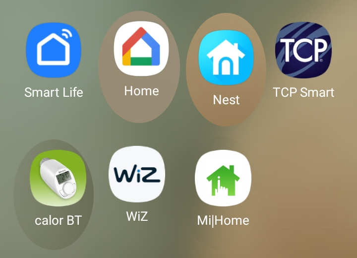

I use google mini's, same idea as Alexa, but cheaper, all the items controller as grouped together in google home, which is just as well, as I seem to be collecting apps. House-Apps.jpg However by selecting rooms, and I have outside as a room, I can use a single command to switch on all outside.

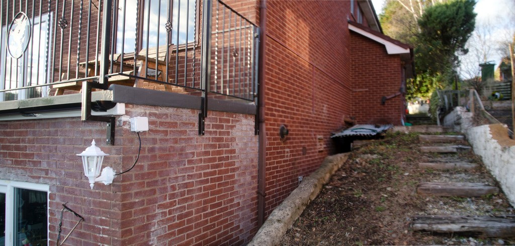

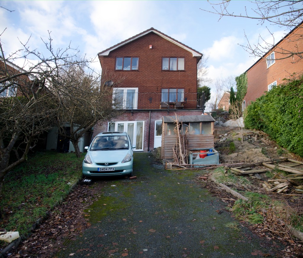

But the 4 wifi controlled lights have worked very well. And so easy to install, two have simply smart bulbs installed, and two use smart socket adaptors. This Lights looking up right side.jpg was a problem, how to trigger the light with a PIR which can see whole of the route. An over view Lights to bottom of house overview.jpg from where I park the other car shows the problem. The shed masks the light from one light, and apple trees from the other, but between the two lamps we can see our way to the house, but distance too far for a PIR to detect without detecting every cat.

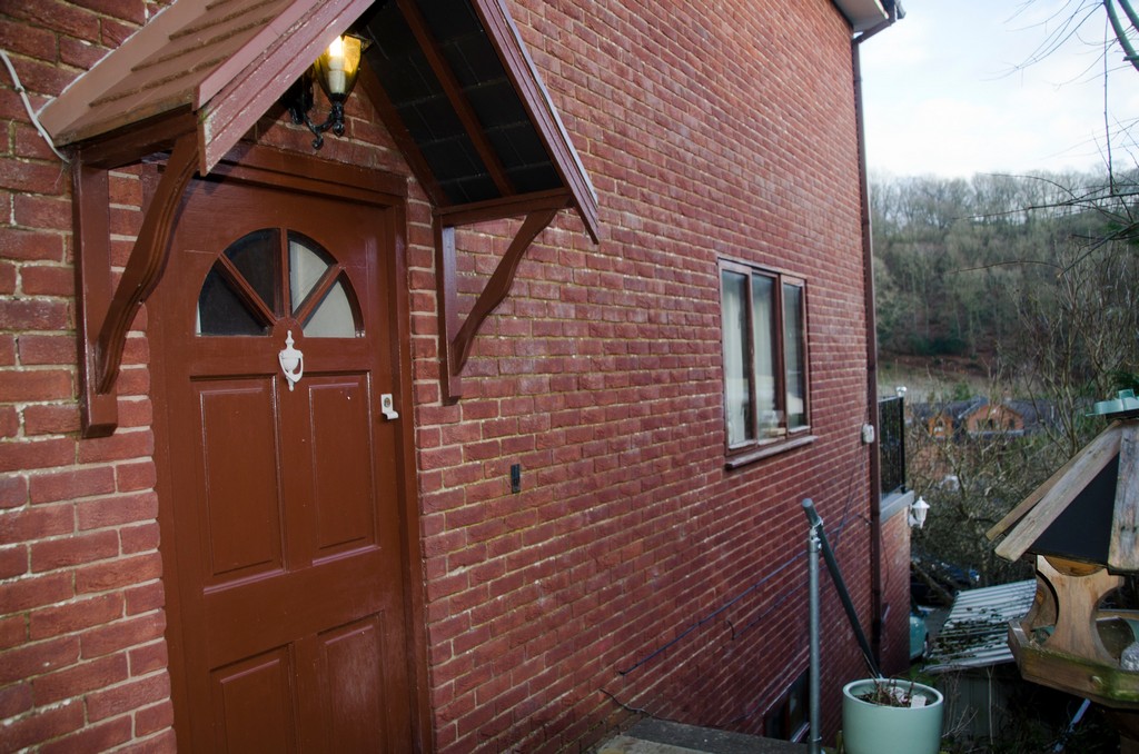

We have steps both sides of the house and the final lamp is shown here DSC_7390.jpg official the front door, but most don't even know the door is there. I would assume when built there was a pedestrian access with steps to that door, but today you need to pass the back door to get to it, so only used to assess one of the patios.
There is a street light behind third picture, but the trees stop the light, and it switches off at around midnight, so not much help.

@pcaouolte @ericmark You guys have gone above and beyond. I couldn't be happier with the advice provided.
Both of your suggestions took me down a PIR vs Smart Lighting Rabbit hole :mrgreen:
I think Smart Lighting and Switches are the way forward tbh, plus it will be a simpler wiring job for me.
The side of the property (not shown in my original pic) has no activity e.g. motion from humans, animals and no trees etc. So I will put some cheap PIR floodlights from screwfix there.
The rest of the house externally will be smart.
Thanks again guys.
