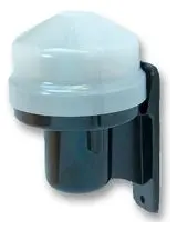

I have some lights at the back of the house which offer a nice level of lighting for the patio. I like to keep them on overnight as a bit of a deterrent, because when they're off, it's pitch black and secluded at the back of the house where the patio doors are.
I have been remembering to switch them off when I go to work, but one day I'll forget and there will be times when we're not in. They are powered by an FCU spur taken from a ring socket directly below the switch.
I've been looking at timing switches so I can programme when the lights come on and off. Would a switch like the this work? I installed the sockets and lighting circuit in the extension with a neighbour electrician supervising, so I feel I have a 'working knowledge' but I have no idea what the terminals are like on the back of one of these. Can they be installed as a direct replacement to an FCU?
Would a dusk to dawn sensor make more sense?
That way you won't need to adjust it throgh the year.

Thanks for that, yes I had considered this. It's a very valid argument. I've weighed it up quite a bit over the past month and decided to go for it. Rather than it staying on all night, maybe the best setting would be for the light to stay on until midnight-ish (a few hours after we go to bed), then switch off and maybe back on a few times before sunrise. I'm hoping this would give people the impression we were "at home".
On the approach to the garden (if they decided to hop over the side gate) the would-be scum would set off the lamp by the front door and the Ring doorbell on the drive, then the PIR light down the side of the house (which would be illuminating them while they clambered over the gate) -- so I hope this would put them off.
The timer you linked to does not contain a fuse, so would be an as well rather than a instead, I wanted access lights, and like you wanted them dusk till dawn, but the hours in my case 10 pm to 6 pm unlikely to get visitors either wanted or unwanted, and there are times we are out past 10 pm so wanted a method of override should we be out late, the answer for me was a smart switch.

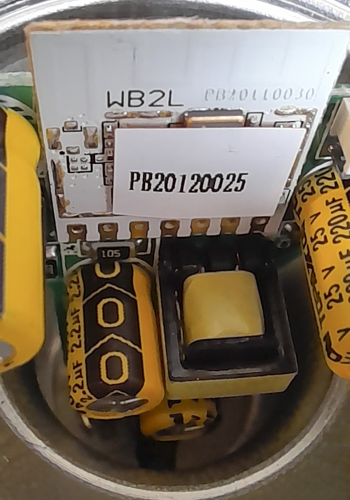

Lights have changed so much since the days of the tungsten filament, the main thing is they produce less heat, so electronics can be built into the bulb. This 20220603_113820_1.jpg is what one sees today inside the bulb, this was a GU10. We can get bulbs with built in PIR, changing colour, changing colour temperature, dusk till dawn, fade in and out, and the old dimmer switch is rather useless today as when dimmed by them there is no change in colour to give the ambiance.
We can't buy tungsten and with so little heat using LED in the same fitting outside can mean water ingress. We have no option we must move with the times. Wonder what the little madam looks like now?
