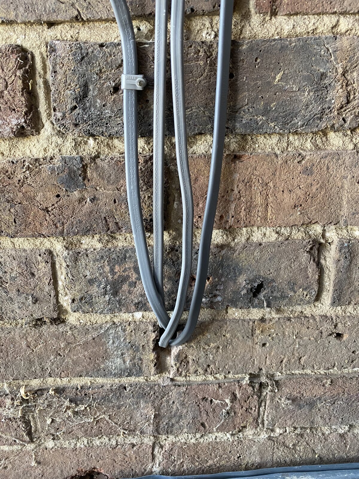

Thanks guys, have put the red braided cable back in as didn’t look 100% so shall see how it tests tonight... also, I have these 4 cables running through this brick wall into the consumer unit the other side, does it matter that they aren’t in conduit? (An old external wall which is now internal)

...also, I have these 4 cables running through this brick wall into the consumer unit the other side, does it matter that they aren’t in conduit? (An old external wall which is now internal)
Maybe not ideal, but I don't think you should worry about that. They all ought to be clipped to wall, though, and you should avoid any tight bends where they come out of the wall.
