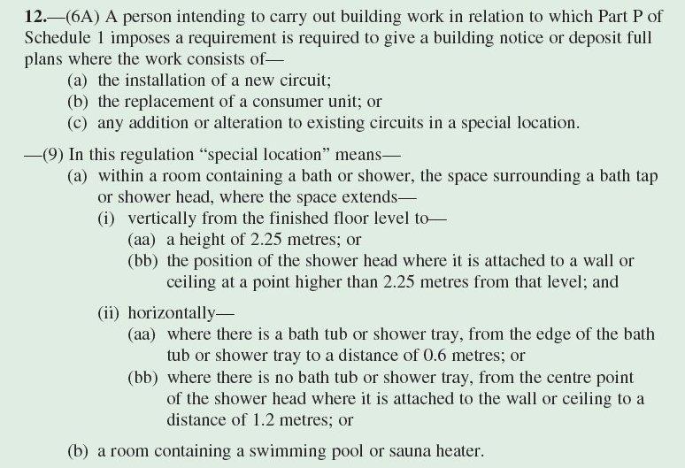

Interesting - I may need some education here. I realise that Amd3 of BS7671:2008 added Chapter 714 (which says very little which is not obvious), but where does that date come from? - and. more to the point, have I missed some upcoming changes to the legislation regarding notification (in England)? Although the current legislation requires notification of additions/modifications in "special locations", the definition of "special location" for that purpose is very limited - only bathroom zones and rooms containing swimming pools or sauna heaters. Have I missed some significant upcoming changes?

Did you not read what I wrote? Unless there is a change in the legislation, that simply is not true. As I said, in the current legislation, the definition of "special location" for the purpose of notification (in England) is very restricted (far more restricted than the things that BS7671 chooses to call "special locations"):
... so, unless you know of some upcoming changes in the legislation of which I am unaware, you are talking nonsense.

Notification is a process which comes under The Building Regulations and as such the definition of a special location is as shown above.
It has nothing to do with BS7671.
