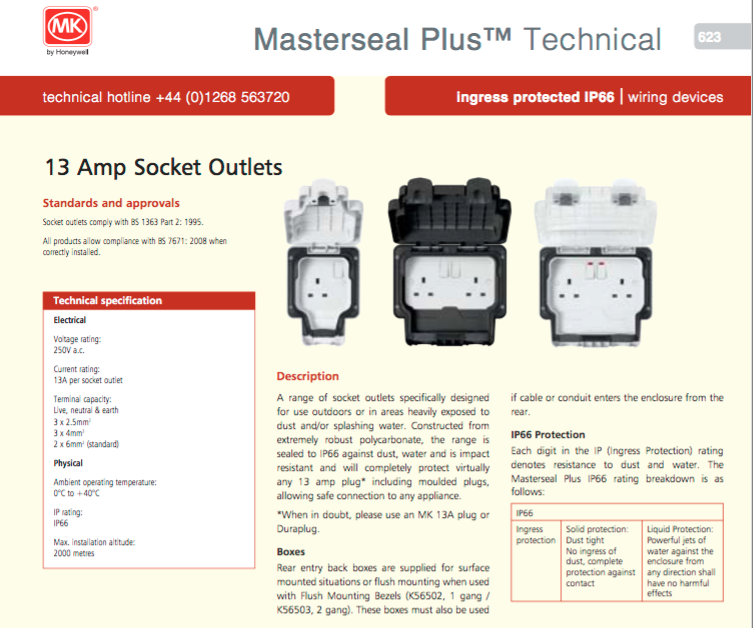

Outdoor sockets that can take 2 x 6mm SWA cores?
BS7671:2008
"The regulations apply to the design, erection and verification of electrical installations.."
Did this electrician not think about this when designing the circuit and planning the installation? Very poor that you are now having to come to a DIY forum to ask for advice when it should be him who shouldn't have even ran into this problem.
