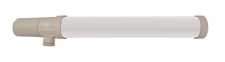

If by "washer" you mean a washing machine, there will be an electricity supply. So, how about a small tube heater. They start at about 40W and if wired through a frost thermostat it will only come on when there's a risk of freezing.
