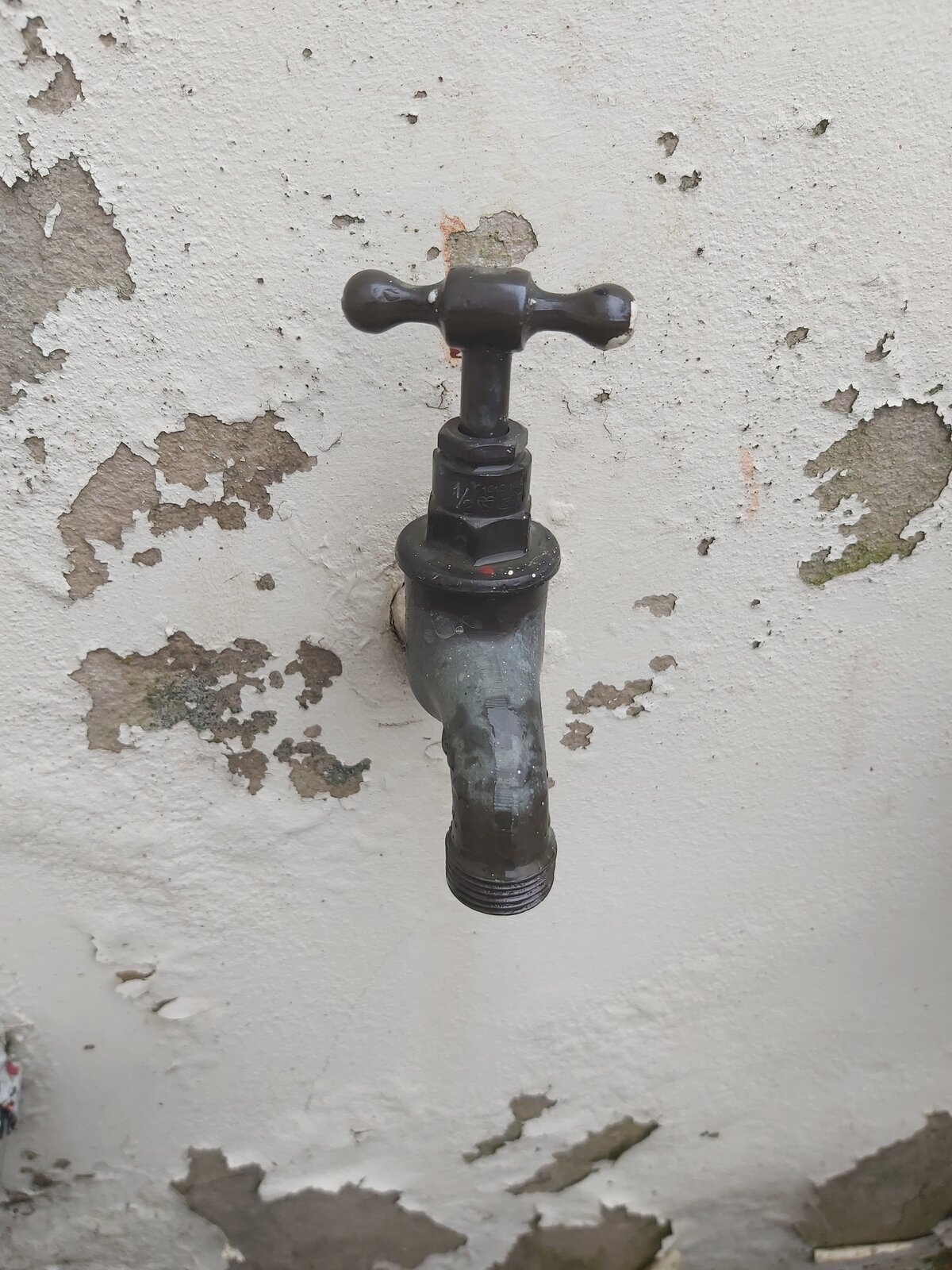

I've measured the exterior diameter of the thread - it comes out as 23mm (accuracy may be a factor; I closed an adjustable wrench around the thread and measured the gap between the jaws). The tap looks like this:

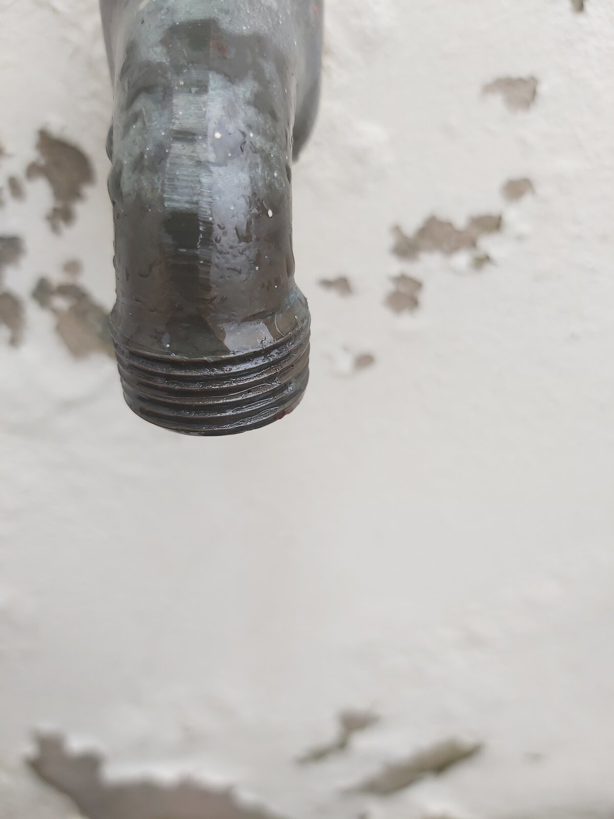

A close up of the thread:
this tap is stamped 1/2" and a British Standard kitemark
I bet you 50p it is not a metric thread.
it might possibly be tapered.
if your measurement is accurate, the spout might be 5/8 Inch BSP (22.99 mm) / 0.902" 14 threads per inch
you need to hold your measure up against it.
Wouldn't surprise me...
Any ideas as to how the devil I'm going to attach a hose connector to that thing? I am not enthusiastic about getting a new tap put in as that wall is ... well, given what I said about my grandad's reluctance to spend money, God alone knows what's going on behind that wall...

But I can't help thinking 3/4" BSP is more common, so check again. 26.44 mm
If you already tried a 3/4" and it was really loose, go for 5/8"
if it is a bit loose, use PTFE tape on the thread.
3/4 is more common but, as John D has found a 5/8 by 3/4 is available ( I didn't know that ) you've got a 5/8 on the tap deffo.
