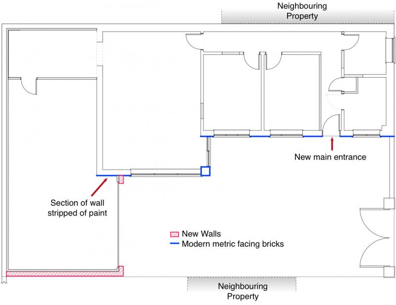

Here's a basic plan drawing of the house - sorry for the poor quality but the forum software wouldn't allow anything better
The modern metric bricks which have been painted are highlighted in blue. I have stripped one section of this wall as detailed above with images and noted in the plan drawing. I have also noted the new entrance to be inserted into this wall. There are two walls to be constructed - highlighted in red / hashed. All of the other elevations & walls including the boundary walls are constructed from the old imperial bricks pictured in a previous post above. These have not been painted.

OK - I have come up with another solution and one which I quite like the idea of if it would be deemed acceptable - brick slips!
The walls highlighted in blue above are formed from dot / dab plasterboard - thermalite block inner leaf - 50mm cavity with blown knauf wool insulation - brick outer leaf.
Would these walls be suitable for an exterior insulation & brick slip installation?
I am wondering about the cavity wall insulation already in situ - and the possibility of interstitial condensation or other issues by using two layers of insulation at two points within the wall structure...
