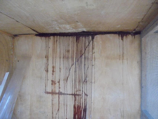

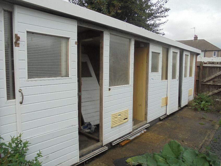

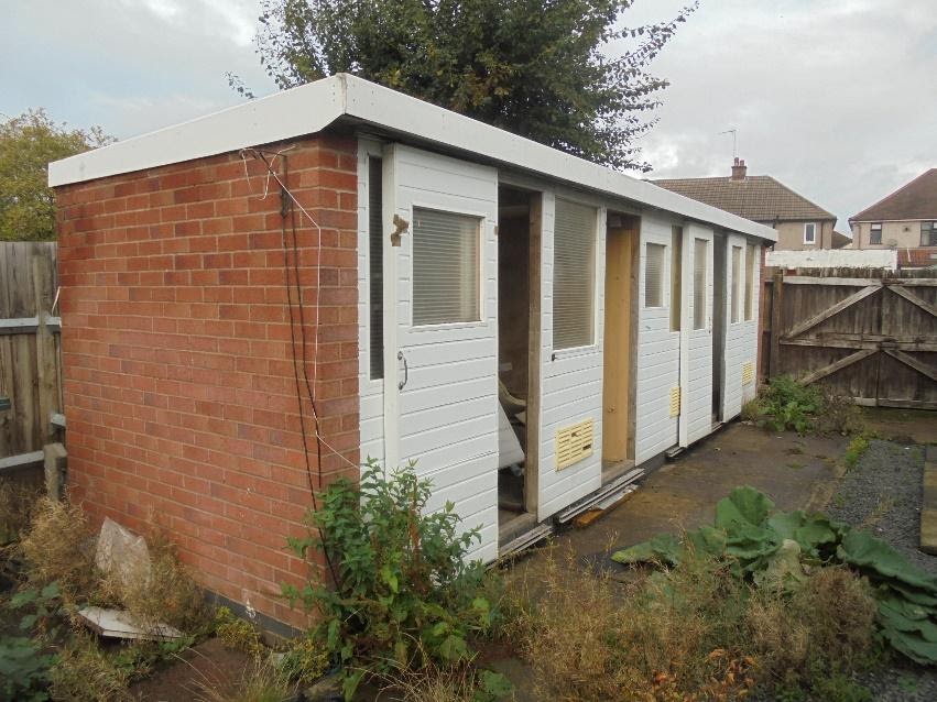

I am buying a terraced property (for rental purposes). The rear garden has an outhouse, which is made of bricks on 3 sides and has wooden doors on one side to make separate compartments as shown. The Outbuilding has a Felt roof which has been leaking for a long time and my surveyor has recommended the building be demolished rather than be fixed due to the condition of it. I personally feel the building is newish and can be fixed - new roof plus new side wall and an entrance door to make it more usable as a shed or would it be better to demolish and put a new wooden shed instead.

I'm inclined to agree with you , apart from a couple of leaks and a door that needs reattaching it looks in good condition
Why does it need a new side wall?
What is the condition of the flat roof ? Can it be repaired rather than replaced, it looks like the leaks are on the edge rather than the middle of your roof
If you can make that dry and relatively secure, imho it adds value to a terrace where space is at a premium.
Even as is, with clear instructions to cover stuff with tarps, it's a real bonus over the average terraced yard/garden

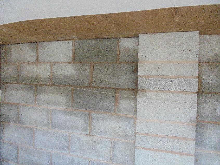

Brickwork and blockwork look sound with no cracks or sign of movement.
Because it's got no cavity it may be getting damp through....which might be solved with a waterproofing treatment (a quality silane /siloxane type, not cheapo Thomson)

@sircerebus666 - My plan is to convert into a proper shed (or maybe even a garage) rather than keeping it open on one side. The previous owners used it as a kennel for their racing dogs hence the odd layout. I will try and get the roof repaired.

How much do you think would the cost be for erecting the 4th side wall (bricks) with a door and maybe a window - Labour and materials?

It doesn't look big enough for a garage, without increasing the short side's dimensions?
You might be able to rebuild the roof to be a half building, half car port?
Then potentially brick it up at a subsequent date?
I don't know what planning rules would apply in that case.
There should be a few bricks wanting some work at the moment?
I don't know if bricks + Labour is cheaper than fitting windows per square metre?

I think its more likely to be a shed based on the size. I will get the roof fixed to begin with and try and fix the existing doors so it can be used. Subsequently get the wall erected with a door as you suggested from Facebook.
