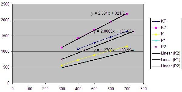

I am trying to tot up the nominal output of my existing radiators. Some are old single or double panel radiators without any convector. I have looked at existing tables for output from single or double panel with one or two convectors and have come up with the following approximations to deal with odd sizes:
single panel, single convector: output = (1.52 x height + 0.120) x length
double panel, single convector: output = (1.9 x height + 0.314) x length
double panel, double convector: output = (2.69 x height + 0.320) x length
output in kW
length and height in m
Does anyone have tables for old single and double panel radiators (no convector)?
Edit: Using Zylo data for finless rads:
single panel: output = (1.27 x height + 0.104) x length
double panel: output = (2 x height + 0.157) x length

I plotted the data for 5 radiator type into Excel and it shows the regression line for 3 of them. You have to admit, they're pretty close. :-)

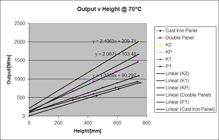

Thanks again for the link. I corrected the tables to a mean temperature of 70°C and plotted them on Excel.
There are three distinct intercept regions for zero height
  • cast iron panel line crosses the Y axis close to zero
    double panel double convector radiator line crosses close to 200 W/m
    all other radiator types have lines that cross close to 100 W/m
To accept that the lines don't have to pass through the origin, I suspect that there are two heat transfer mechanism; a higher rate for a small height (less than 300 mm) then a lower rate for any height above this.
But the regression lines do not pass through zero on the Y axis when X is zero as there is a constant in each formula. I notice you show the regression formula but not the R² value.
