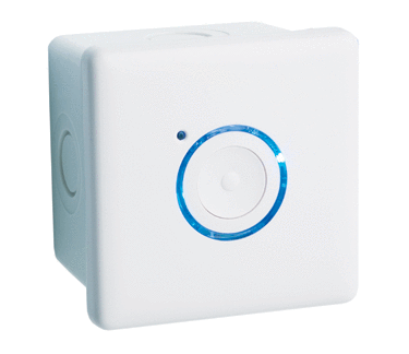

If you were to put one of these switches outside:
https://new.abb.com/low-voltage/pro...witches/outdoor-illuminated-push-button-timer
https://new.abb.com/low-voltage/pro...mers-switches/outdoor-illuminated-touch-timer
then you wouldn't need an FCU, you wouldn't have to remember to switch it on before going outside, you wouldn't have to remember to turn it off when you came back in, and you might find it handy when returning home after dark.
one switch calls for a capacitor for low loads and led's
or the other one says any load...is that for me??
i will have two lamps one 14W led and the other as bought will be 60W halogen which i can replace with an led bulb..
one lamp is at the back of the house just outside the back garage door and the other in the alley way down the side of the garage to the side gate..both on together.
also...is that may be something i could use at the garage entrance instead of a PIR operated light over the garage entrance door??..which i havent bought yet...and winter is here!
chere's
geof
I suspect that the capacitor is needed for the switches which don't use a neutral - there'd be no reason for one if the switch wasn't powered by a trickle of current through the load.
I've got a couple of the 3-wire touch ones controlling some LED lights, no capacitors, no problems.
PIRs are notoriously annoying - coming on when they shouldn't, not coming on when they should, going off when they shouldn't...
If you have somewhere you can put a switch (illuminated, remember), that would always be better, IMO.
