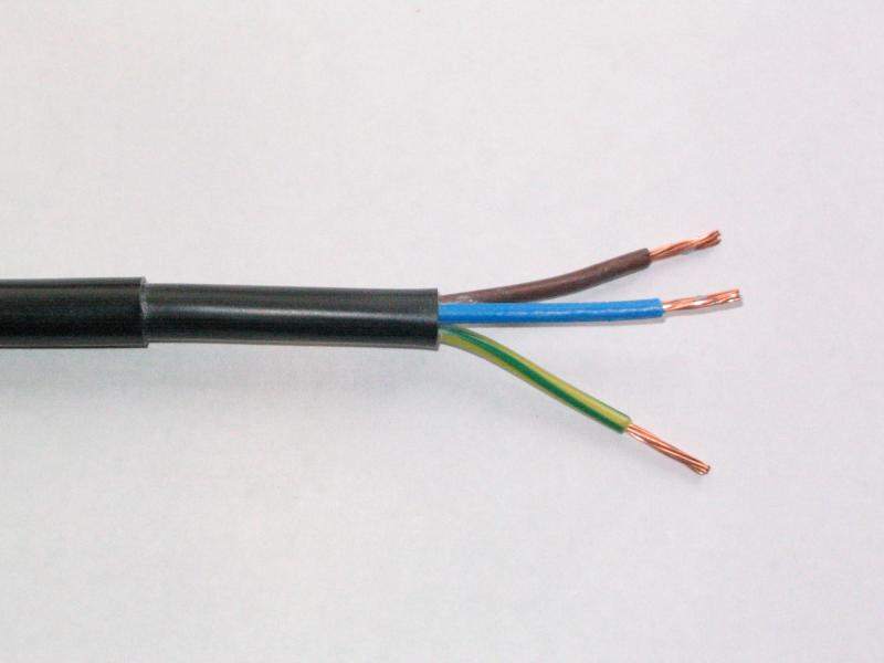

Can i use 1.0mm flex from FCU (5A fuse) to 1st light (running inside house) then use 1.5mm T/E on outside of wall approx' 2.5m from ground for about 3 metres distance?

Standard T/E isn't really suitable for use outside without protection. You could run it in plastic conduit, though it would probably be easier just to use flex.
Gavin
Gary,
yes in general flex is fine outside, though you should always take into account the risk of damage - the position you mention doesn't sound a problem really.
There is a product called HiTuf which has some slighter better protection if you want to do a really nice job - it has an aluminium shield round the cores which offers some protection (though not penetration protection really). SWA would be overkill imo.
In fact, there is an argument after all that T&E would not be a breach of the regs, the 16th OSG even says as much though mentions protection from sunlight because of the UV damage. Personally I would go with HiTuf but flex is perfectly adequate.

apologies - I meant screentuf which I got from my local supplier a while back - I've found it ideal for outside lighting and not that difficult to terminate.
But for a DIYer flex is a better way to go I think.
