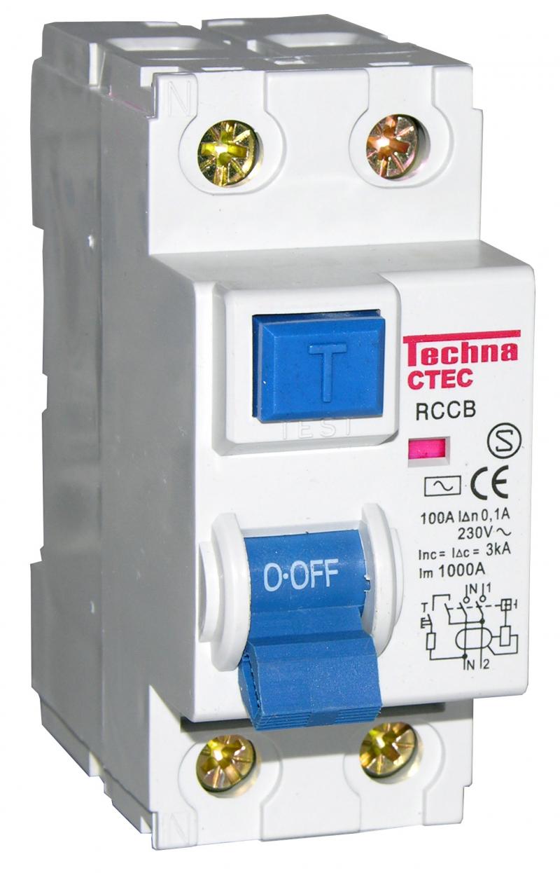

Is it definitely an RCD (rather than an MCB) which both the water feature and lawnmower are tripping? (an RCD will have some sort of 'test button' on it).

I take it the pics are breakers for the in house fuse box?
