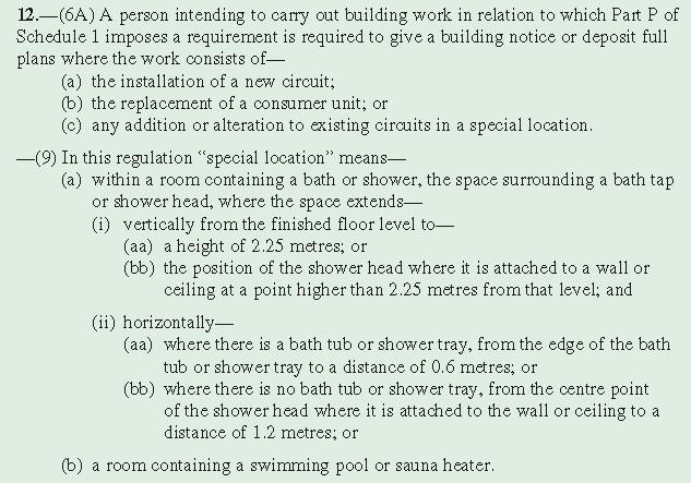

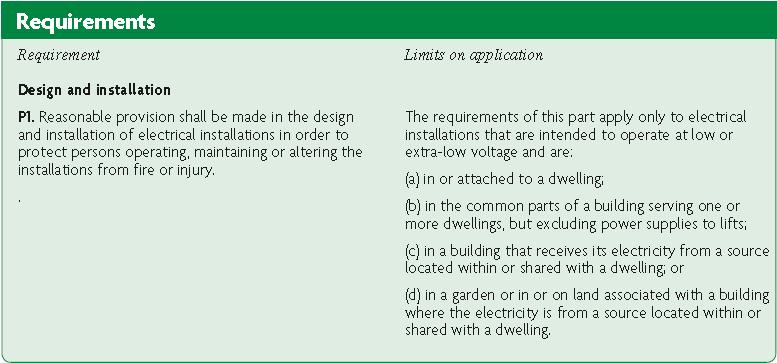

This may have not changed but in real terms to comply with this one needs to follow BS7671 there is very little in the Part P document which guides one as to what is required. In the main the document refers to which areas require one to notify rather than what standards must be met.
The big change is now instead of saying what one is permitted to do without notifying it says what one can't do without notifying. Below is what most people are interested with.
This Part shows what one needs to notify. However I feel the problem is we tend to ignore the other parts of the building regulations. We do talk about socket heights but the rules on fitting an extractor fan seem to be ignored.
I have seen many extractors fitted where there are open flues which is clearly not following the regulations.
I know BS7671 is not law but I feel we need to drop all the references to Part P and instead refer to BS7671 which following will make the home safe.
Returning to Flasho's question the main thing is if a new circuit is being formed. If he is going to add a MCB or RCBO then he will be forming a new circuit. If not then he is only adding to an existing. It would seem the latter is the case so no need to notify.
