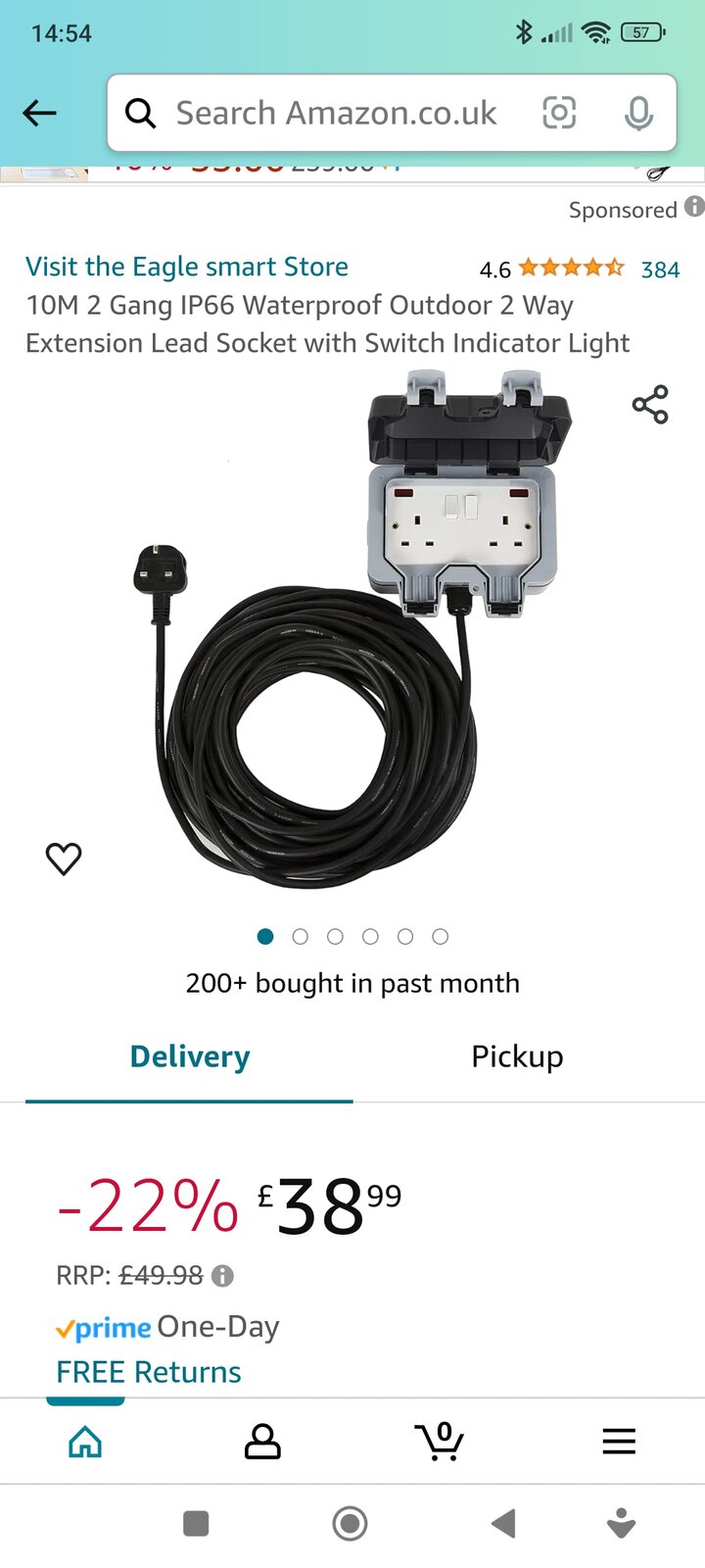

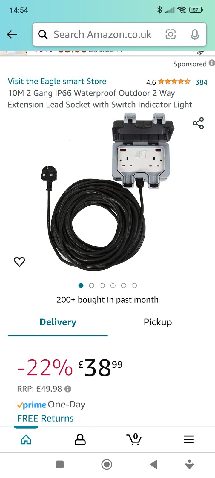

I've just found this on Amazon, what is your opinion on these type of sockets?

At first glance it looks like it might be OK, dependant upon the actual make of course.
You would need to protect the flex against mechanical damage which might mean by placing it sensibly out of reach somewhere.
As it`s effectively a "temporary extension lead" then most of the points I mentioned will not need addressing ,

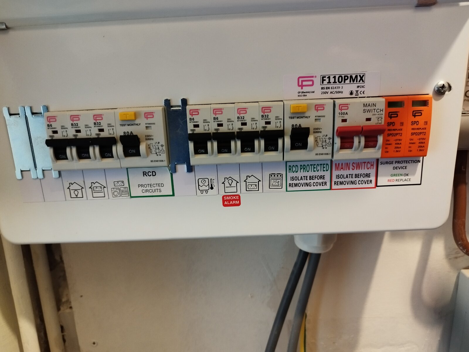

Youyr circuits all seem to be RCD-protected, so thats one issue out of the way.
As ebee mentioned, the item that you have shown is basically and extension lead, rather than installing a more permanent socket that might be hardwired to one of the inside sockets.
One thing to look out for is that many outside sockets will only close (to make them water-resistant) if a standard plug is inserted. If you are thinking of plugging in one of those integrated plug and power-supplies (aka wall-wart) that come with outside lights, then you'll find that you wont be able to close the front flap!
