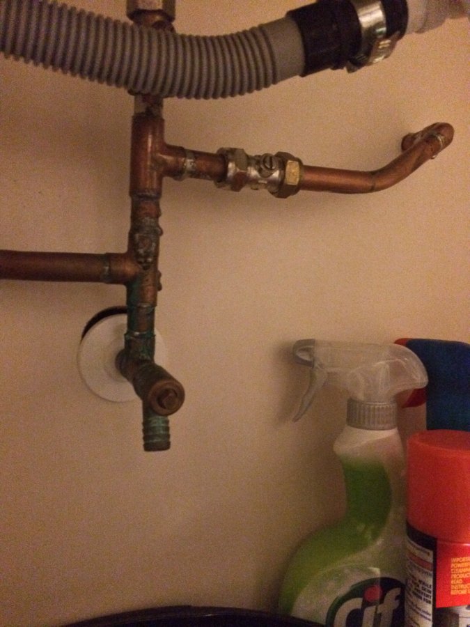

Just a quick question about an outside tap I've just had fitted. I'm worried about issues in the winter - the tap is above the pipe leading out, so when I turn off the isolation valve and open the tap...no water comes out, so essentially water is still going be trapped in there over the winter... is this going to be okay? should we not have a drain valve or something under the sink? (I've taken a pic and attached it of the set up)

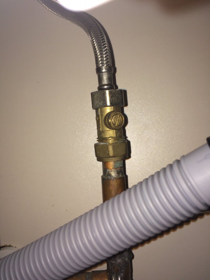

Also please check the first photo I have attached, does the connection look okay on the pipe? I'm only asking as you can see quite a bit of the thread below the nut/valve! Does it need tightening or should it be ok?

Yes, the connection is ok, as long as there is no weeping from the joint.
Turn the water off and use the drain cock to empty the pipe, then close the isolator to the outside tap and turn the water back on. Or turn the isolator off and leave the outside tap open so if it freezes it has somewhere to expand to.
So it doesn't matter that it's not screwed up fully?

No because there is an olive inside the nut preventing it from being screwed up completely. If tightened too much, the olive will split and then you would have a leak.

Do you think the set up is okay? Is there anything I should get added/done? And how would I drain the drain cock?

Evan, you need to ensure that there is a double check valve protecting the outside tap, best practice dictates that it should be on the pipe inside, after the isolation valve. I'd check with whoever installed the tap to confirm the tap has backflow protection or take a picture of the outside tap and post it and you will be advised.
If you google draincock/tap, that should show you how to use them, though if you're not sure, I always recommend you get a professional to show you how to use it correctly. You don't drain the drain cock, you drain the pipework via the draincock
