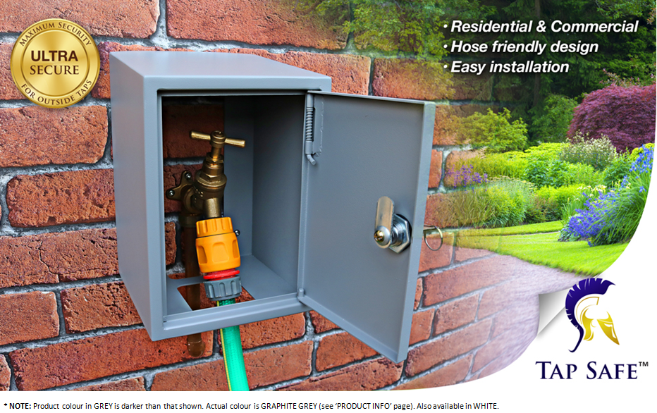

Ideally I'd like a tap or water access at front of our house for washing cars on the drive.
I've seen the Tap Safe boxes but is there any alternatives. I'd like whatever we fit to be secure really just in case some numpty decides to turn it on for a prank.
Plumbing wise it's not an issue just finding a suitable enclosure really.
Any suggestions appreciated.
Was looking at these but can't get hold of one at the moment.
What's difference between having a tap at back of house vs front water regs wise out of interest?.
I might have to find a suitable metal enclosure and modify it (probably what Tap Safe have done).
Maybe an electronic stop valve feeding it?.
