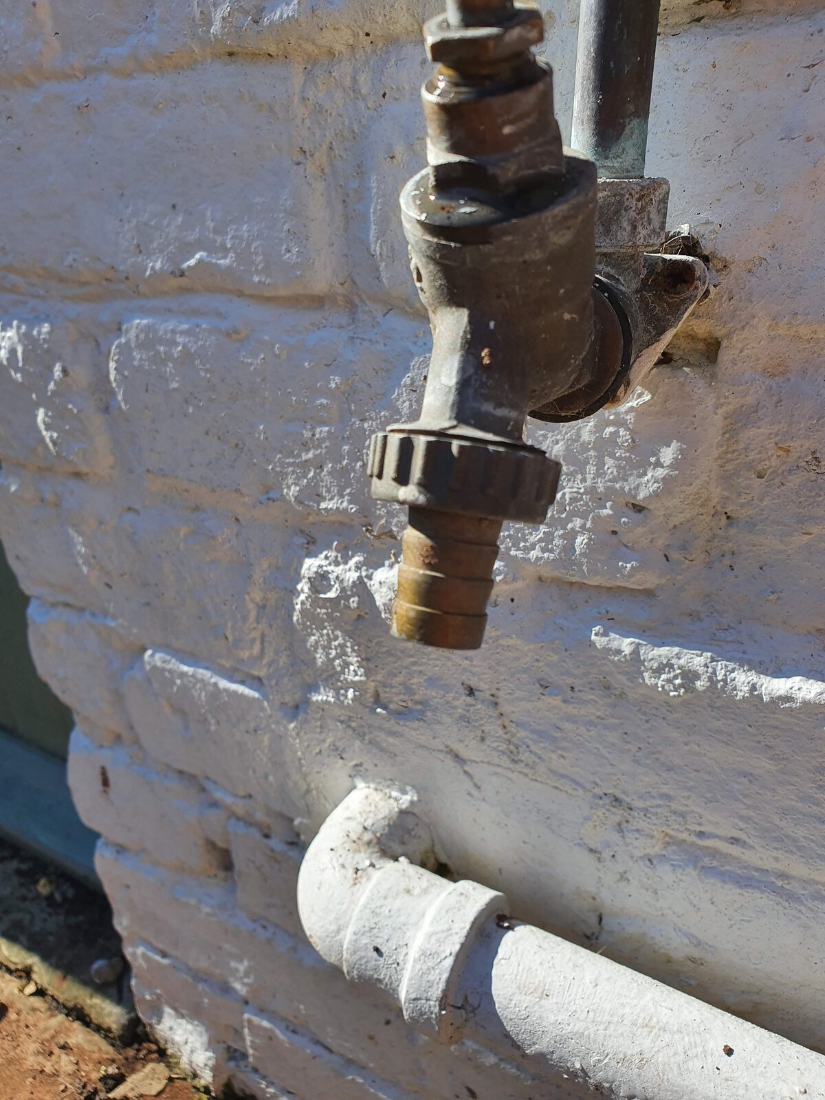

Before I take the plunge and get a new garden hose - can anyone tell me what kind of fitment I need for this type of tap? I inherited an old hose that was jemmied on and fixed with a jubilee clip and would like something more long-term.
Thanks in advance.
It's a standard 1/2" bibcock - Hozelock et all do fittings that screw on direct, or you can fix a small length of garden hose on and secure it with a jubilee clip as before.....and then Hozelock to that.
