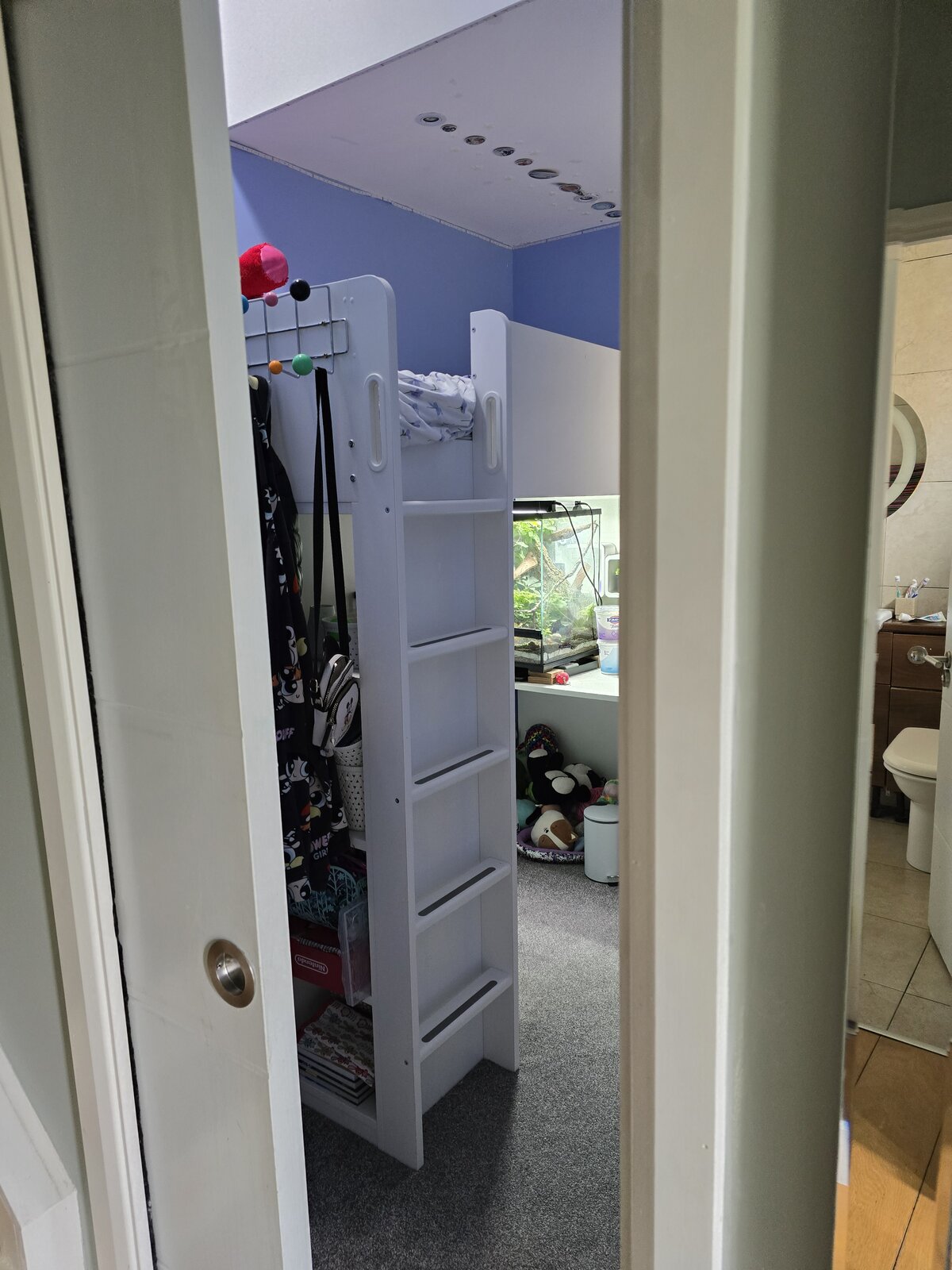

Door do take up alot of space. Hence why I fitted pocket doors when creating an new shower and 3rd bedroom.
