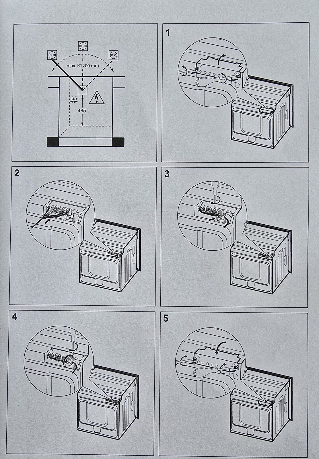

We have been doing some renovation work on our kitchen.
We have a new electric oven and a new induction hob.
Both are 6mm wired and share the same junction box via a 32amp mcb.....

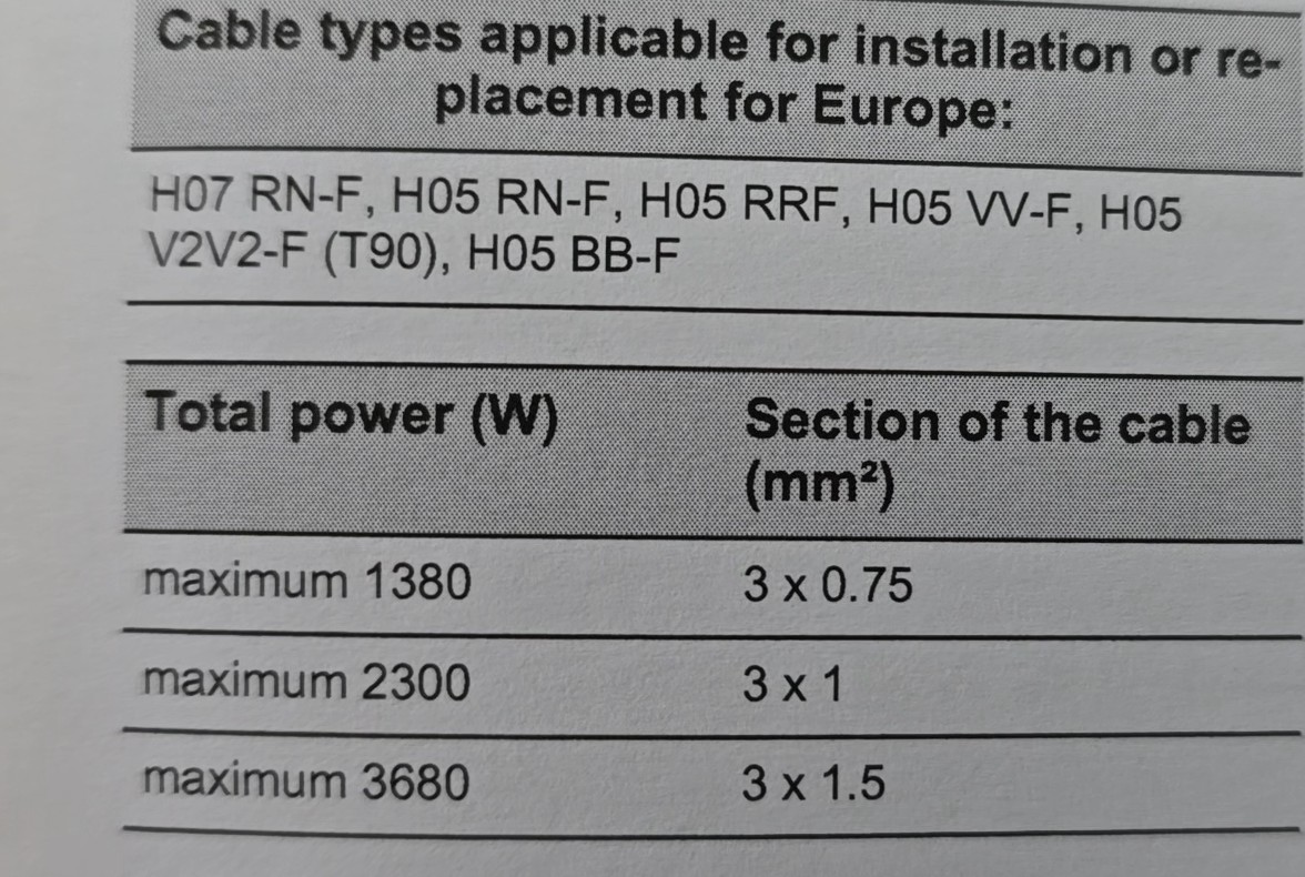

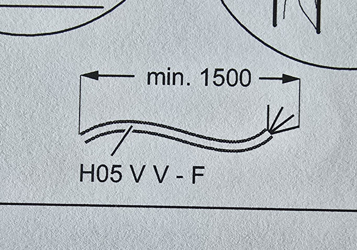

The oven is 3200w or 16amp.
The hob is 2.3kw -3.2kw.
Both are connected to a 45amp dual conection plate that 6mm wire runs up into the ceiling and then into a 30amp round junction box that the original oven was wired to...
When i turned on the 32amp fuse the system tripped......
Would the hob and the oven require seperate circuits to work.....
