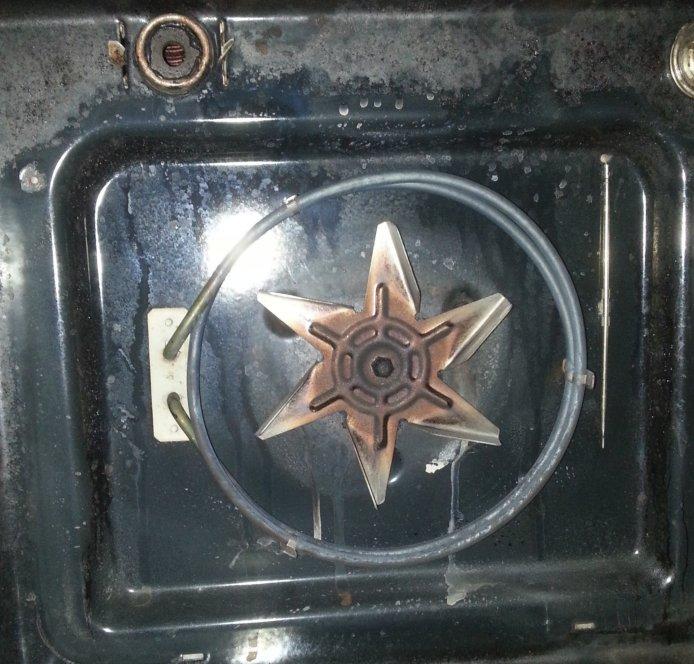

Hi there, today our oven was on when the electric tripped. When reset the oven would not heat up, the thermostat light stayed on although the fan worked. Classic signs of a failed element I believe. When I removed the back plate there are no visible signs of the element failing, it looks in reasonable condition. I have not removed it as it looks like the screws into its mounting plate come in from the back of the oven so I will have to get it out.
The only thing that concerns me slightly is that I read somewhere that an element failing could actually be caused by a faulty fan motor. Now for some time our fan has taken about 10 minutes to fire up once the oven has been turned on, I'm sure it used to come on straightaway - should it come on straightaway? Once it starts up its ok so I'm wondering if this is just a red herring. It looks a little brown but rotates easily enough. Ironically now the element is broken the fan does come on straightaway.
Any advice greatfully received.
Thanks.

Thanks for people's advice. I do find it odd that the fan now comes on immediately, now that the element is not working, whereas it used to take about 10 minutes to come on. A bit like a chicken and egg situation - was the fan coming on late caused by the element being faulty and gradually deteriorating, or was the element failing caused by the faulty fan (which now seems to work ok).
I'll try and go through some of the tests mentioned, although I'm tempted to just replace the element for now and see if the fan still comes on immediately.
FWIW here is a pic I took last night which as mentioned shows the element in what I would call reasonable condition ie no obvious failings, whilst the fan blades look a little bit dirty.

Anyway, if the fan is running, you need a new element. It's not worth trying to test the old one unless you have an IR tester - as EFLI said you could check it with a multimeter, which might show a fault but won't confirm that it's OK.
