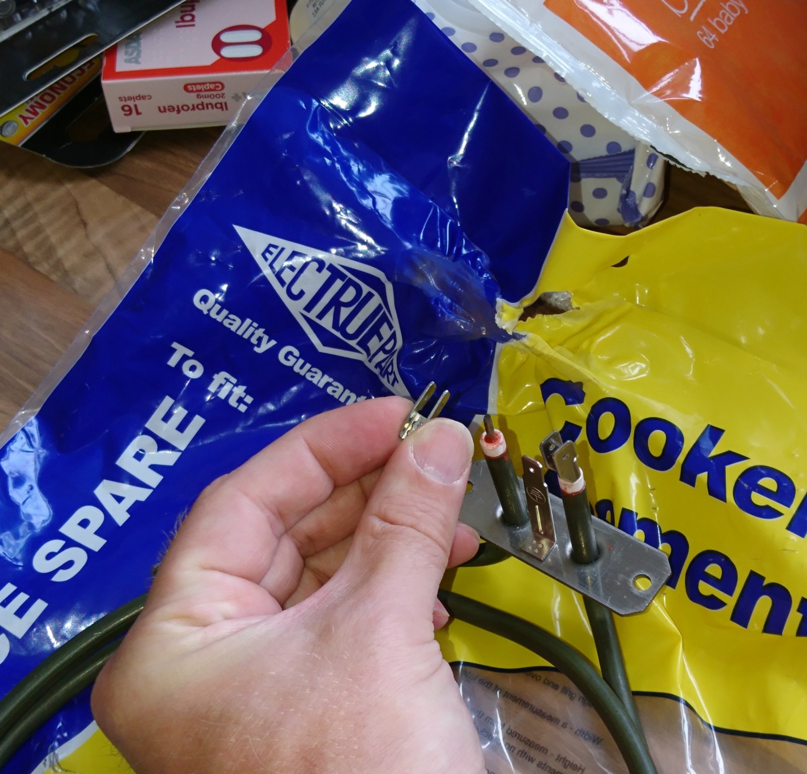

Hi... I have just set about replacing the element in my oven Indesit is60c1(x) and ordered a new element online. When got the new element I notice the original has different spade connectors to the new. The original has 3 x single spade connectors but the new has 2 x double spade and 1 x single. Does anyone know if this can still be used but connecting the single spade to one of the prongs of the double connector..?

Did it just come off the round 'pin' of the element?
If so, can you not make the spade fit or get one that fits.
Also, if it did I would be suspicious of the other one.
Perhaps buy a different make and get your money back for that one.
The double spade part of the element broke off the end of the element as per photo below
In which case ask for a replacement. If the connection blades broke off from the element that easily then the mechanical joint was too weak and the electrical connection ( blade to element ) would be likely fail very soon.
