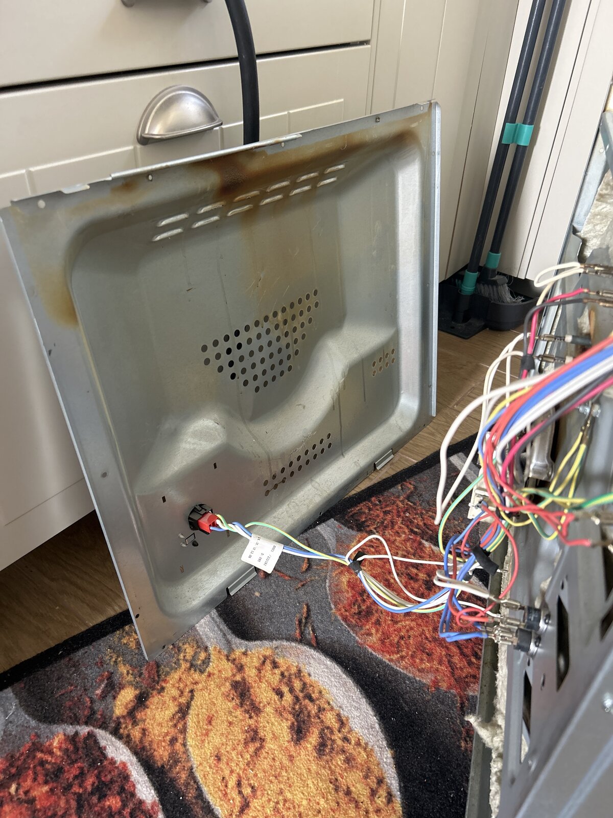

Hi,
Had an issue recently where rcd would randomly trip, this was eventually narrowed down to a faulty rcd. Once the rcd was replaced i found out the random trips were down to the oven, now the rcd trips immediately as soon as oven is connected up to the mains and switched on. The weird thing is, if i remove the back housing of the oven and turn it on, oven works fine ( L N and earth still connected. Pic attached of housing. Hoping someone can offer any suggestions as to what issue could be.
Perhaps the back being connected to the rest of the oven and the fault.
Probably if you put the oven in the back yard, it will also stop causing trips.
Yes, the rcd was faulty as it was tripping intermittently so i could not locate the faulty appliance, once it was replaced of course the faulty appliance ( oven ) became known. Have tested all the elements with a meter and they are fine

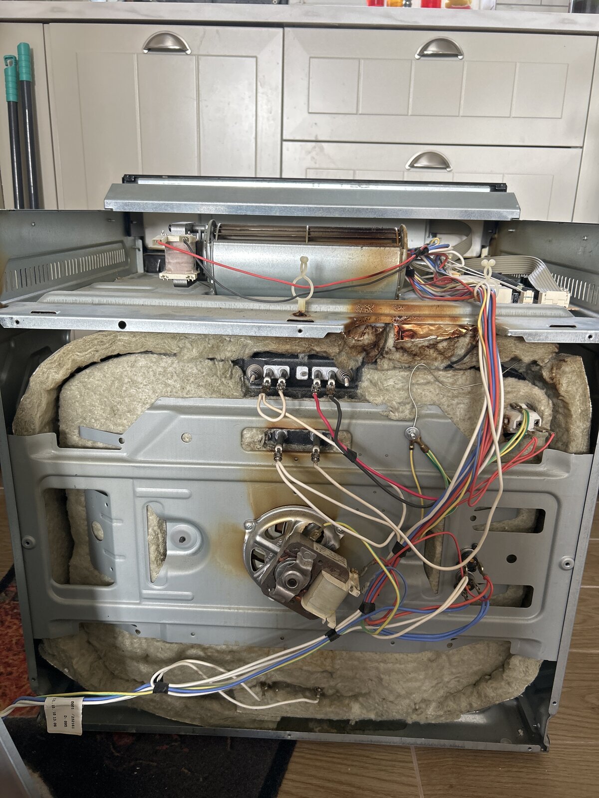

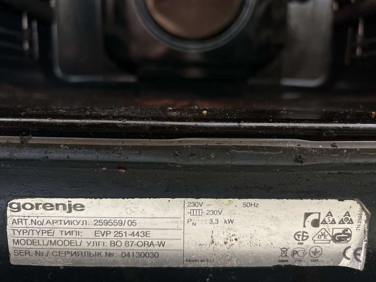

Make and model may help you get an answer. I once had a strange RCD tripping fault on a Bosch oven where the pins on the rear of the suppressor ( a small pcb inside that the mains cable connects to ) were shorting to the frame only when the oven warmed up. So perhaps fitting the rear cover is distorting another part of the body of the oven is causing a short to earth on yours. Also a better pic of the rear of the oven might help, can't really see anything form the one you posted.
thankyou for your help. Have attached pics with model and rear.

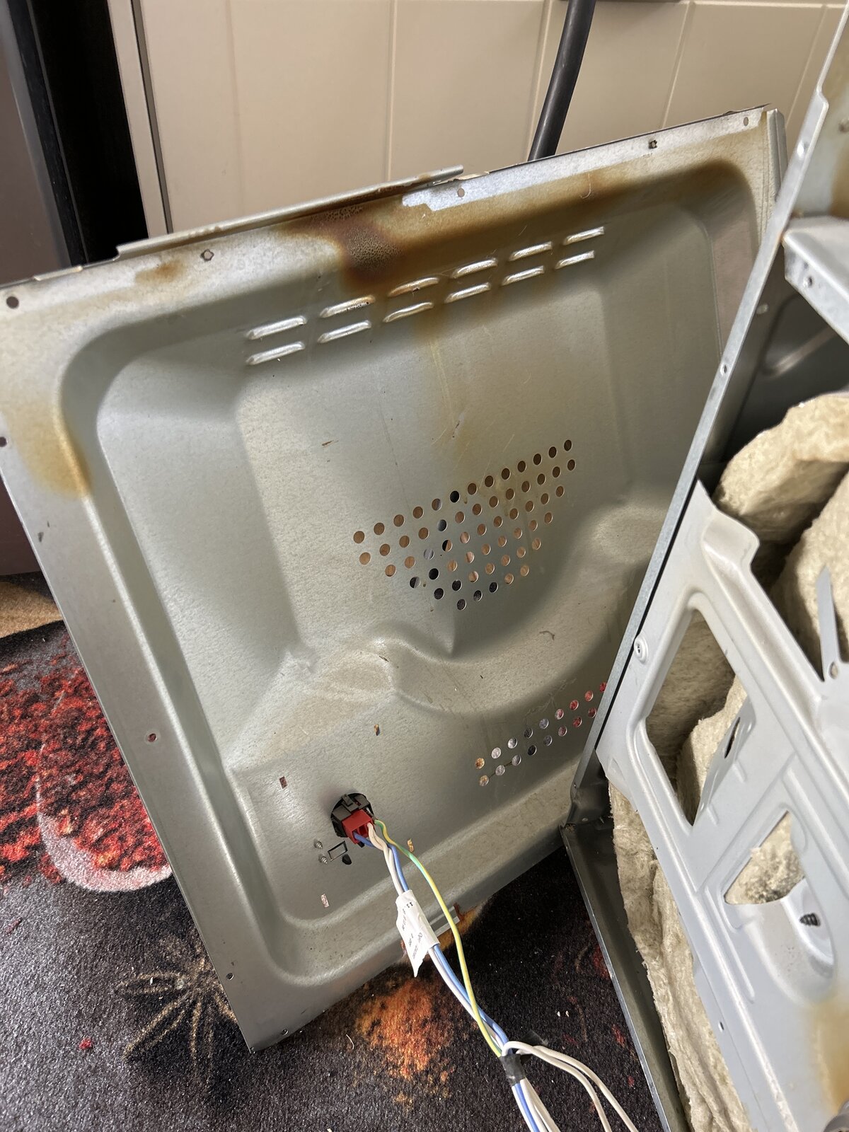

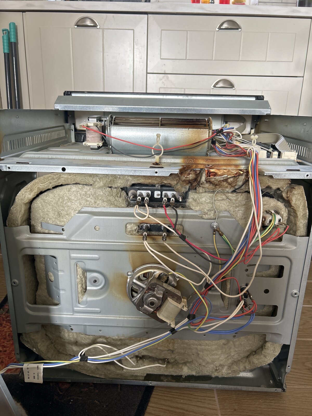

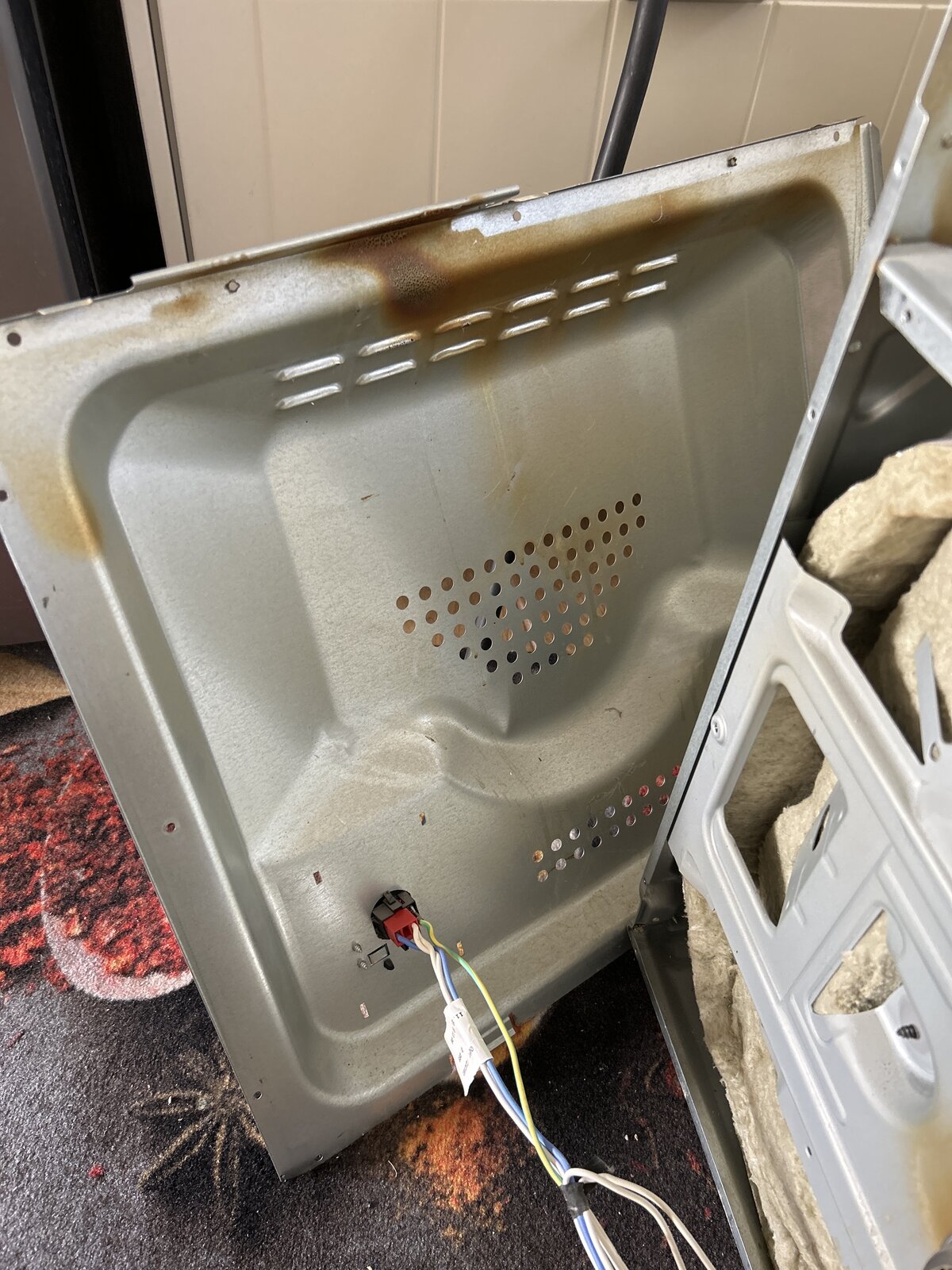

hmm, seems the earth wire was connected to the same terminal as the neutral wire on the housing connection, once i moved the earth wire down and connected it to the earth terminal, that seems to have solved the problem. Not sure why the manufacturer would have connected the neutral and earth to the same terminal in the first place.
If the neutral and earth were connected together, the RCD ought to have been 'permanently tripped' - at least, if anything else significant in the house was 'turned on'.
.... Not sure why the manufacturer would have connected the neutral and earth to the same terminal in the first place.
See above - they wouldn't have done that. How long have you had this oven, and was it previously working OK without tripping the RCD?
