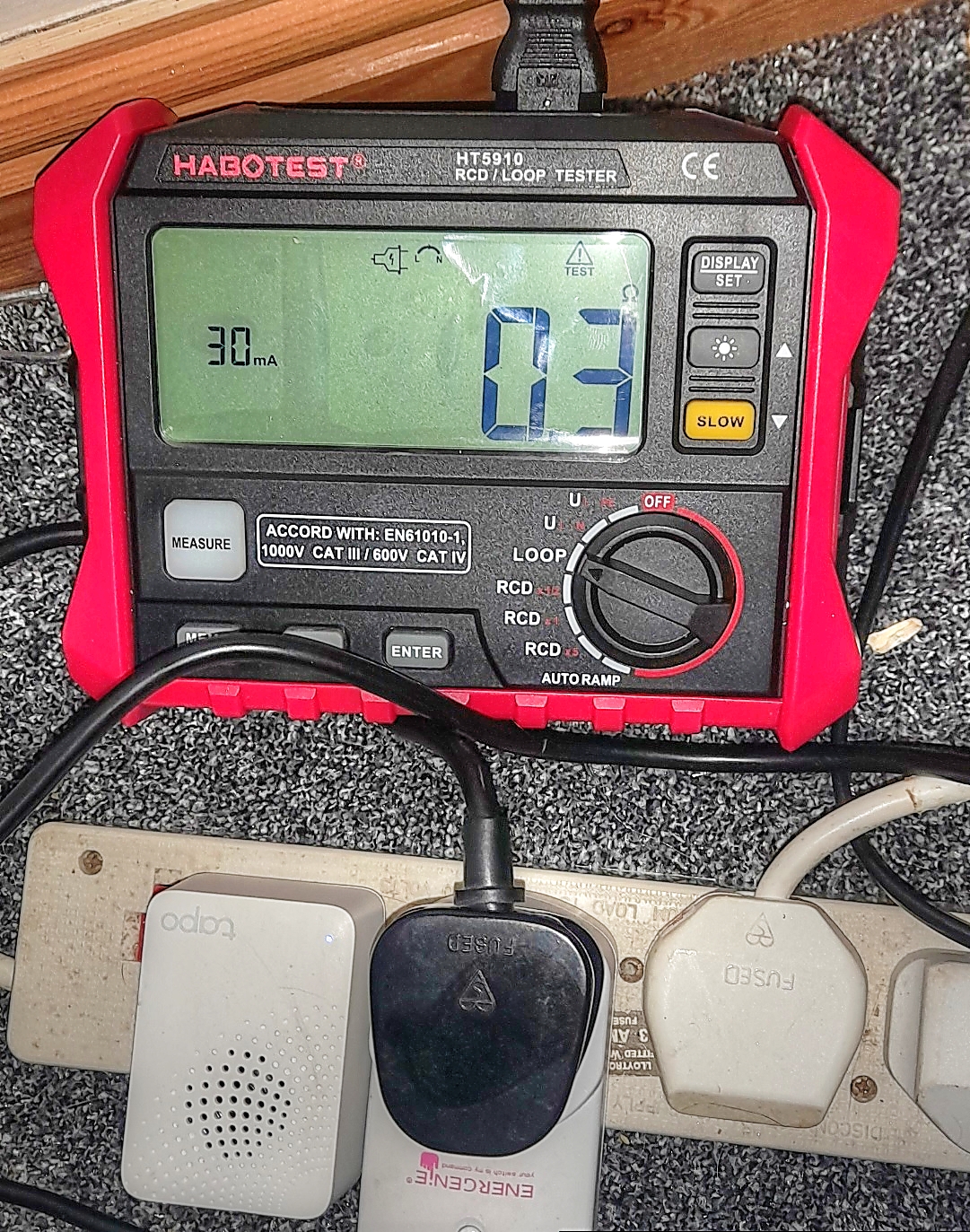

One can of course test the RCD, here shown doing a loop test, Loop-test.jpg but the same meter will test an RCD, it can use fixed leakage, or a ramp test, the latter will show at what extra leakage the RCD will trip, and it also measures the time taken to trip, can't really measure 40 mS with a stop watch.
But the problem is the cost of the meters, the three meters shown can easily cost £250, and even to hire, because they need recalibrating after each hire, can cost £60 just to hire.
