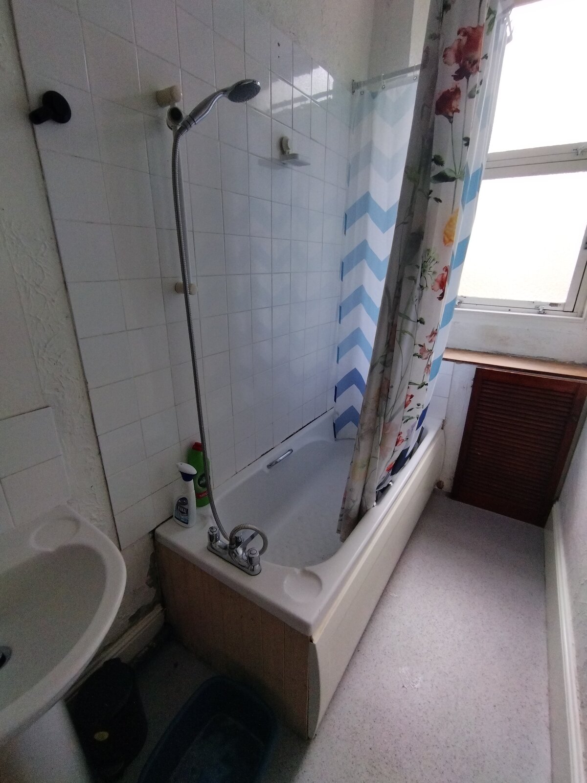

This set-up has caused a lot of damage to the floor due to the way the shower has been used. When the curtain is wrapped all the way around the bath, it gets in the way of the tap controls and so the shower is used without the curtain in the right place and water splashes onto the floor at the tap end of the bath.
What are the best design options for this case? I thought I could get a bath screen for the tap end of the bath but the only one I can find that is 685 mm wide (the width of the bath) is just 1300 mm high which seems very short and so water will just spray over the top. And in fact all bath screens seem to be only 1400 mm, which seems way too short to me. I think my best option it to fit a bar mixer in the tiled wall? That way I can keep this nice and high curtain.

Is there a perpendicular wall to the left of the basin where the door is?? If so then swap the basin and bath positions. Put the bath up the other end where you then have a wall to mount a proper bath mounted shower screen. Either that or lose the bath and put in tray.
A shower on the bath as it currently sits will never be right and will probably always cause problems. I've never seen one like that work properly long term if the shower is used regularly.

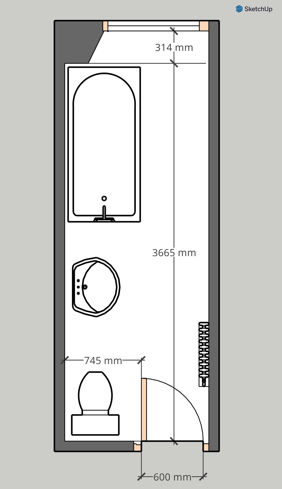

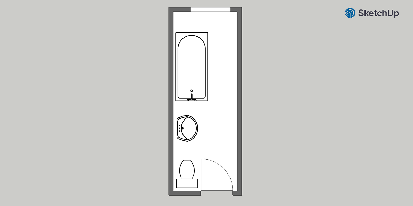

Thanks, Madrab. Actually, there's a toilet to the left of the basin (as viewed from the angle the picture was taken from), and then there's a perpendicular wall which forms the end of the room (and has the doorway). I don't know if there's anything plumbing wise that would prevent me from moving the toilet.
My other idea was to put a bar mixer on the tiled wall, and then use a fixed 400mm wide wet room glass panel for the tricky corner area of the bath and also keep the shower curtain as well. The thinking being that 400mm is enough to compensate for when the shower curtain is not pulled right into the corner.
Edit: I'll need to check but it might not be possible to move the bath to the corner due to the door.
1300 plus depth of the bath (500 ish at the tap end) would give 1800 which will catch the worst of it, especially if you put a return screen on as well (so you have an L shape at the tap end)- this is putting your screens on top of the bath rather than on the floor. Understandable design (loll in the bath with your head as far away from the loo as possible) but the curtain was never going to cut it.
The ultimate folly here is not having a wall at the head of the bath. The what width do you have on the wall with the door in it? That will be the deciding factor. Looking at the width of the bath and space to the right, unless the door is in the middle of the wall then you may find you have just enough width. Very similar narrow bathroom to a lot of Glasgow tenement flats.
The other alternative is one we did years ago with the same scenario, we got that one to work by building a glass brick wall at the head of the bath.

If you're lucky you will have 700mm between the corner and the door frame, don't worry about the door facing/trim as that can be cut back.

Looks like there would be just enough room to move the bath to the back wall.
The redesign would make the entrance feel a bit restricted as the (narrow) door would only open to around 90 degrees (and the radiator would need to be moved).
Yes .... though there are countless bathrooms designed exactly like that and it takes care of the whole issue surrounding the bath shower and allows for a proper screen mounting and making it all watertight
If you want to keep the bath that is, any other solution unless you construct a wall at the head of the bath (i.e. glass wall) will always cause problems with a shower.
