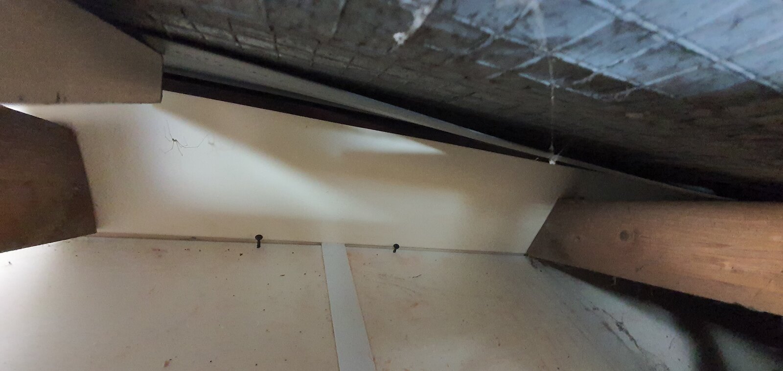

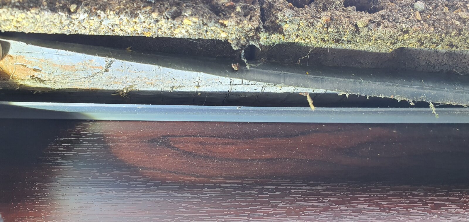

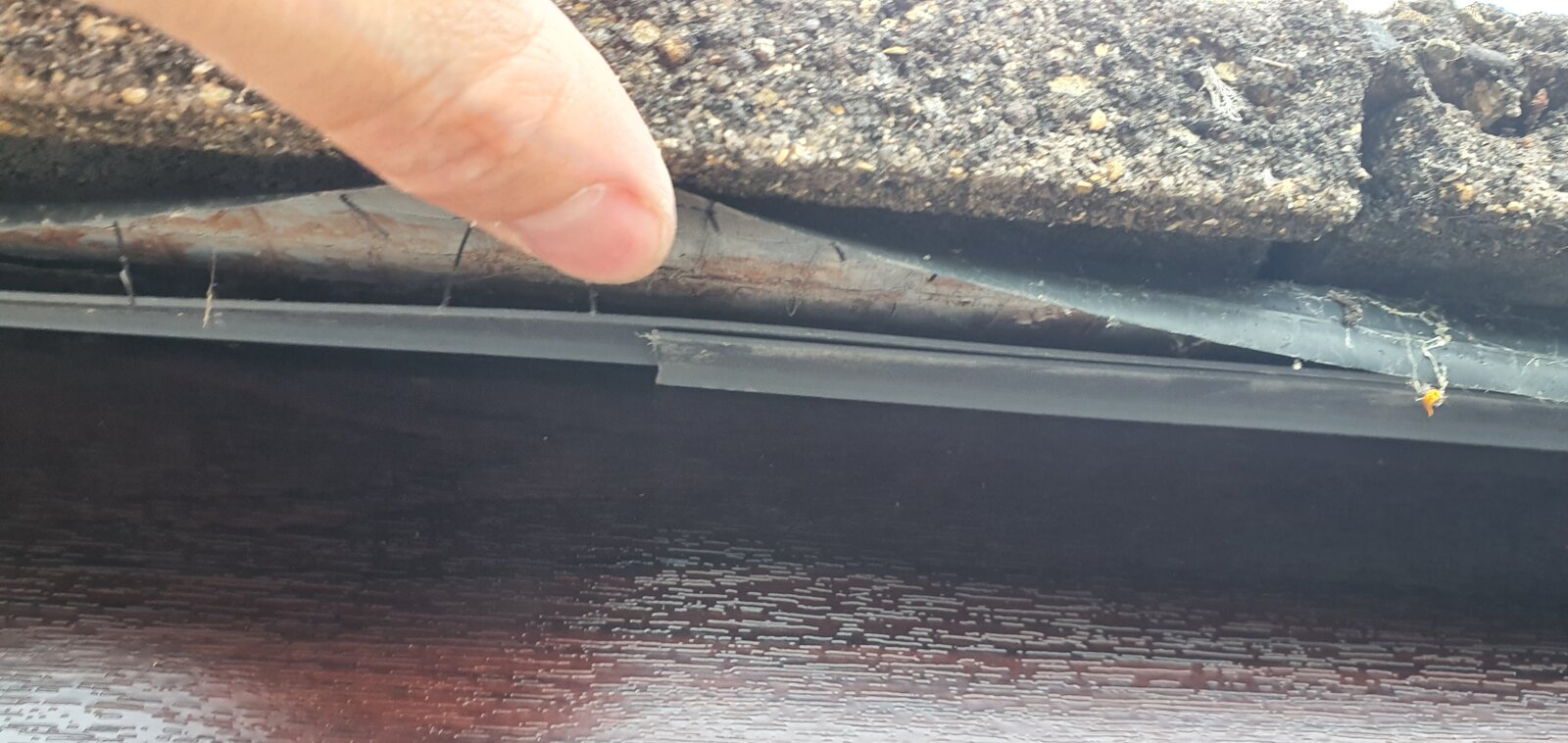

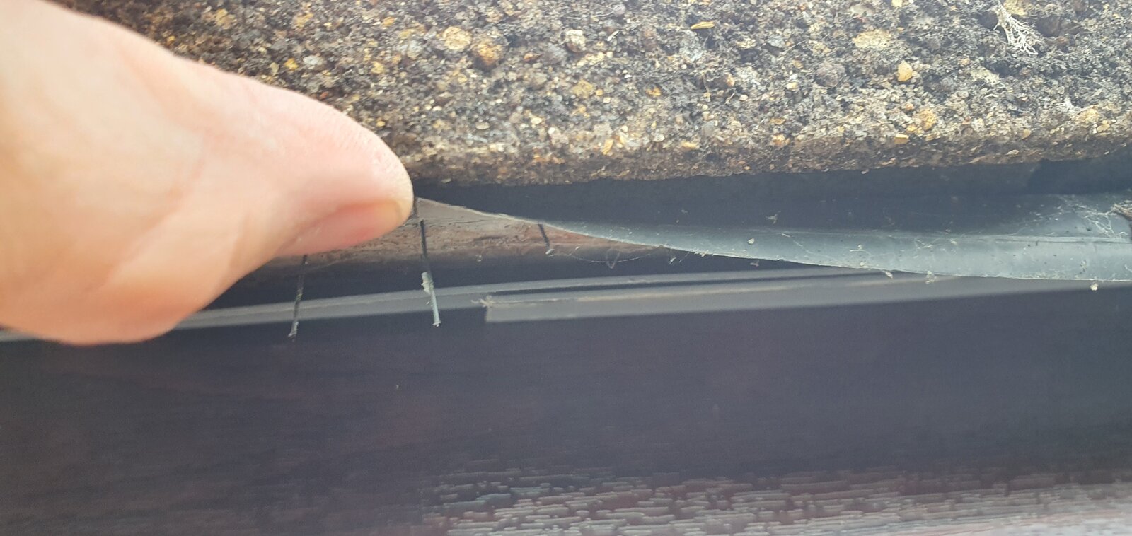

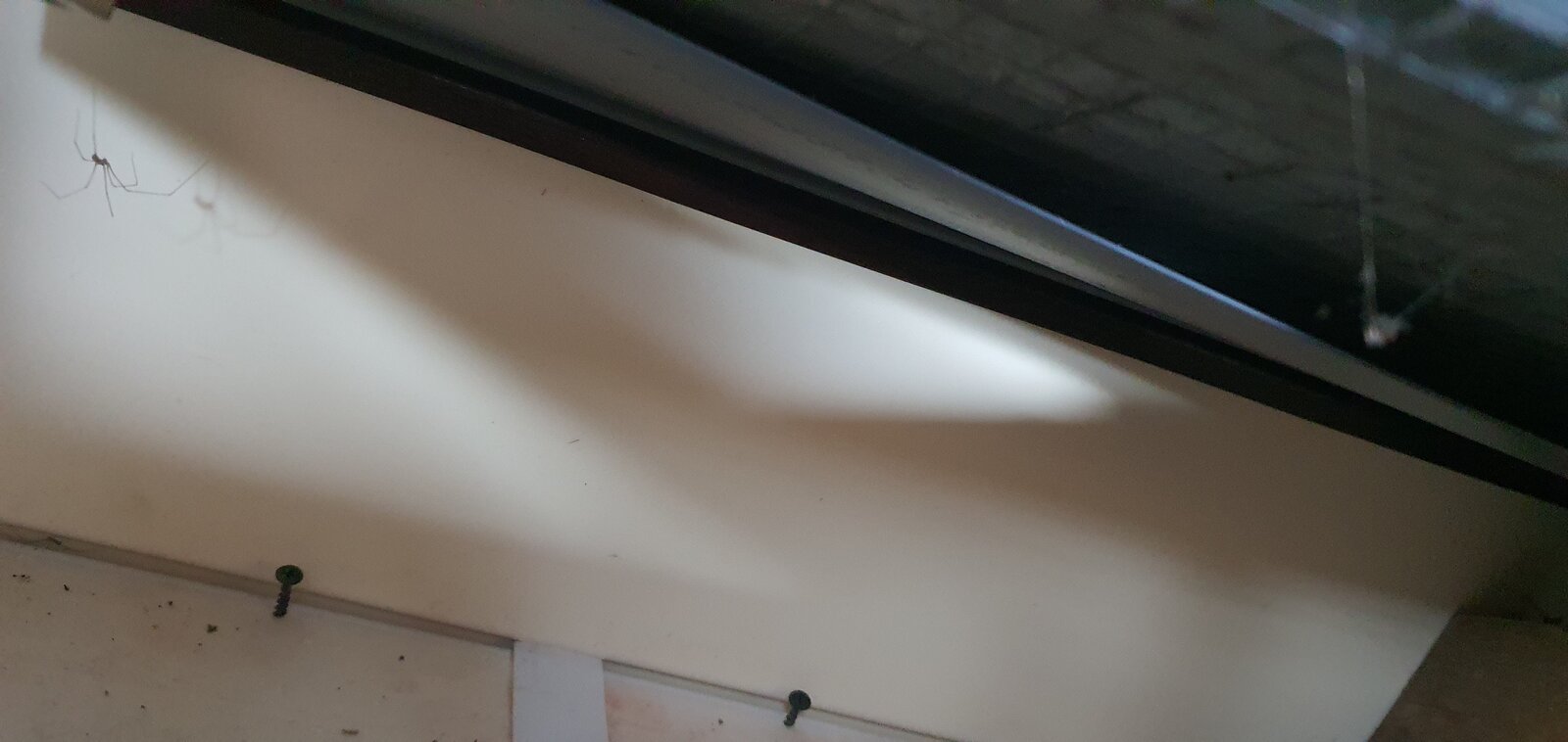

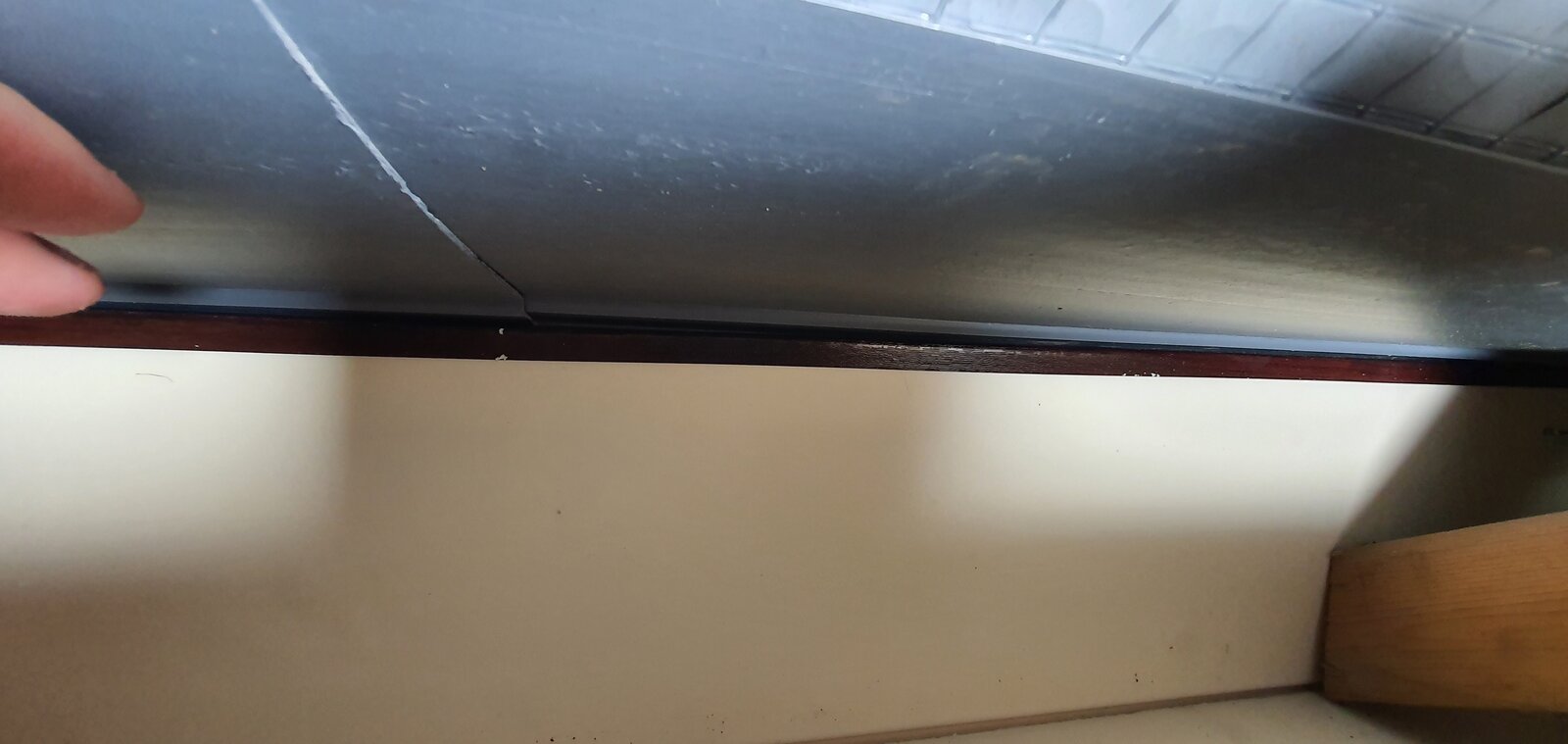

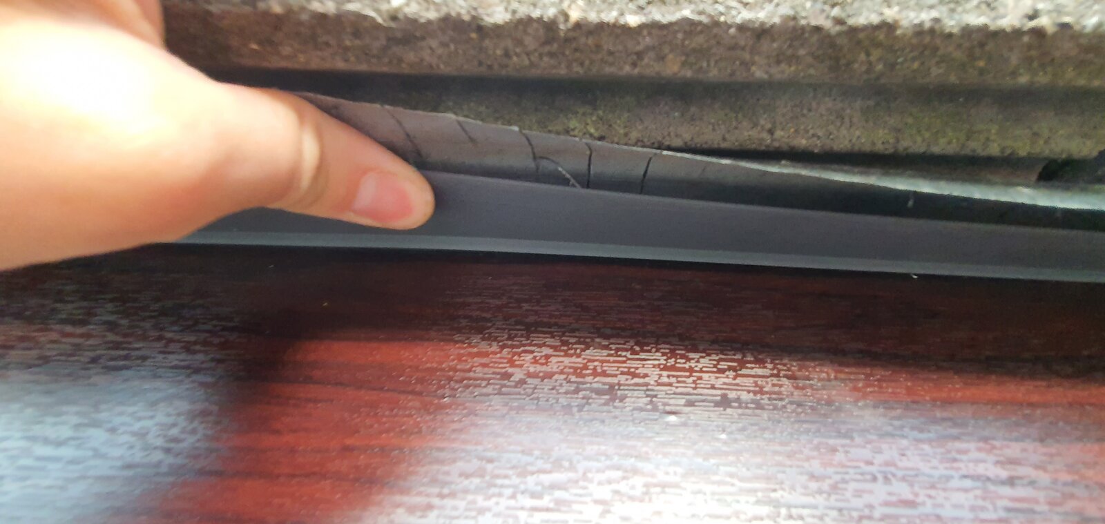

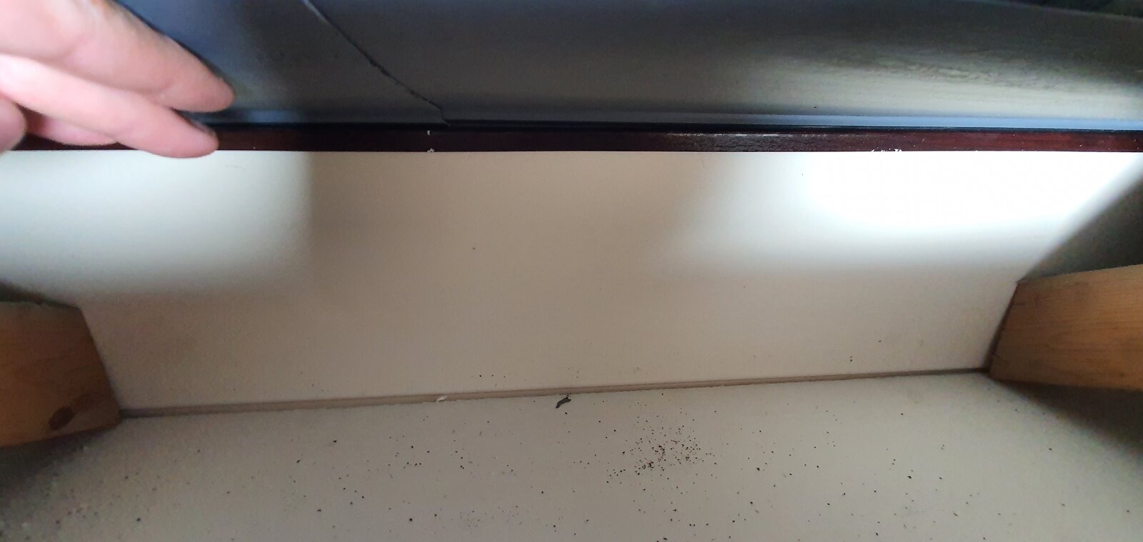

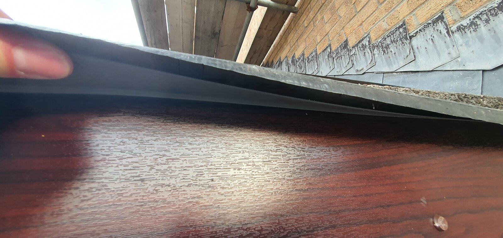

Hi,
We have just had new fascia and soffits installed and we asked for over fascia ventilation, I was boarding the loft out last 2 days and noticed there is zero airflow even with a breeze outside.
Used a smoke machine, and couldn't see any smoke exit, that I could see anyway.
I wouldn't normally question if it was installed correctly. However we have had lots of problems, so wanted to check it was indeed installed correctly as I cant see any vents.
Video
Any advice is greatly appreciated.

As above, underlay support trays , no ofv. They would have been clearly visible
And you wouldn't need to get that close either as you would see daylight as well as a breeze!
Thank you for your replies, I can't understand why its not been fitted... makes no sense.
Now the fun job of bringing yet another problem up.
Sorry. I mean Idle installer , couldn’t be bothered to fit them on fascia ....
